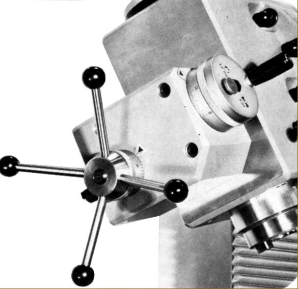

Vertical Swivelling Head for the WF2 Part No. 11.01. With 63 mm of quill travel under the control of a detachable handle, this unit has 12 speeds from 50 to 2240 r.p.m.
Vertical Swivelling Head for the WF3 Part No. 11.10. With 100 mm of quill travel under the control of a capstan handwheel, this unit had 12 speeds from 50 to 2240 r.p.m.
Part No. 11.11 Manual fine-feed attachment. Intended for mounting on the vertical milling head part No. 11.10, this assembly gave a very fine feed rate for use when boring. One turn of the micrometer dial gave 4 mm of linier movement.

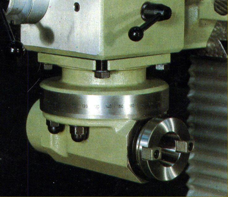

Part No. 60.01 and 60.15 Adjustable Multi-angle Milling Head. Able to be swivelled through 360° vertically, it could be angled though 180° horizontally and contained heavy-duty gearing made from hardened and ground materials.
Art No. 60.20 and 60.25 Right-angle milling head

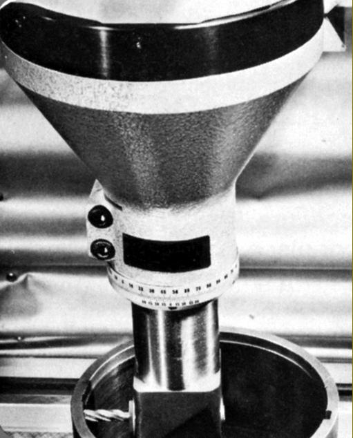

Precision High-speed Spindle. This attached unit, with step-up gearing of 6:1 gave (depending upon the exact model) a maximum speeds of either 9,000 or 10,000 r.p.m.
