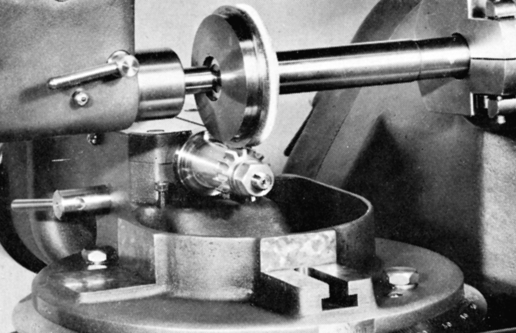

Continued: Further development by Mikron for the 102 was 'continuous indexing', a process by which bevel gears were produced using fly cutters - this being subject to further improvement and re-named the "Conikron Method". This system involved machining the profile of a gear by a cutter having seven successive teeth - the first and last tooth developing the accurate profile while the ones in between acted to rough the shape and cut the root of the teeth. Advantages claimed for the method included an increased tooth depth (by 1/3 the cone length compared to 1/5 by the former), thus giving a longer meshing surface; the roughing teeth gave a slight increase in productivity while a better surface finish was achieved and the parts - due to ground profile cutters - were made to a higher standard of accuracy. As well as newer models being able to employ the system, older models such as the 120 could also use it. Of considerably greater capacity than the other popular, small Mikron hobber, the Type 79, the largest gear that the Type 102.02 could cut was 4.75" (120 mm) in diameter with a length of 5.125" (130 mm). Numbers of teeth from 6 to 325 could be accommodated (though numbers below and above this could also be arranged) while the maximum pitch was 12 D.P. (2 Module). The thirteen feed rates spanned 0.05 to 3 mm ( the earlier 102 had 7 spanning 0.05 to 0.6 mm) with cutter speeds ranging from 140 to 1870 r.p.m. Spiral pitches ranged from 3/32" to 196" (2 to 5000 mm) with the pitch angle of spirals, left or right-handed, being from ) to 0 to 89°. A wide range of accessories was offered, including: a Multi-program control (Part 164.30.20.00/0) that provided an automatic sequence of four operations and a return to their starting points; once set up, all the operator had to do was load and unload the jobs. Equipment for Cutting Large Gears (Part 30.23.00/0) consisting of a cutter support with the cutter shaft mounted at a lower level for producing large diameter gears in the range 4" to 7 7/8; Cutting Internal Threads (Part 30.22.00/0 This was a cutter support with the cutter shaft mounted at a higher level and designed to take cutters with a special mounting shank that enabled multi-start threads of great accuracy to be generated. Precision Bevel Gear Cutting Attachment (Part 30.70.00/0). This unit was intended for the economic production in small to medium-sized production runs of spur and spiral-bevel gears. For bevel gears the attachment replaced the tailstock support and its overarm with the normal cutter support remaining in place. By using a centring microscope, the cutter could be adjusted accurately to the centre axis of the job with deburring taking place automatically as the work progressed. Special Worm Wheel Cutting Device (Part 30.80.00/0). This attachment enabled worm wheels to be cut using the automatic tangent feed. During the machining process, the cutter height did not need to be changed or adjusted, the cutter having the same form as the worn into which the wheel being cut was intended to engage. The teeth of the worm wheel were cut out across the entire arc in a constant width - the tooth width being neither cut short nor of an incorrect form. Pneumatic Clamping Device (Part 30.58.00/0) Like the pneumatic tailstock attachment for the Mikron Type 79, this attachment was intended to speed up the mounting and dismounting of jobs. The clamping pressure was adjustable to each job and the accessory could be fitted by a user himself to older machines - though the factory recommended that it was supplied ready installed. Microscope Centring Device. This accessory was made up of three parts, the microscope with a holder (Part 23.54.00/0), a centre with a collet shaft (Part 103.91.35/500) and a cutter centring pad (Part 30.21.50/0). Rapid Clamping Lever (Part 30.43.00/0) When using collets this device - identical in function to those used on the maker's precision plain-turning lathes - opened and closed the collets very much faster than the hand-screw method. Device for Cutting Single Start Threads on the Type 102.05. This attachment enabled the gear hobber to generate threads in a single operation, the root, flank and crest all being formed simultaneously. The method was claimed to give improved pitch accuracy and a fine surface finish. While a high-class machine was essential for the production of accurate gears, good quality hobs were equally important and Mikron offered a wide range including ones for involute teeth with both ground and unground profiles; for spur and spiral wheels; for worms and the the matching worm wheels; ones for epicycloidal teeth suitable for the watch and clock industries; hobs for splined shaft; setting cutters for ratchet wheels and thread and bevel gear cutters--and special teeth to a customer's requirement For the Type 102, hobs were available for any profile desired with pitches from 12 to 800 D.P. and for involute tooth forms ground hobs with pitches down to 200 D.P. For tooth forms that could not be generated, Mikron supplied a range of fly cutters. Standard hobs were made in diameters of 12, 14, 16, 18, 20, 24, 32 and 40 mm and with centre holes of 6, 8, 10, 13, and 16 mm and 0.5". These hobs had 15 gashes with the front rake directed towards the cutter centre and, to obtain the clean cutting of such as light metals and stainless steel, the front rake was set at 15°. Mikron also offered to make special hobs on demand - though doubtless this would have been at Swiss prices to the power of two...

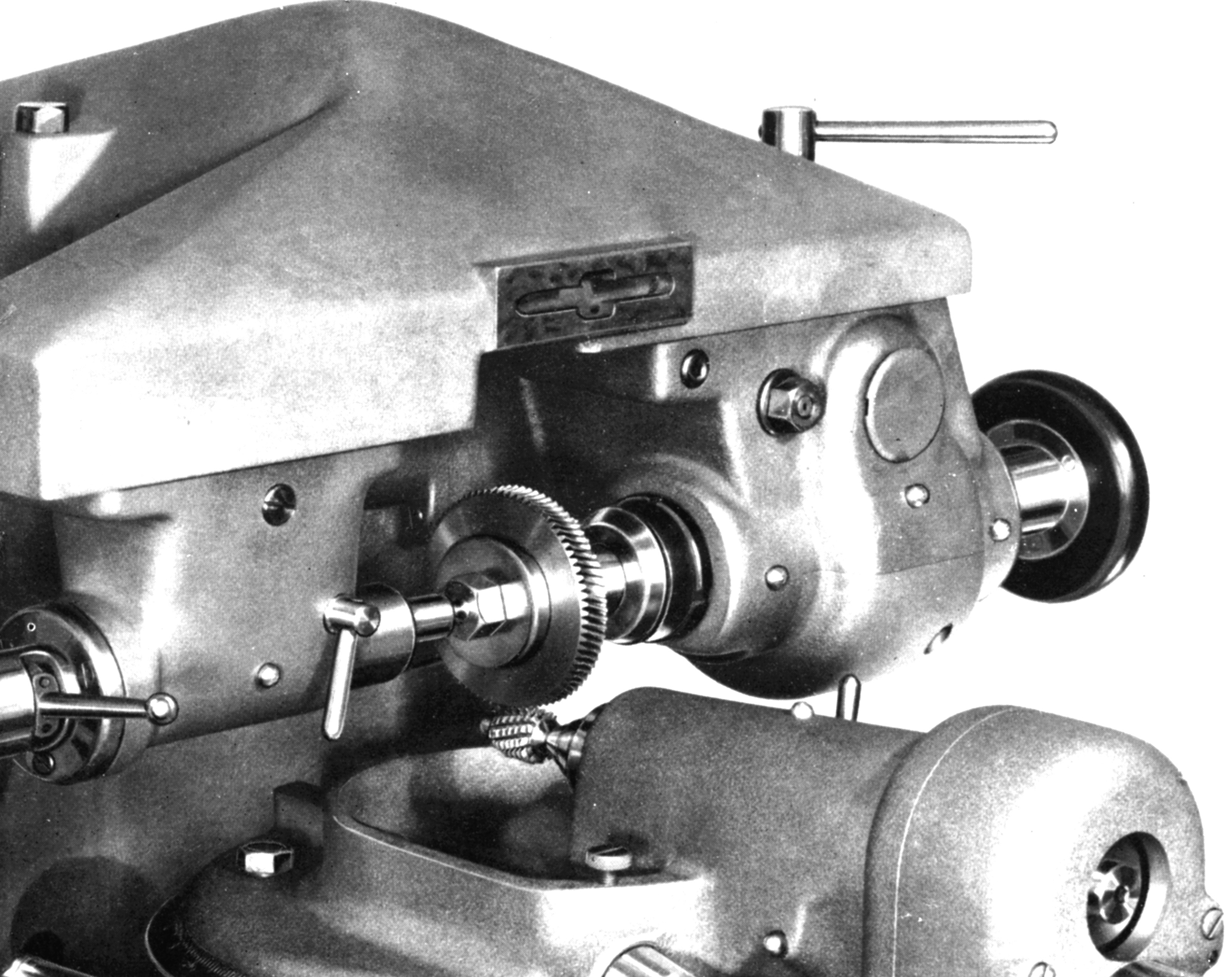

Hobbing a bevel gear on a standard Mikron 102
