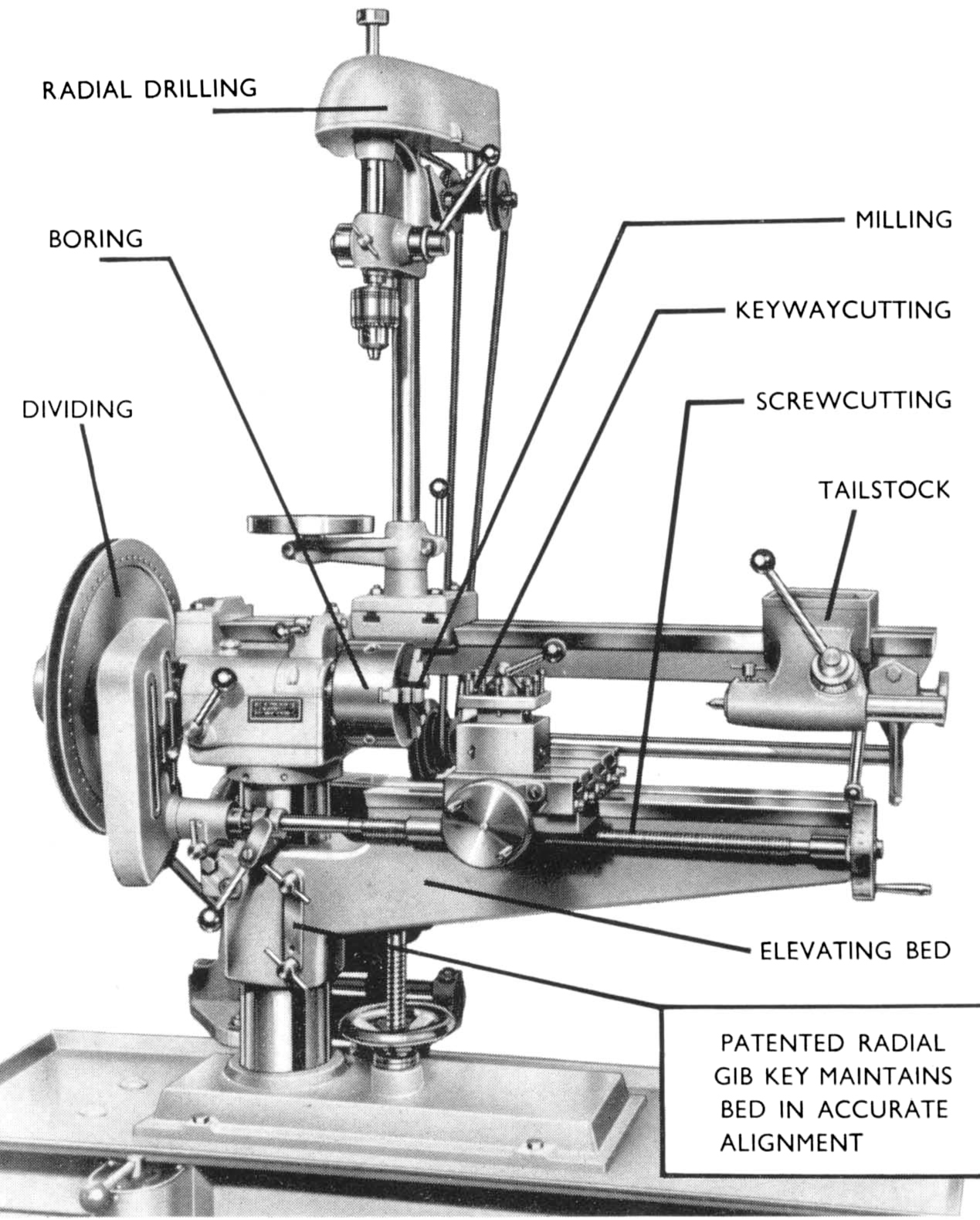

General Description:

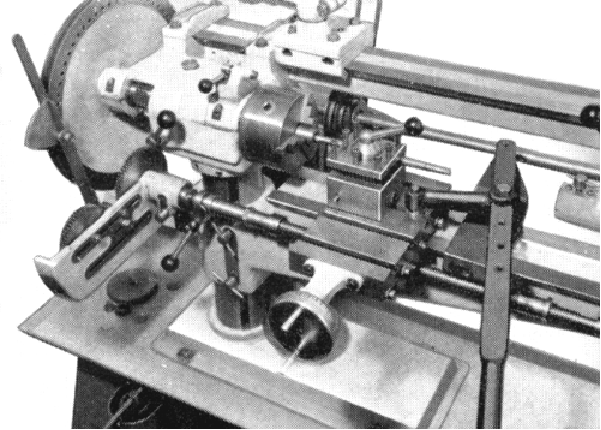

This machine should not be regarded as a special form of lathe. It represents a new conception of a general purpose machine tool made possible by a simple patented invention. This invention consists of a triangular gib key (British Patent No. 696773) which enables any member enclosing and sliding upon a column to be maintained in strict radial relationship to the axis of the column.
Within its capacity this machine will perform the duties of a milling machine, a horizontal borer, and a lathe with no special adaptation. The attachment of a hand lever also enables light shaping work, such as keyway or spline cutting, to be carried out without the usual tedious handwheel operation.
The backbone of the machine is a massive column on which the main bed, complete with cross-slide, leadscrew, and changewheel arm, can slide under the control of a vertical feedscrew. This main bed is keyed to the column by means of the gib key already mentioned and its radial relationship to the column is thereby maintained. It may be clamped by means of the key at any desired height with complete confidence in the accuracy of its alignment.
The headstock is seated on the head of the column and means are provided for rotating it within fine limits so that the mandrel may be lined up accurately with the main bed and locked in this position.
At the back of the headstock two brackets carry an auxiliary Tee section bed on which is mounted the tailstock. Again, fine adjustment is provided for setting the centres in accurate alignment.
It will be appreciated that the parallel alignment of the mandrel, main bed and auxiliary bed in the vertical plane is taken care of in the design of the machine, but that in the horizontal plane there is a radial adjustment under the control of the operator. With the aid of a test bar, adjustment is not difficult and once set, the accuracy of the machine should be retained over long periods. The ability to check over the alignment in a few moments gives added confidence where particular accuracy is required.

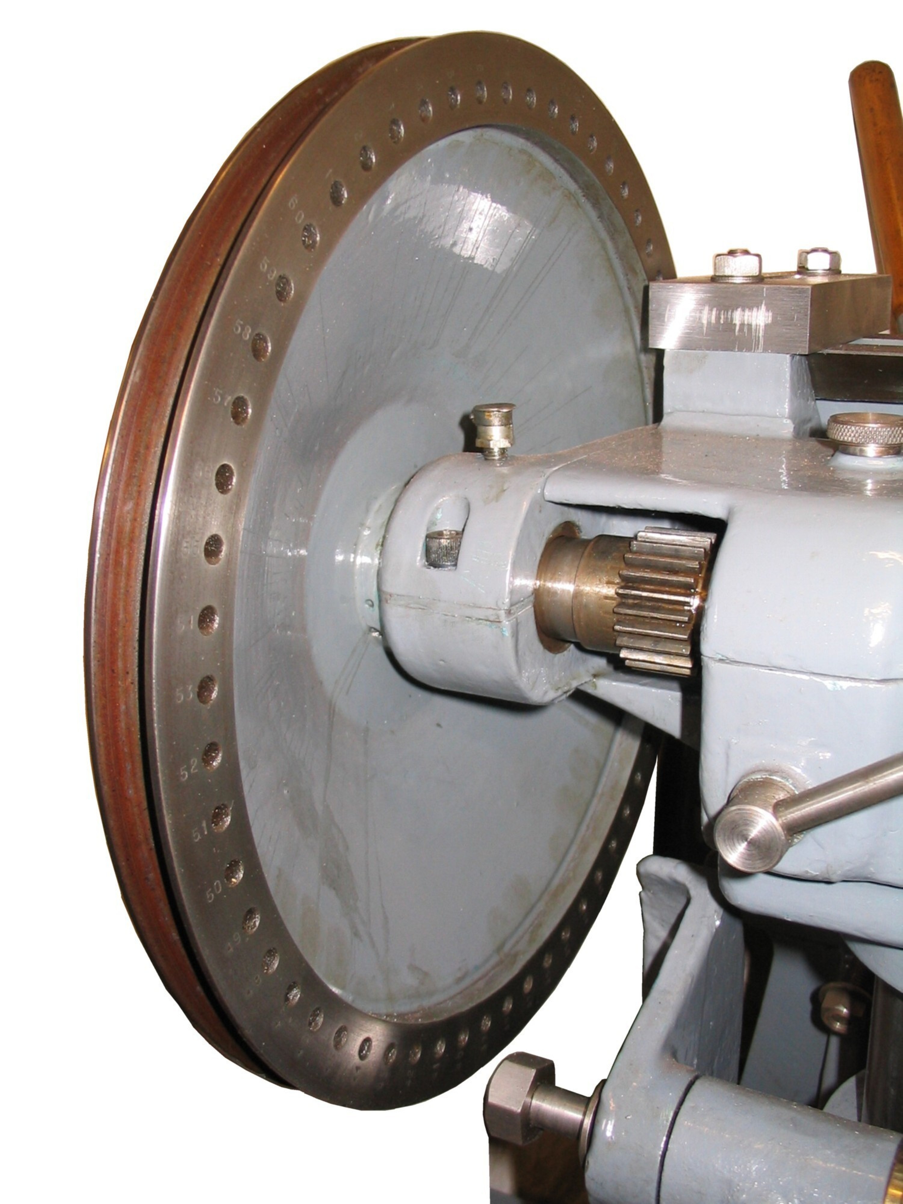

The drive from the motor is transmitted to the mandrel by means of a single belt driving a large four-step pulley weighing approximately 12 lbs. This pulley serves a number of purposes: a) it serves as a dividing head
b) it takes the place of a back gear
c) the momentum stored in it greatly helps to eliminate chatter, particularly in parting off operations
d) it is very convenient as a handwheel when using taps and dies in the tailstock, the weight giving good control as the threads are cut
e) it can be used freely as a break to stop rotation after switching off the motor, and generally for turning chucks, etc., mounted on the mandrel.

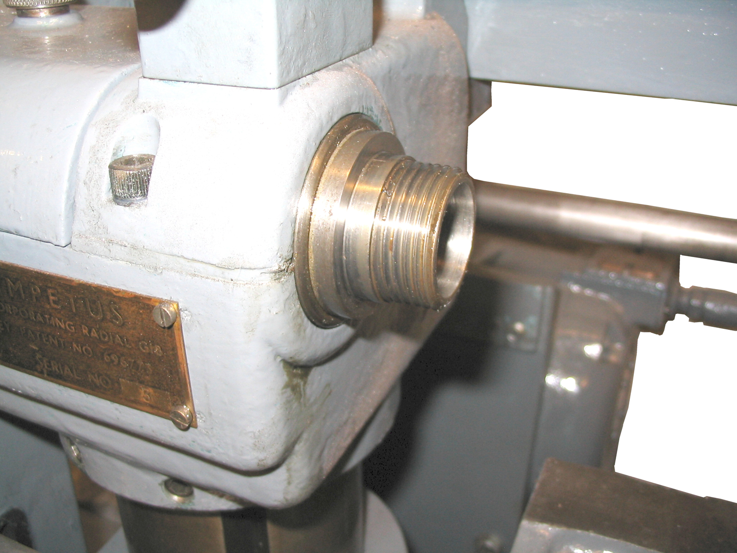

The headstock mandrel is bored to take 3/4" dial. stock and the nose is bored No. 3 Morse taper for suitable collets.

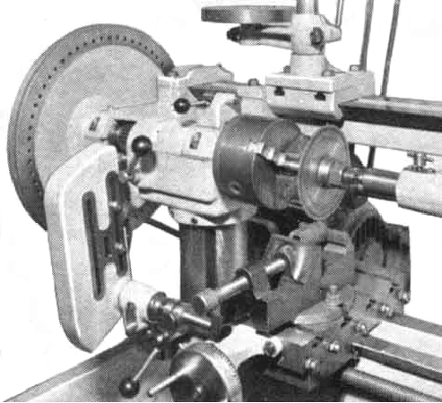

6. DIVIDING
The main driving pulley is provided with 60 equally spaced and numbered holes in the rim. Any of these holes can be picked up and the mandrel locked by means of a link rod, one end of which is attached to one of the slots in the changewheel carrier arm. Movement of the carrier arm allows fine adjustment of work held in the chuck before locking the mandrel in any fixed position. The link rod itself has a subdividing arrangement enabling the 60 divisions each to be divided into 6, thus giving total divisions of 360 degrees.

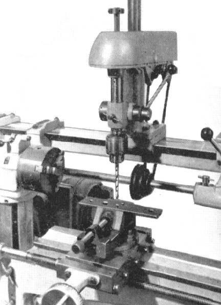

10. VERTICAL MILLING
A vertical drill mounted on the Tee bed makes the machine into a small radial drill. The drill head may be lowered on its column until the work can e drilled on the cross-slide table and traversed under the drill as desired. If the drill is taken well out to the end of the Tee bed, quite large sheets or other work can be passed beneath this bed for drilling. Alternatively , when positioned at the inner end of the Tee bed, the radial drilling of work held in the chuck may be carried out, in conjunction with the indexing arrangements on the driving pulley. A small milling head could easily be fitted and would be a useful adjunct.

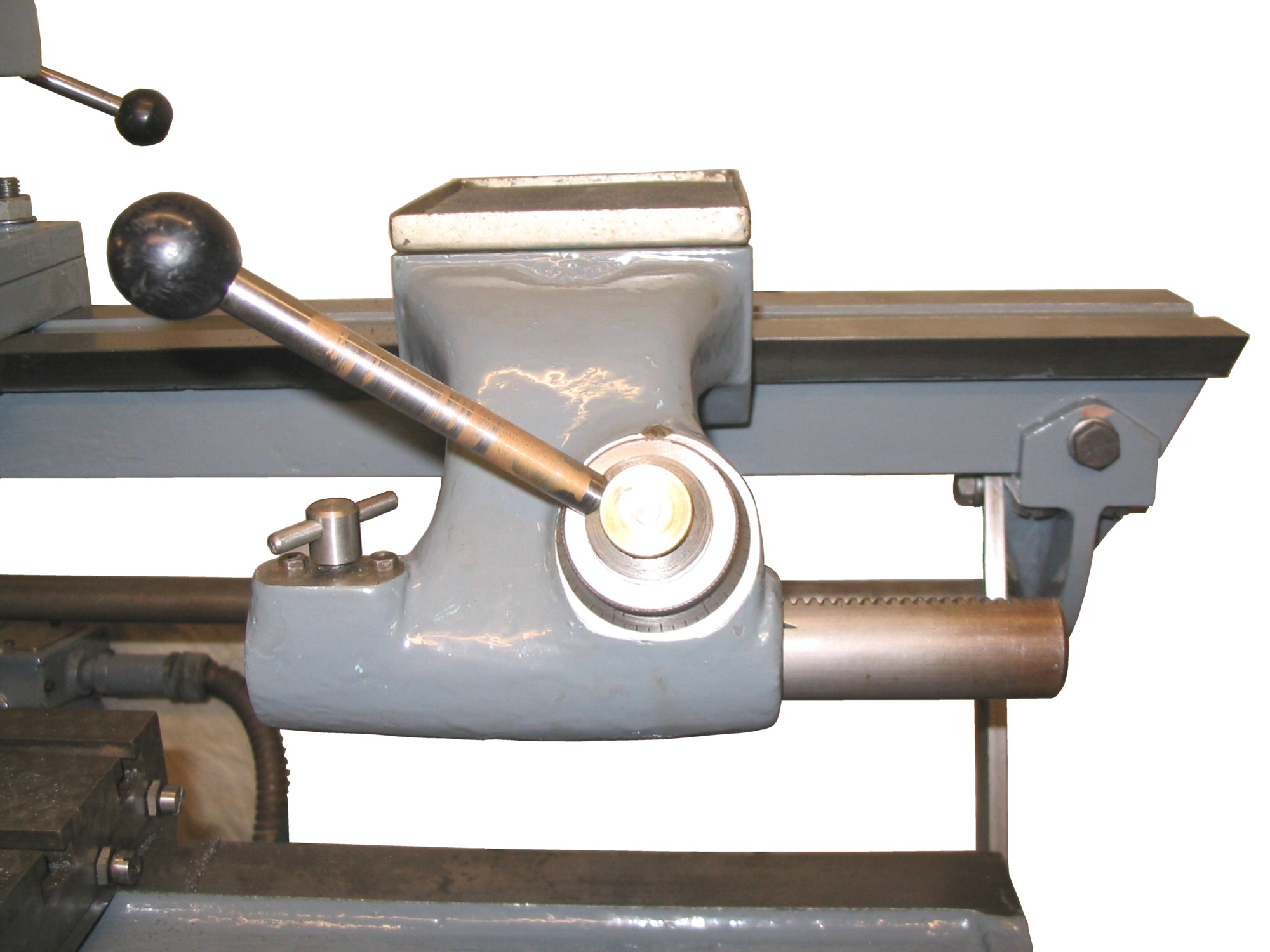

13. THE TAILSTOCK
The tailstock designed for the machine is fitted with a rack feed to the barrel. A graduated dial, with zero setting arrangement, is fitted, and this will be found useful for depthing accurately when drilling. It may also be used when boring blind holes, as a depth gauge, if it is made to follow the saddle as the tool progresses.
The barrel is locked by means of a gib key similar to that used on the column. This key can be adjusted so that there is no rotary shake in the barrel and therefore less chance of drill snatching. Only finger tight screwing down of the locking screw is necessary to hold the barrel, owning to the wedge action of the key. It is also instantly released.
Being independent of the main bed, it is seldom necessary to hold work with the barrel fully extended, since the tailstock may be passed right over the saddle and brought up close to the work.

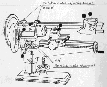

14. SETTING UP
A ground test bar is required with the machine and one end of this bar should be reduced to No. 3 Morse taper to fit the mandrel nose.
Insert the test bar in the mandrel nose. Ease off the nut on the central stud passing through the headstock casting. By means of the adjusting screws, rotated the head on the column in the appropriate direction until no movement is recorded on a clock fitted in the toolpost as the saddle is traversed up and down the bed. Tighten down the nut on the central stud when this is so.
Insert centres in headstock and tailstock, bring up the latter until the two centres are touching. By means of the adjusting screws BBBB bring the centres into true alignment, at the same time keeping the Tee bed parallel with the main bed, sighting by eye.
Slide back the tailstock and introduce the test bar between centres, test with the clock in the toolpost, and correct by means of the screws BB in the outer bracket only. Tighten up the locking screws underneath each bracket.
Once set, the accuracy of the machine will be retained for long periods, but the above procedure should be used for resetting after dismantling or for checking if particularly accurate long turning work is to be done.
In any case, only a few minutes are required to check the adjustment and the operator can feel that at all times he has the accuracy of the machine under his control.
Vertical Feed Adjustment: Slacken all gib key adjusting and locking screws.
Tighten clamp bolt at rear of main bed casting until lifting screw can be lowered and bet held suspended. Slacken clamp bolt until bed just falls under its own weight.
Tighten gib key adjusting screws individually, again adjusting until the bed can just fall under its own weight.

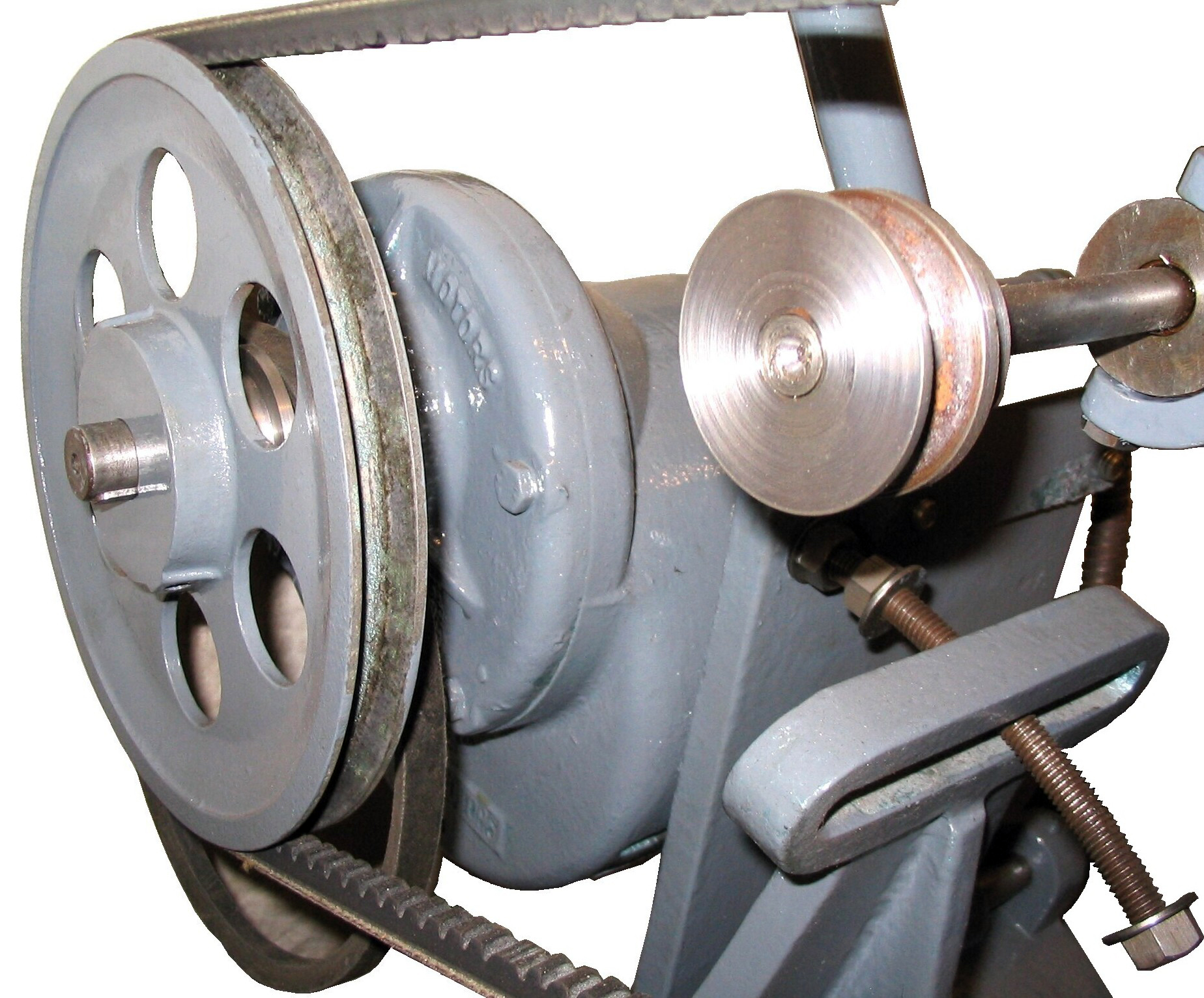

15. MOTOR DRIVE
The most convenient drive for this machine is a 1/2 hp geared motor, having a final shaft speed of about 300 rpm. If this shaft is provided with two pulley 1 3/4" and 8" diameter., a satisfactory range of eight speeds can be made available with suitable belts. The motor should be mounted on a hinged plate with take up adjustments. .

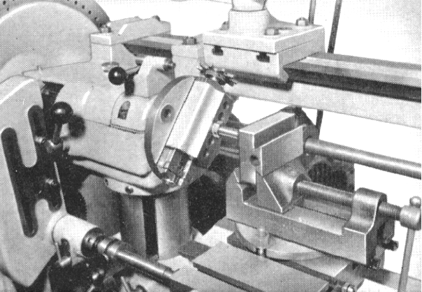

The Metalmaster in use as a simple horizontal milling machine.
The generously-proportioned 10" x 4.5" T-slotted table allowed a decently strong  vice - to be mounted and, with a cross-feed travel of 7" - equal to many medium-sized milling machines, a lot could be accomplished in a small space.

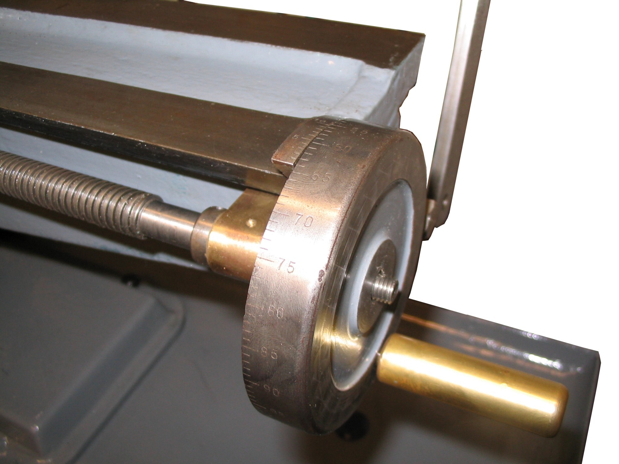

Note the edge of the cross-feed handwheel doubling as a micrometer dial - an easy and effective way to enjoy a large, clear graduations at minimum expense.
Another very unusual English lathe which happened to use this feature was the Edgar.

A very clever arrangement was fitted to exploit the 60 "division" holes which ringed the front face of the large drive pulley - the lever carrying the engagement pin (it can be seen fastened to the banjo carrying the changewheels) was provided with 6 incremental positions which extended the total number of divisions that could be created to 360.

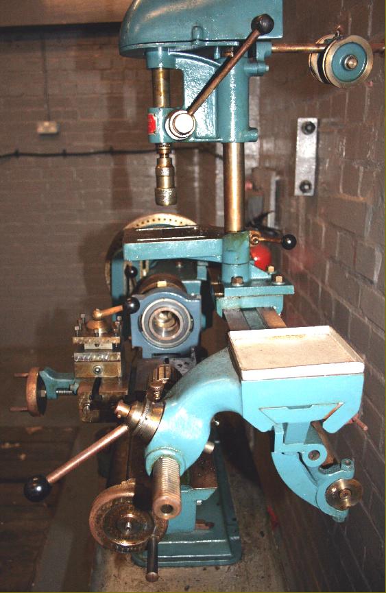

The drilling head (which was omitted from the small batch of machines made) shown in its operating position with the simple but clever drive system of a bar and pulley driven between centres.
Because its support ran the length of the bed, the drill became, in effect, a miniature radial-arm type.

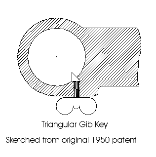

The headstock of my machine is mounted on top of a massive column, with a cantilevered bed carried on the column beneath it and raised and lowered by a jacking screw at its point of balance, An auxiliary Vee bed carries the tailstock and is mounted in brackets behind the headstock. The top surfaces of these brackets are ground true with the mandrel and the auxiliary bed is held by screws forcing it upwards against straps seated on the ground surfaces of the brackets.
Thus, the working surfaces of the two beds, the headstock mandrel and the tailstock barrel are all strictly parallel in the vertical plane. However, when looking down on the machine from above, alignment of all these parts can be achieved by radial adjustment, with the column as centre, and this adjustment is under the control of the operator. It will be clear that, for the success of this arrangement, one component, the cantilevered bed, must retain its radial relationship with the column with extreme accuracy and this I achieved with a special triangular gib key, which I invented and patented at the time. A sketch of part of the original Patent Drawing is shown here, though the patent itself has, of course, expired..
The startling performance of this key in maintaining accuracy has to be seen to be believed. Its very simplicity is deceptive. When raised or lowered on the jacking screw and re-clamped, the outer end of the bed can be relied upon not to deviate by more than .001" to .002" in radial alignment. One must appreciate that at this radius the key is operating at a disadvantage of about 20 to 1! An error of this order over a length of 18" is probably as good as one would expect from any orthodox light machine of this class.
The Triangular Gib Key has three great points in its favour for this particular application:
(1) The alignment of the bed with the mandrel can be maintained to very close limits indeed, when it is raised or lowered, on account of the keyway faces themselves being radial.
(2) When locked, the key acts as an extremely rigid clamp and being of wedge shape, can be adjusted to a very close sliding fit, like a gib strip, and yet it clears instantly on release. The sliding clearance at the key faces can be so small that, with normal work anywhere near the chuck, it is unnecessary to apply the locking screw and clamp the bed. The vertical feed can be used for milling or other purposes as freely as the cross-slide or leadscrew feeds.
(3) If the key is removed, the whole bed can be swung radially and locked, for turning work to any desired taper. In fact, the arrangement can be summed up by saying that parallel turning is merely a case of "zero taper."
Adjusting screws are provided for truing up the mandrel, and the auxiliary bed and tailstock to fine limits and with the aid of a test bar, this radial lining up of the machine can be achieved in a matter of minutes.

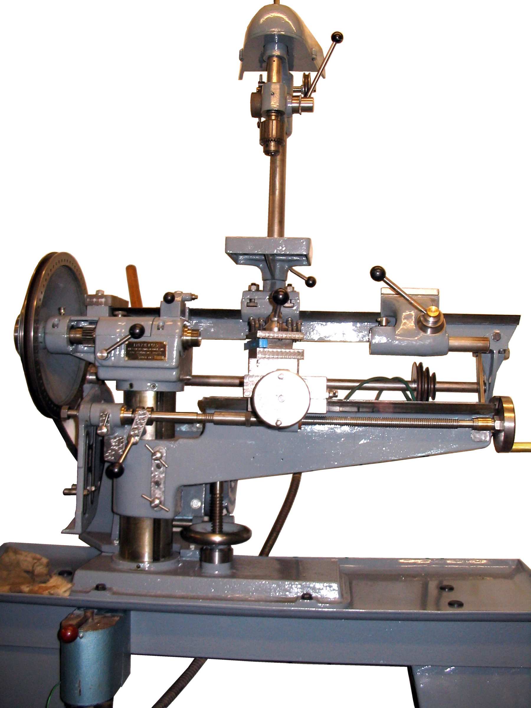

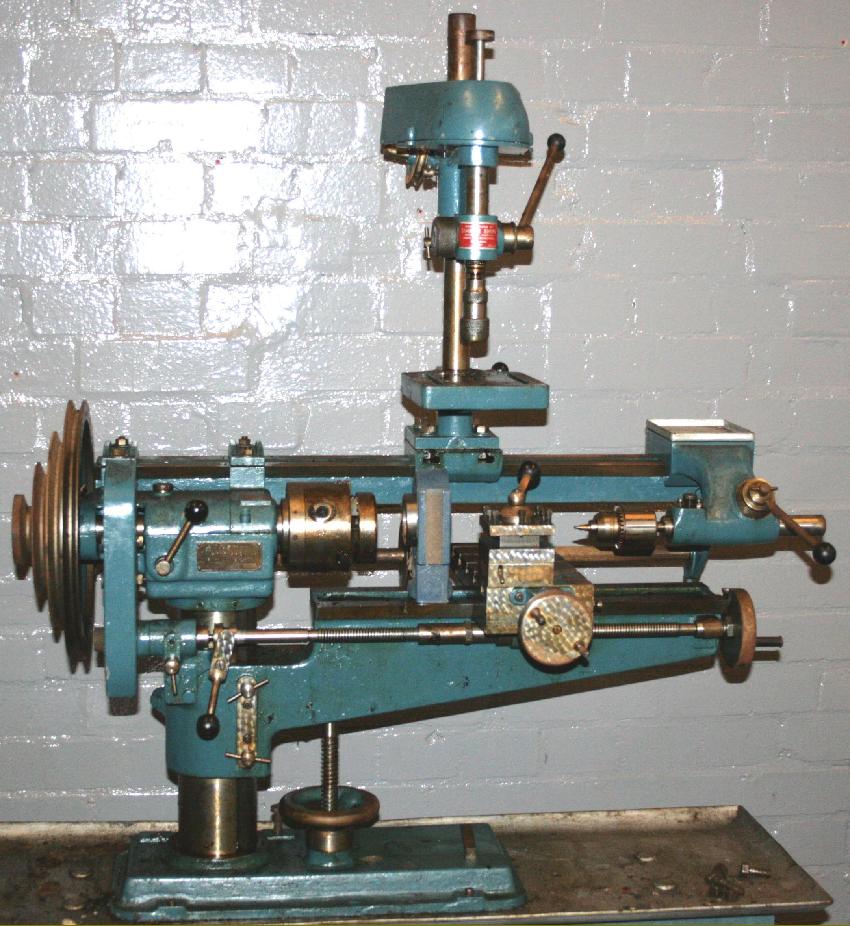

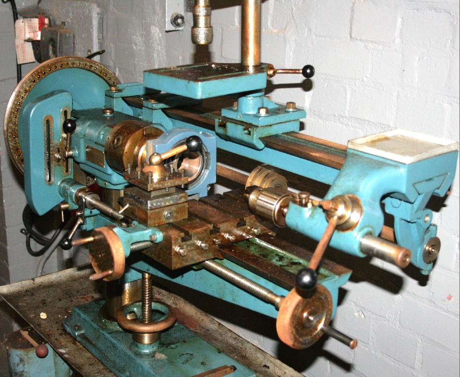

The designer's own lathe - now in the sympathetic hands of Mick Collins
The Metalmaster - a modern review:
At some point in the early 1970s David became interested in model Stirling engines and it was as a result of an article that he wrote on his moving regenerator type in Model Engineer that I first wrote to him.
A long correspondence and friendship followed and when David returned to England from his retirement home in Malta I was able to visit him at his new home in Somerset. Naturally we gravitated to his newly-built workshop where I saw not only his collection of Stirling engines but also his Metalmaster, a machine that had fascinated me ever since reading about it in the Model Engineer back in the fifties.
Unfortunately it wasn't working as, during the journey back from Malta, the cross-slide feed-screw nut had been lost. However, within a couple of days I had made and posted a replacement to him and the next time I visited I was able to play with the machine.
Sadly, a few years later, poor David became a victim of Parkinson's Disease and, anxious that his machine should go to an appreciative owner, he offered it to me. A fair price was agreed and I became its proud owner.

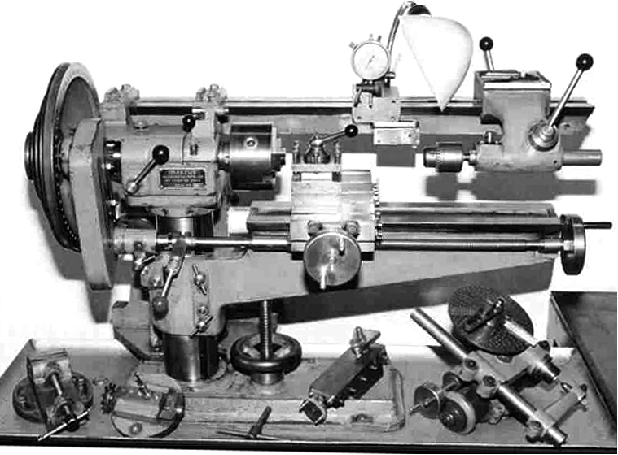

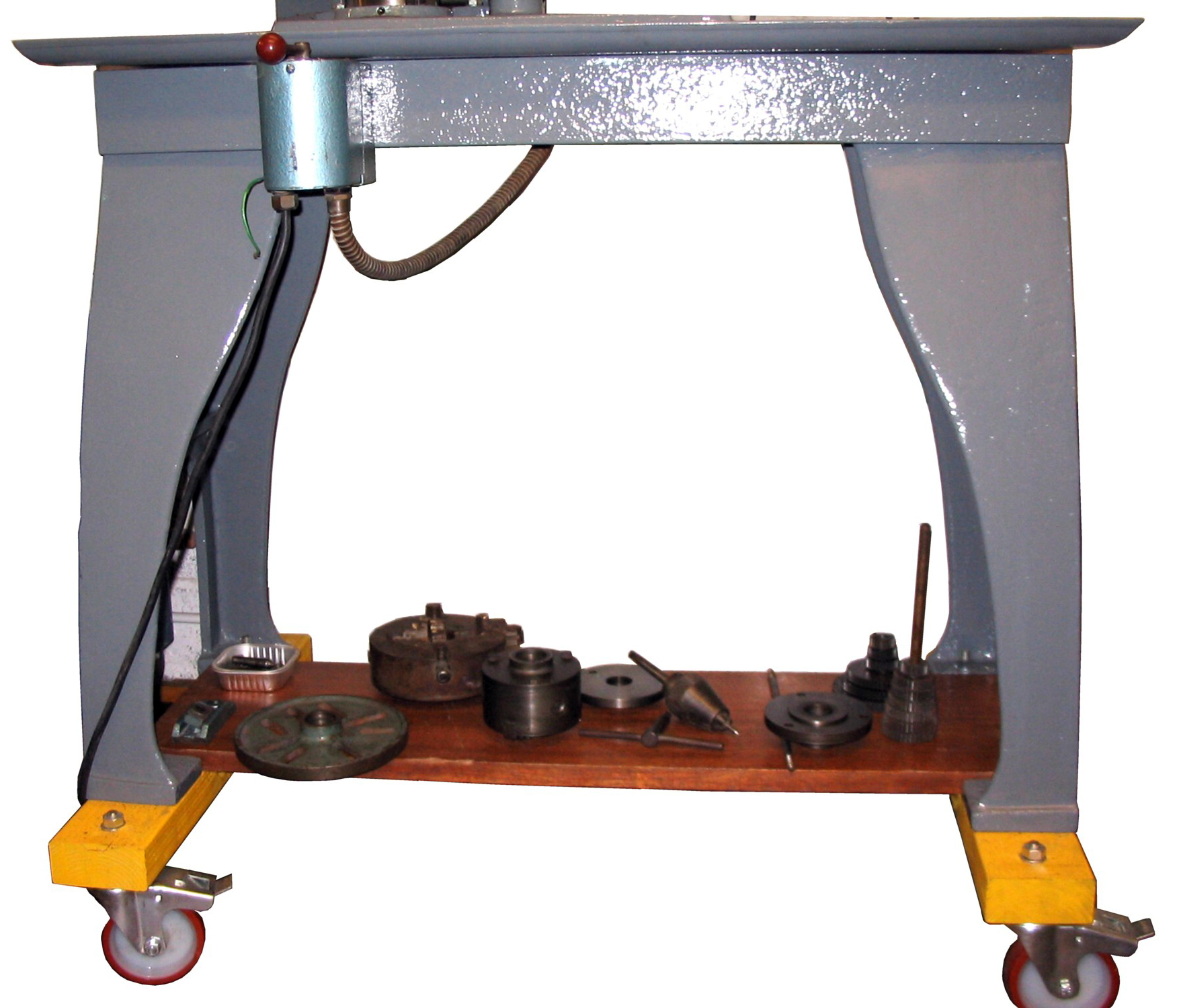

Seen here with the machine are some of the accessories, including the boring head and topslide mentioned in the brochure, together with the vice designed to fit the cross-slide and a matching dividing head. The saddle fitted on the parallel auxiliary bed is my own addition and can be slid along by hand before locking in position. It was originally made to hold a fixed steady but, in addition, proves very useful for holding the lamp, the D.T.I. and the home-made tool height setter, a device similar to the old 'Unique' indicator, which can be swung out from under the saddle to sit on the tool tip.
There is little I can add to David's article re the versatility of the machine, it is certainly all that he claimed for it and can be converted to any of its functions within a couple of minutes. Its accuracy was all that he claimed for it although now, after nearly fifty years of 'amateur' use, is slightly impaired by wear at the headstock end of the bed. (In retrospect, David thought that since the tailstock was no obstacle, the saddle could have been made rather longer with some advantage) I can't really comment on the machine's rigidity since I normally use it for building small model Stirling engines and handle it like cut glass - nevertheless, recent jobs have included skimming the brake drums of my wife's Morris Minor and re-machining the base of an Indian cylinder barrel, requiring the full fourteen inch swing to accommodate the finning around the valve seats. Sumitomo tips are very satisfactory for all these straightforward turning and boring jobs.
David's geared-motor drive was becoming very noisy and has been replaced with a Sinclair C5 motor with infinitely-variable speed control since when parting off inch and a quarter steel has become a real pleasure - albeit a slow one!
Finally, I must agree with his remarks regarding the usefulness of the vertical feed - handling a conventional lathe now feels like working with one hand tied behind my back. And the sheer versatility of the machine has given me a new hobby - that of finding new jobs for it to do. Mitering picture frames took longer than expected though, due to the need for spotless cleanliness ……...

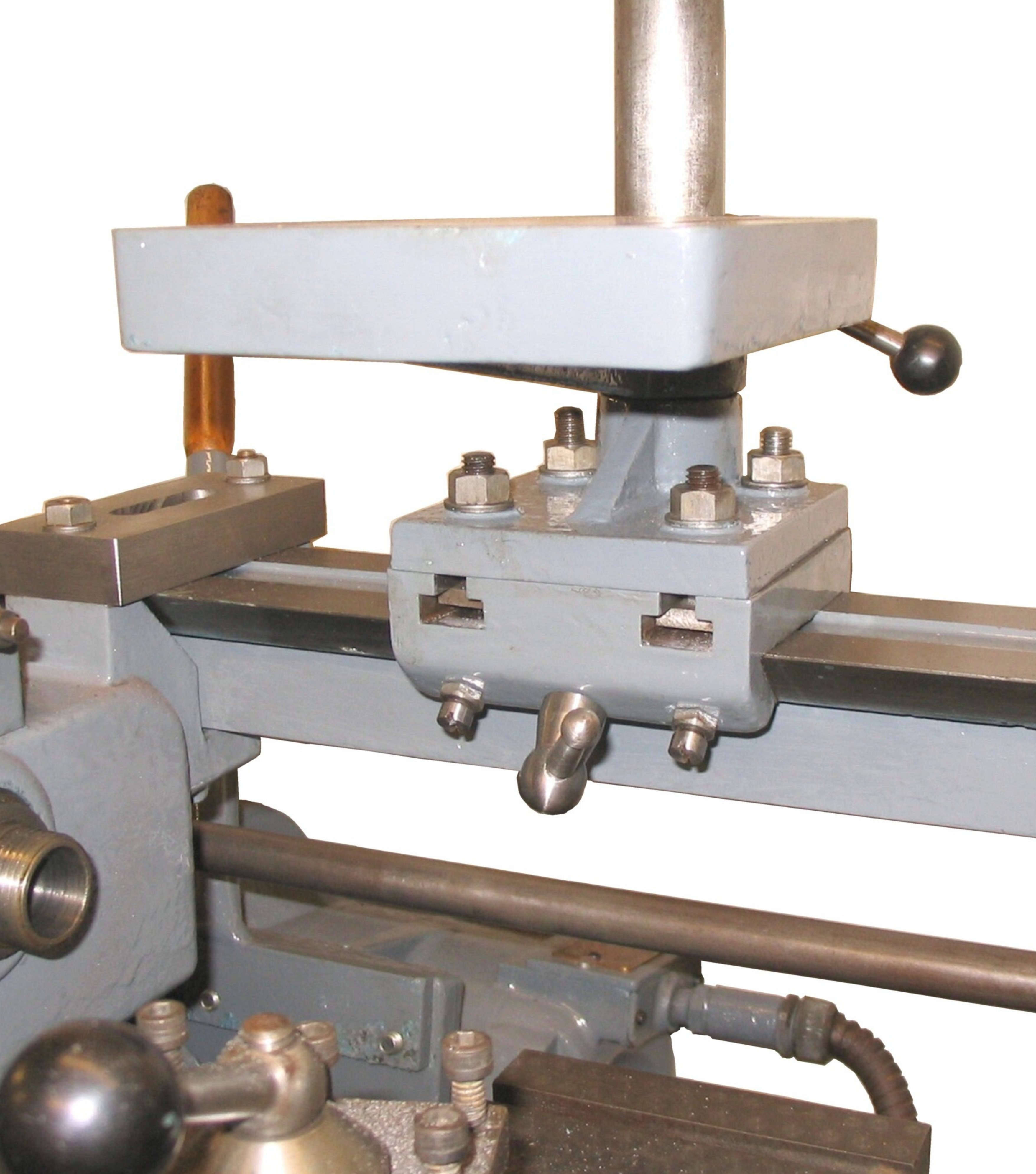

Milling machine mount

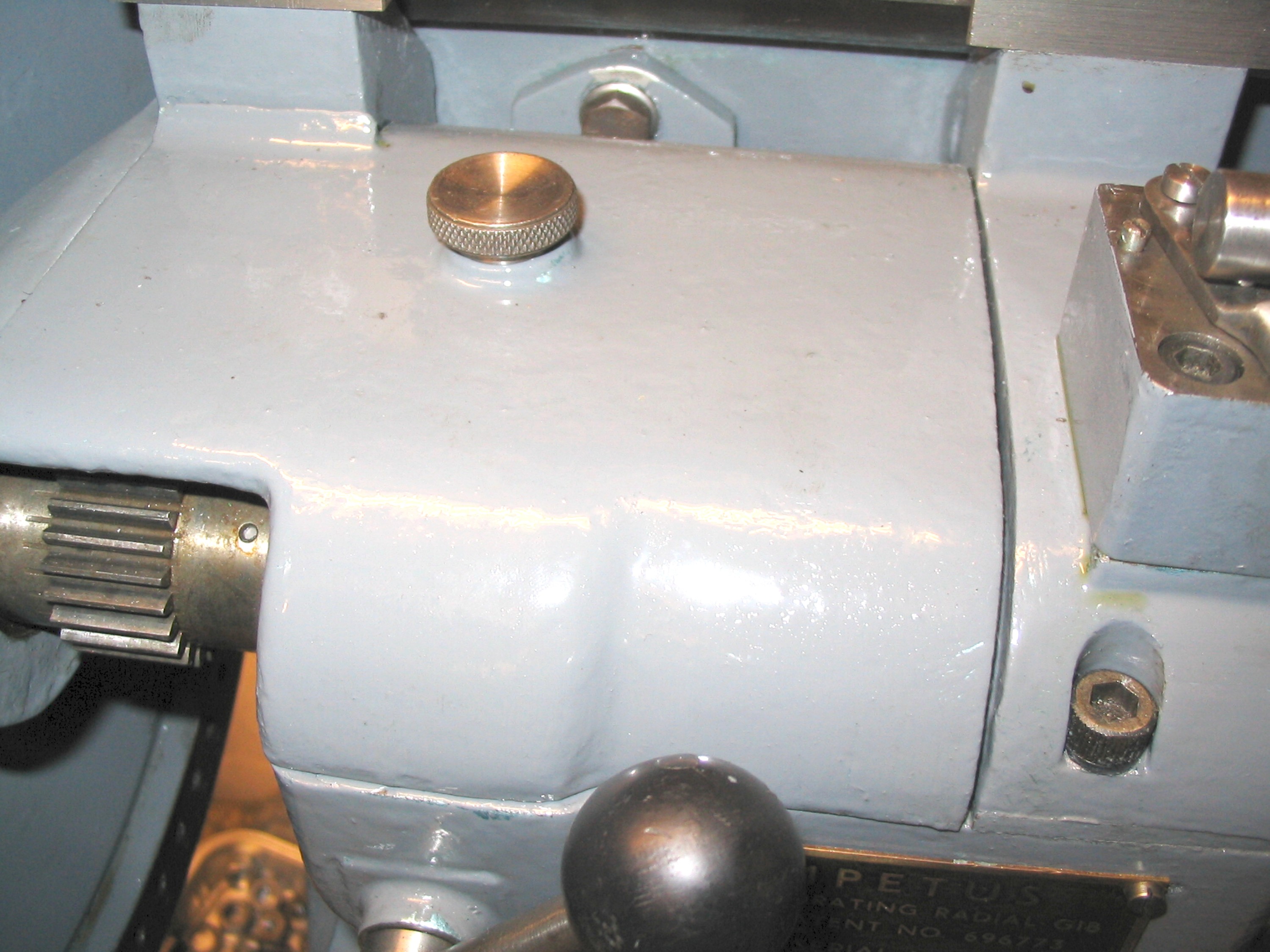

Headstock cover

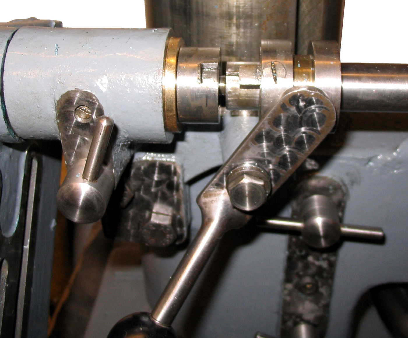

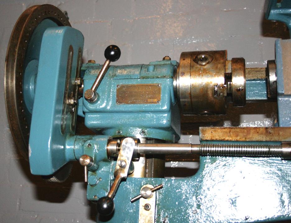

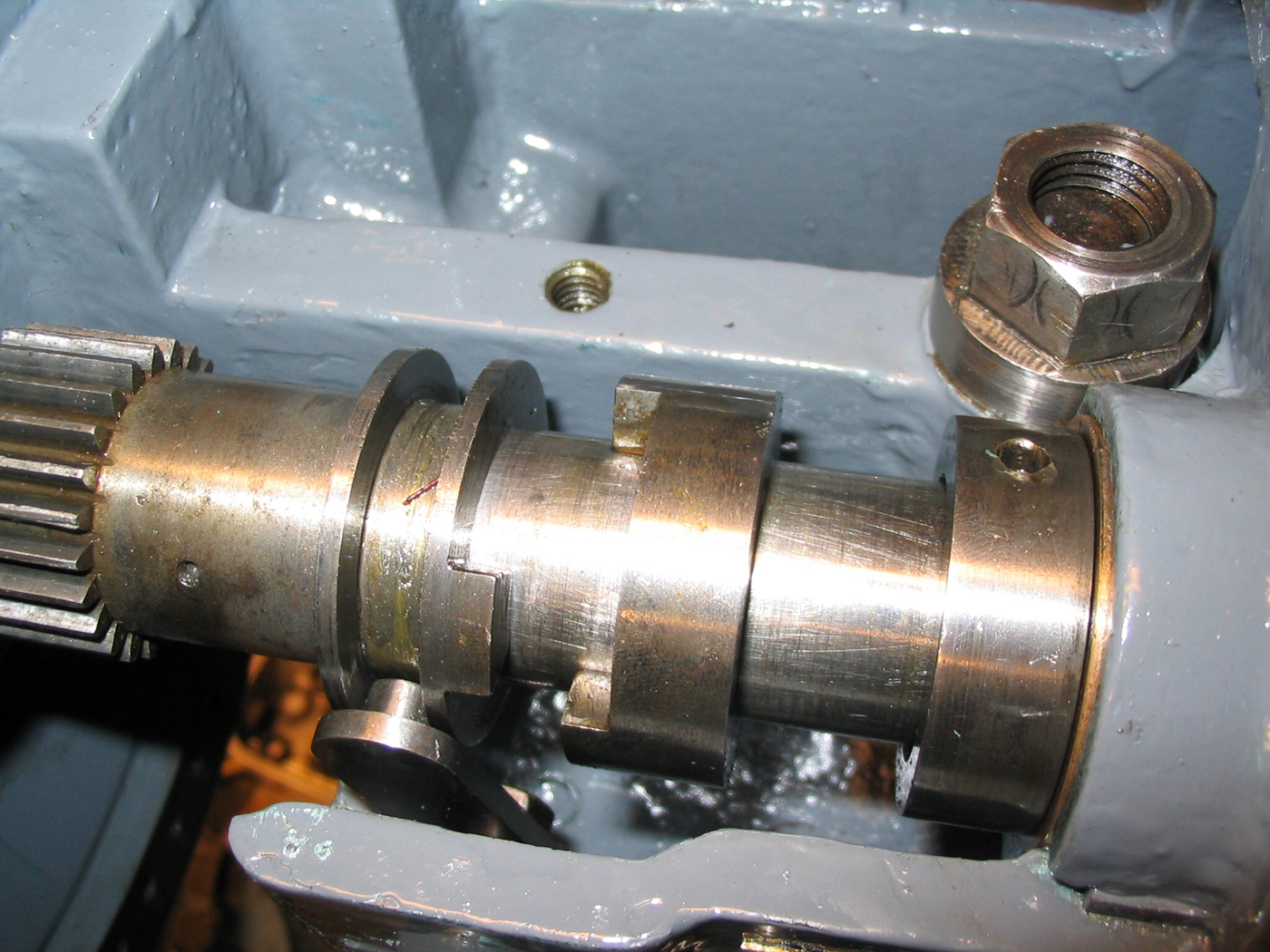

Headstock-mounted dog clutch

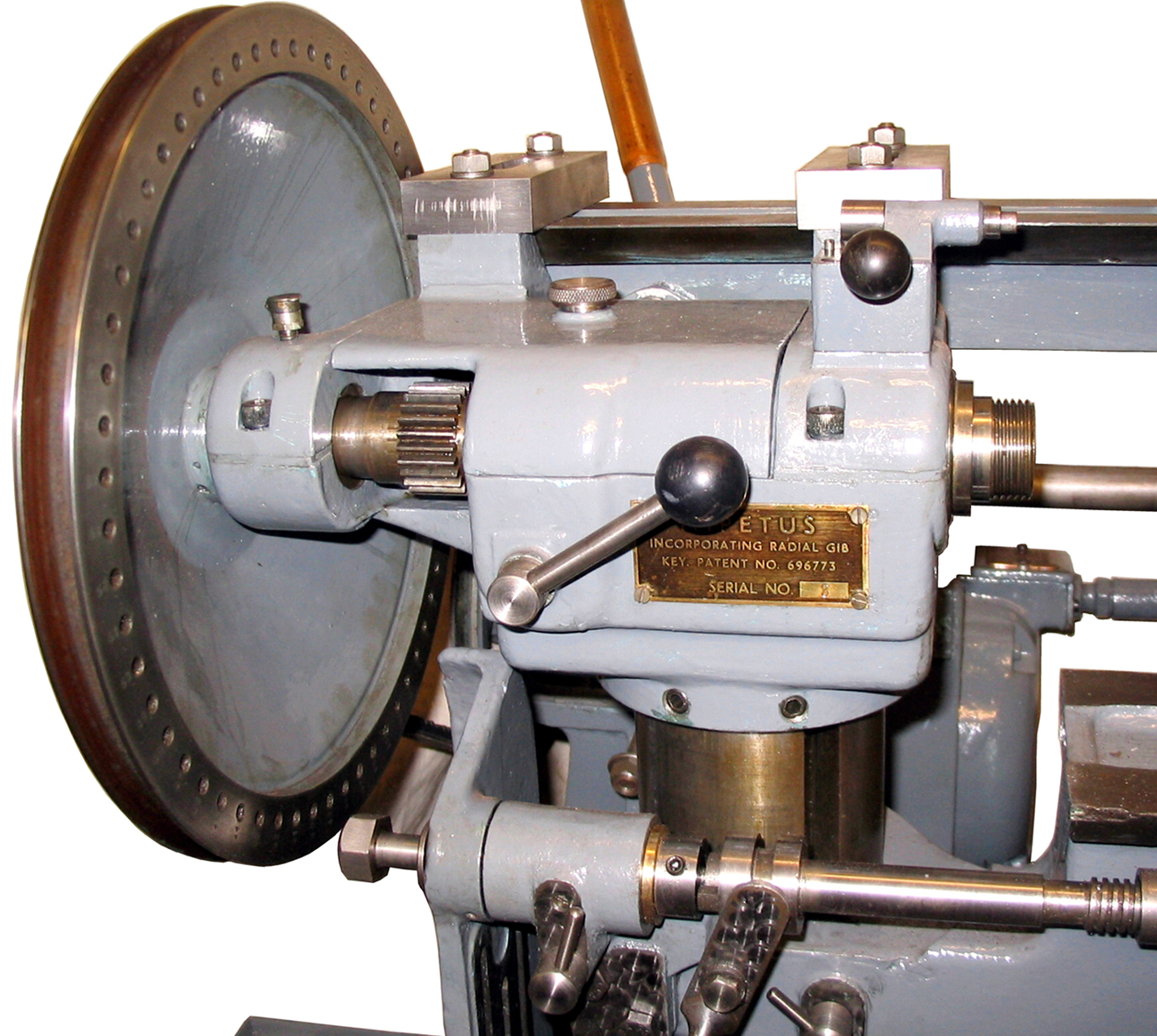

Spindle pulley-cum-flywheel-cum dividing ring
Complete headstock assembly
Spindle nose

Graduated handle on leadscrew
