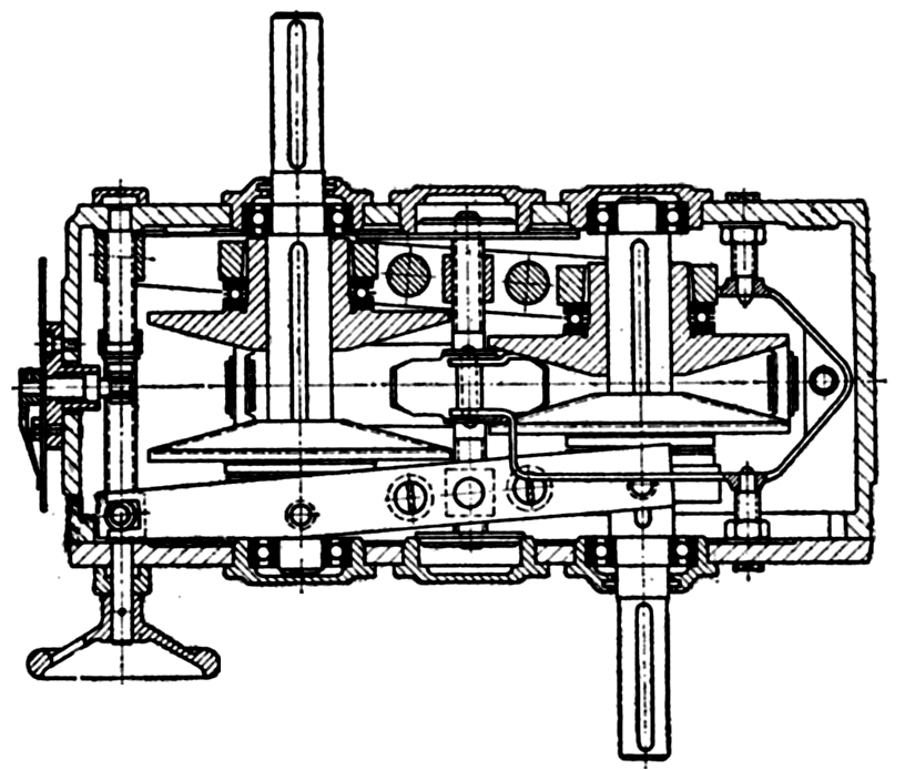

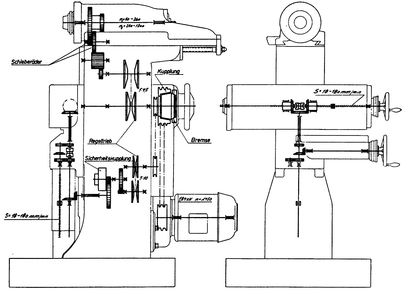

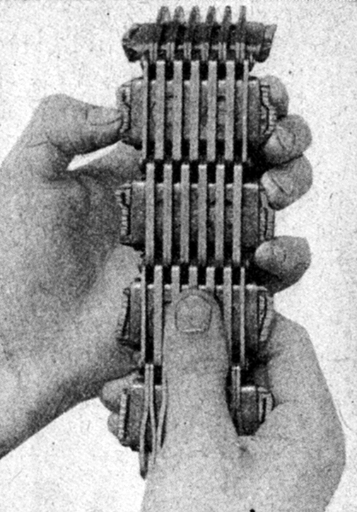

Built in 1937, the first example shown below was based on a design that was to become popular throughout Europe* - and as originally developed through the contemporary  Thiel 58, Maho SK250 and Deckel FP1 types. A rare machine, and almost certainly sold only in continental Europe, the early Variomat was fitted with a 2-speed, 3-phase (1 kW, 1500 r.p.m.) Siemens motor that powered two infinitely-variable-speed "gearbox" units by PIV (a maker still in existence) - one connected to the spindle and the other to the table drive. In the diagram below can be seen two sets of 4 conical expanding and contracting plates marked REGELTRIEB - these provided the alteration in ratio as they opened and closed.  Whilst for lower power applications an ordinary "rubber and canvas" belt is used on this sort of drive this version employed conical plates with "teeth" - the belt being replaced by a special steel chain that could mate with the pulley indentations. The spindle variator worked through a safety-overload clutch, and completely integrated into the body of the machine; that for the table was similarly clutch protected though easily dismounted for maintenance. The system gave two speed ranges: low from 50 to 260 r.p.m. through a reduction gearbox and high from 250 to 1200 r.p.m in direct drive. A dial on the side of the column showed the various setting with the upper window displaying the cutting speed in m/min (depending on the milling cutter diameter - the words Schnittgeschwindigkeit and Fraser D can be made out) and a lower aperture giving spindle revolutions per minute (umdrehungen). A separate window displayed the table-feed rates - these varying from 10 mm/minute to about 120 mm/minute. Interestingly, the motor was switched on by a lever (Motor Ein) not a push-button, with a second lever (Getriebe Ein) to engage the spindle-variator clutch. The latter was spring-loaded, and required some force to move, the clutch engaging gradually across the arc of movement - in the manner of a car or motorcycle type. There was also an Einrichten position by which means the engagement could be "tuned". Once running, the setting of each variator was independently altered by separate 3-spoke capstan handles on the right-hand face of the main column. Apart from the ingenious drive system, the miller was conventional for its type and of the standard German design, a Universalwerkzeugfräs-und-Bohrmaschine (all-purpose tool milling and drill press). It used a vertical head that could be driven across the top of the main column (by a handwheel working through reduction gearing) to provide the in and out feeds. The knee, which moved from side to side and vertically, was fitted with a vertical T-slotted surface able to mount several different tables - plain, plain-tilting and compound swivelling. Control of the table's movements was by the popular joy-stick method that, as on similar models, may well have been able to engage (deliberately) both vertical and lateral feeds simultaneously.

A diagram showing how the main motor - mounted at the back of the main column - drove upwards to an input shaft that drove both the main spindle and the table power feeds. The two sets of 4 conical expanding and contracting plates marked REGELTRIEB provided the alteration in ratio as they opened and closed.  Whilst for lower power applications an ordinary "rubber and canvas" belt is used on this sort of drive this version employed conical plates with "teeth" - the belt being replaced by a special steel chain that could mate with the pulley indentations.

Drive system of the type employed in the Variomat
