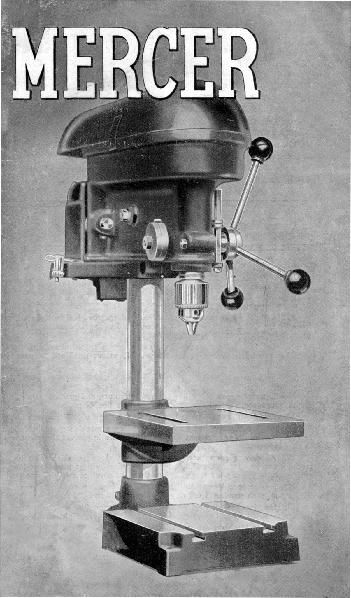

Seldom found, the Mercer drill press was manufactured by the Mercer Engineering Co. Ltd., based in Rooley Lane, Bradford. The Company were also known or traded as, Mercer Pneumatic Tools Ltd., with a product line concerned with that sector of industry with, in 1974, a patent granted to the inventor, Austin Cartwright Mercer, Jr., for a lathe bar-feed mechanism.
In comparison with other English makers of smaller drilling machines, for example Fobo, Meddings "Pacera", Kerry, Progress, Pollard, Qualters & Smith and Startrite, Mercer were little known and all trace of them now appears to have vanished. However, they did claim to have sold "several thousand" and offered it in three forms: as the Type 500 in bench or pillar models - the latter on a 5-foot long column - or, ganged up in sets of two or more for production work as the 600. It could be supplied with either a fixed Jacobs 1/2" chuck or, more usefully and at no extra cost, with a No. 2 Morse taper spindle. Fitted with a 1450 r.p.m. 3-phase motor the five spindle speeds spanned as useful 450, 900, 1500, 2500 and 5000 r.p.m. A slow-speed option was also listed - better suited where tapping was going to be undertaken - this being powered by what must have been a 3-phase 900 r.p.m. motor to give 300, 550, 960, 1600 and 3000 r.p.m. The maker's catalogue - a rare item - is reproduced below
