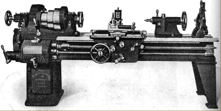

A 1925, 14-inch (diametral) swing non-gap lathe for toolroom and technical school use. This model was new in the early 1920s. Note the American type top-slide with lantern toolpost, atop a slotted boring table - a mixture of American and British design. Length of bed 6', weight 1,800 lbs.
