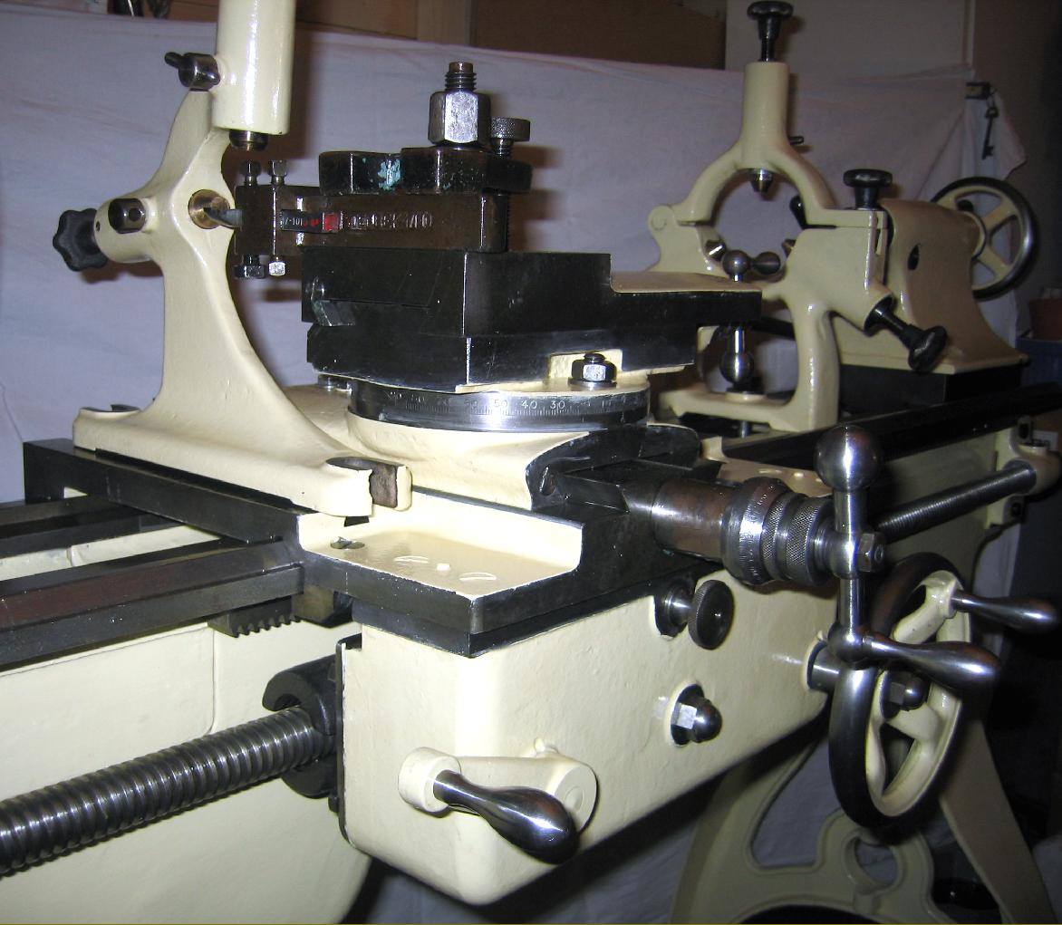

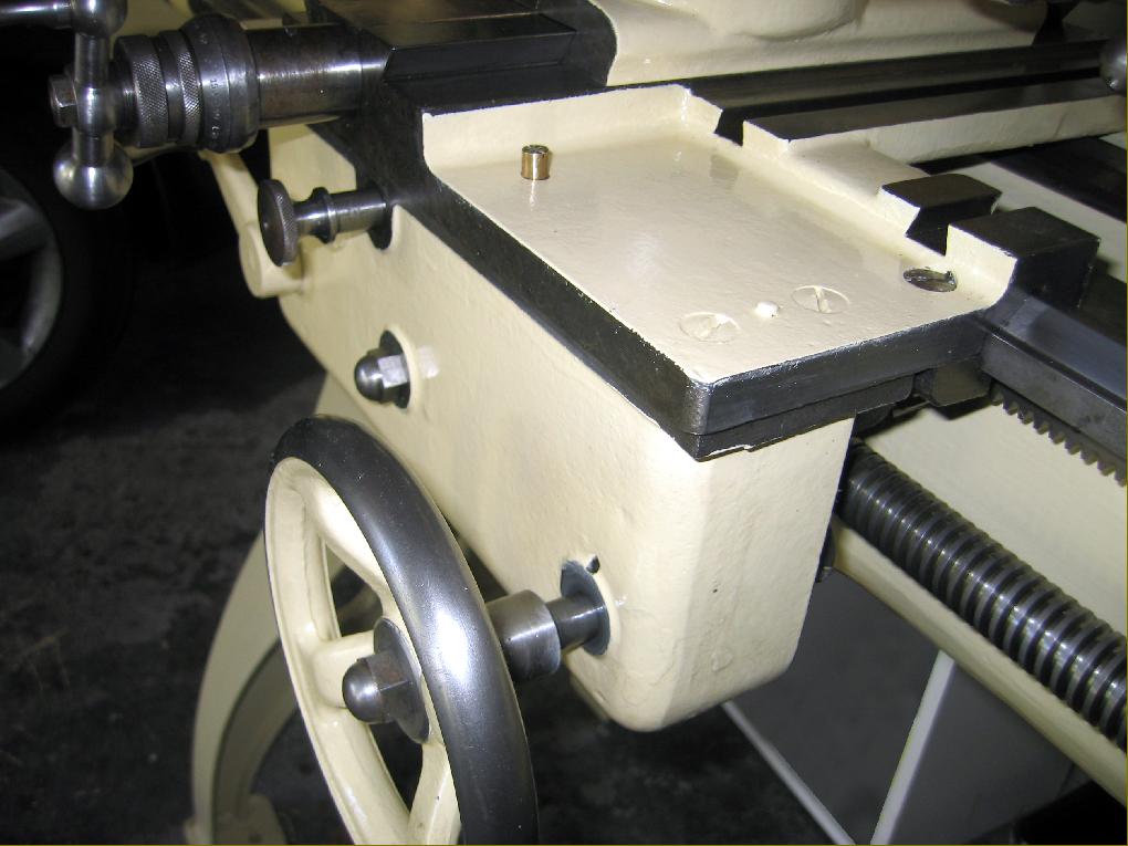

In addition to its comparatively crude power-feed mechanism, a further clue exist in the carriage assembly to show that this lathe was a steady development of a 1920s design: running on flat and V-ways, the saddle was a constant thickness front to back (no central bracing) and very deep front to back in order to carry an apron that was mounted well out from the bed.
The carriage handwheel provided 54 mm of travel per revolution and could, for safety reasons, be pulled out to disengage the drive.
Fitted with tapered gib strips secured by adjustment screws at both ends, the compound slide was a well-engineered. The slides were driven by 16 mm feed screws, with a split bronze nut that could be adjusted to remove backlash

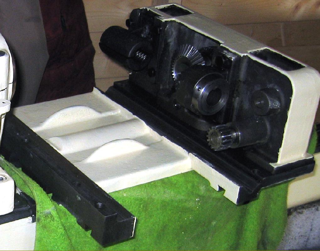

The saddle was relatively thin, with just two perfunctory cast-in braces and very deep front to back in order to carry an apron that was mounted well out from the bed. Note the bevel gears to drive the power-cross-feed mechanism.

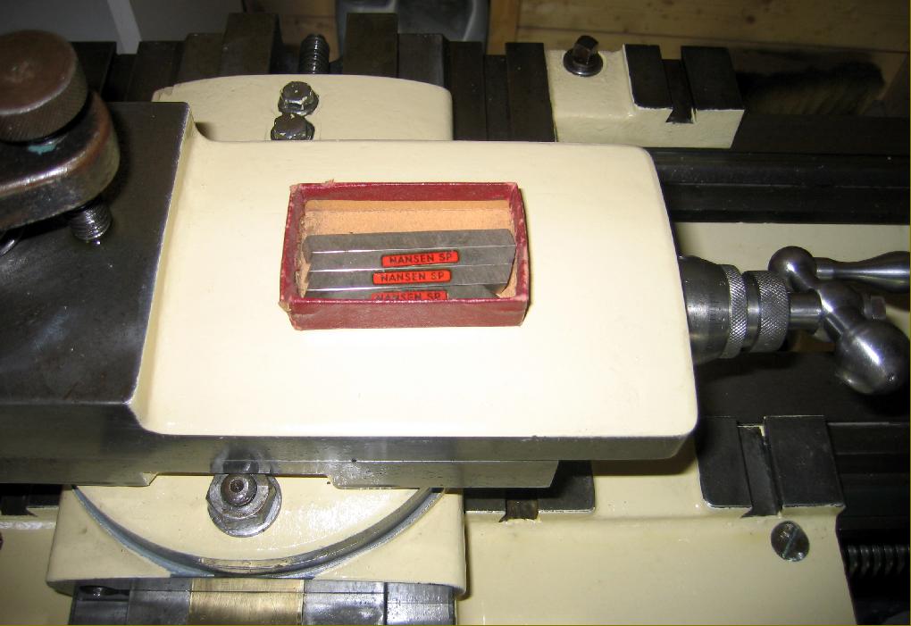

Appropriate for a lathe used at the Norwegian Polar Research Institute, a box of turning tools marked Nansen was found with the lathe

Matra lathes of later years incorporated some noticeable improvements in the carriage area: the saddle was much heavier with a deep bracing section reaching down between the bed ways whilst the front was shortened and redesigned so that the apron could be fitted so that its inner section was underneath the front bed rail. A wind-in clutch engagement was also fitted to engage the power feeds - a safety mechanism that would have been appreciated by less experienced operators.

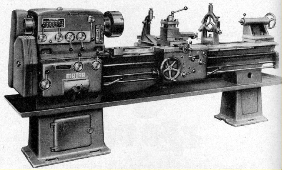

Matra D50 of the 1960s. 200 mm x 1150 mm
Matra MDR-20 of the 1960s. 300, 350 or 400 mm x 1000 to 6000 mm
Matra MDR-22 and MDR-25. 220 or 250 mm x 1000, 1500 or 2000 mm
