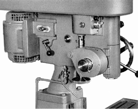

Continued: Built to the same standards as the earlier model, the SP.30 differed in several ways, including the previously mentioned change of head assembly. As before, the spindle-drive motor was bolted to the rear face but fitted, this time, with a 2-step V-pulley that drove forwards to an intermediate pulley formed to take the 2-speed drive on its lower section while the upper section had a 3-step that drove the spindle. The result was a range of 6 speeds - 130, 220, 380, 600, 1050 and 1800 r.p.m., only one more than before but arranged so that the slowest was 28% slower and, being driven through a 2-step drive, with greatly enhanced torque. Other alterations included a beefed-up knee-lift screw (fitted with a more easily operated crank handle instead of the former full-circle handwheel), the deletion from the sales catalogue of the 3-speed motor option and the replacement of the slip-gauge holders with V-shaped rails to held dead-length measuring rods. As before, the same combined micrometer barrel and quadrant-faced dial indicator was used and the accuracy remained unchanged - though costs were reduced and ease of use improved by the need for just six 1", 2", 3", 4" 6" and 8" long rods. Matheys SP.35 standard and SP35-PO Jig Borer Of much greater mass, the new-for-1955 SP.35 weighed, at 2340 lbs, nearly twice as much as the 1250 lbs of the SP.30. Instead of a two-part column with a top section bolted on, the SP.35 had one formed in a single, rigid piece with, machined into the upper front face, widely spaced ways on which a vertical head could be elevated, through a range of 5.75 inches. Control was by a large handwheel, the head being balanced by a counterweight within the column. Drive was standardised as the swash-plate variable-speed type, this being combined a 2.5 h.p. motor that gave a speed range spanning 80 to 1680 r.p.m.. As the arrangement used 2-step pulleys to give high and low ranges, the mechanism was not truly stepless but required a manual change between the two settings. From the motor the drive passed to a ball-bearing supported pulley whose mounting shaft passed downwards into the column. The lower section of the shaft was splined and carried a 3-step V-pulley that drove the spindle - the pulley sliding up and down the splines in sympathy with the head. Between the splined shaft and the spindle was a second vertical shaft, this holding a jockey pulley to tension the 3 V-belts and the bevel gearing to drive the spindle power down feed. Formed with an American Standard (AS) No. 30 taper, the spindle was held in a 3.23-inch diameter quill, this being lapped to its housing and with a travel of 5.5" moved by either a quick-action lever for drilling (using rack-and-pinion gearing) or, controlled by a full-circle handwheel, through a worm-and-wheel gearbox for fine feeds. Fitted as standard was a clutched power feed mechanism that gave, per revolution of the spindle, three rates of feed set at 0.003", 0.006" and 0.009". A single length of table was fitted as standard - 33.5" x 11.8" - with a longitudinal travel of 21.75", in traverse of 10" and vertically 12.75" with a maximum distance between spindle nose and table of 21.25". When specified for use as a jig borer, all three table feeds were by hand - though with the addition of a micrometer fine-feed 4:1 reduction drive to the longitudinal screw. However, the option did exist of ordering the same power-feed gearbox fitted to the milling machine version, this having six rates of feed: 0.64, 0.96, 1.28, 1.92, 2.56 and 3.84 inches per minute. The 5 t.p.i. screws were hardened and ground and passed through bronze nuts, these being held within an enclosure that allowed backlash to be adjusted out. The same large diameter, bevelled-faced micrometer dials used on earlier models were retained together with their "non-upset" face-locking screws. A new option, where greater accuracy was needed for more general milling work, was a 4:1 ratio reduction micrometer fine-feed attachment for both longitudinal and cross-feed screws (it was fitted as standard on the jig borers). Both horizontal table travels were equipped with slides to hold slip gauges (Jo-blocks) that were used together with a combined micrometer barrel (that read to 0.0005" on its thimble) and a quadrant-faced dial indicator graduated to 0.00005". With the usual proviso of careful use by an experienced operator, the system allowed hole spacing to be maintained to within an accuracy of 0.004" with a maximum hole spacing of 24 inches. Supplied with each new SP.30 was a complete electrical installation and single-speed motor, the required V-belts, a collet chuck and three collets, a grease, spindle draw-bar, keys and an operator's handbook. In addition, the SP.30PO included the 4:1 reduction ratio micrometer fine-feed to the table's longitudinal feed, V-trays to hold the precision length rods (the rods were extra), two quick-setting rulers and four reducing sleeves for the spindle. Fitted as part of the standard equipment on every SP.35 was the attachment for holding measuring rods, infinitely-variable speed drive and motor unit, a set of belts, a hardened and ground collet chuck with eight collets, two draw-bars, four spindle reducing sleeves, a grease gun and Operator's handbook. Additional accessories included optical measuring equipment, table power feed gearbox, a boxed set of six measuring rods, coolant equipment, standard or low-voltage lighting, 3-jaw chucks, micrometer and plain and universal boring heads, a centring device with universal gauge, an optical centring attachment, circular and sine tables in plain and universal forms, a universal adjustable swivel and tilting unit able to take a T-slotted flat top or rotary table, a swivel and tilt machine vice and a pneumatic planetary jig grinding attachment complete with micrometer adjustment and a boxed set of grinding wheels..

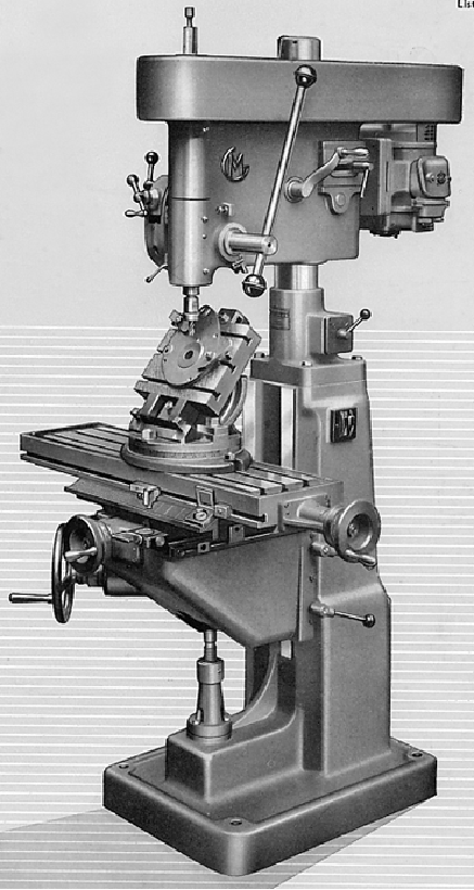

Matheys Jig Boring and Universal Milling Machine Model SP.30 as supplied for milling. The specification recommended included standard, non-hardened table feed screws, a infinitely variable-speed swash-plate drive unit fitted to the spindle drive motor (speed control was by a handwheel on the unit's left-hand side) a table power-feed gearbox bolted to the underside of the saddle's left-hand end and the maker's "Universal" swivel and tilting table. Lighting and coolant were also available, the cast-iron tank and its pump being mounted on the back of the column

Swivel and tilting universal table with a detachable table that could be either a flat-topped T-slotted or rotary type.
