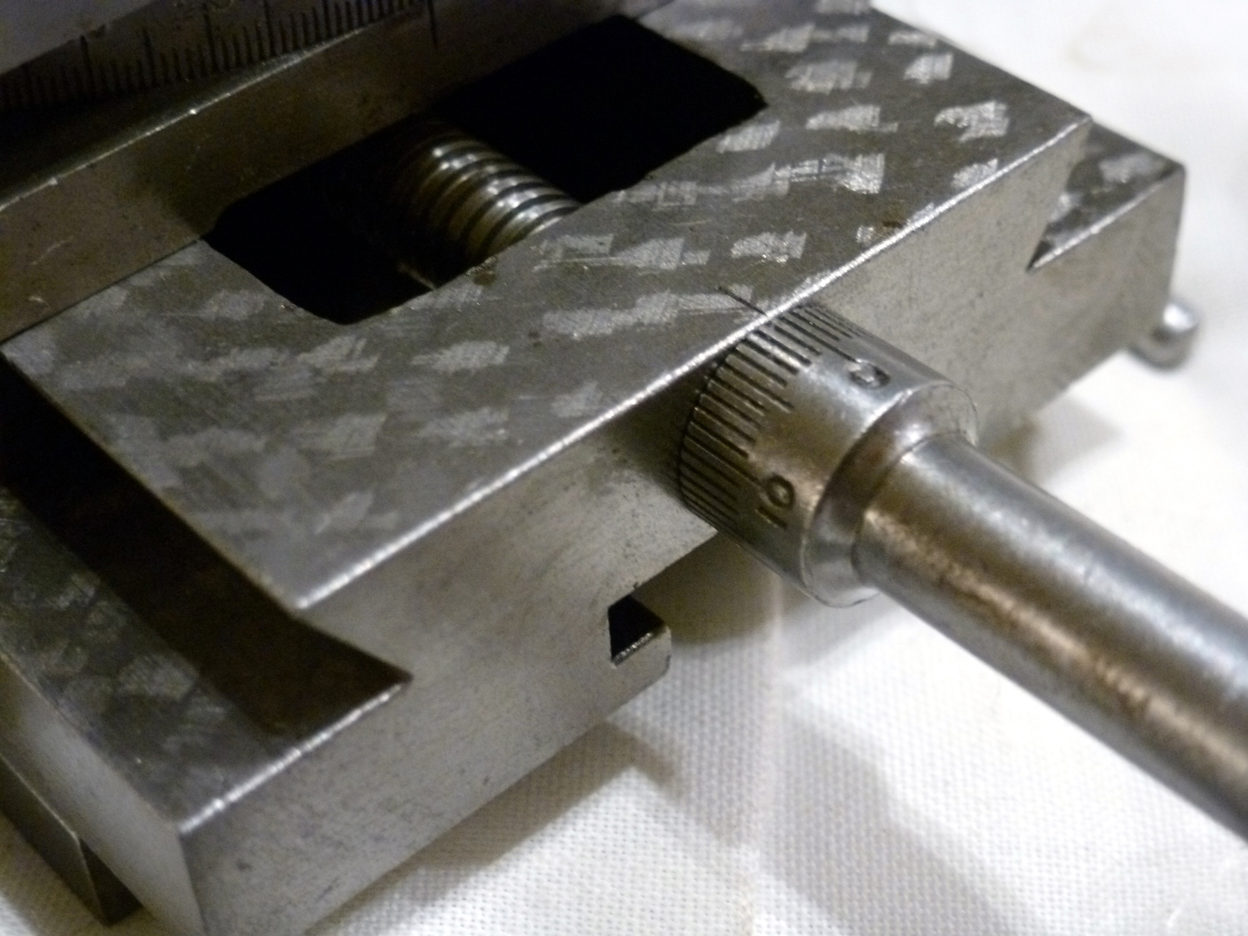

Compound slide rest assembly and 3-jaw chuck in place. Location at 90 degrees to the lathe's longitudinal axis was by a bock fixed to the underside of the slide that bore against the front bevelled face of the bed. Unfortunately, because the bed was so short, it was impossible to mount both the compound slide and tailstock with the 3-jaw chuck in place - and even with the chuck removed, it was still awkward to fit the compound and tailstock at the same time. Listed at $25 the slide-rest was an expensive item, today's equivalent price being around $625. However, it was well made, hand scraped on all its sliding surfaces and constructed as a proper job with the upper element able to be rotated through 360°. Swivel was locked by a single thumb screw and a finely engraved degree scale provided around the base. Driven by feedscrews ¼" diameter with a left-hand (ACME profile) 20 t.p.i thread, the cross slide had a travel of 2 ¾" and the top slide 2 ½". Unlike so many tiny lathes of its time, the Massachusetts was equipped with micrometer barrels, 3/8" diameter and engraved with marking from 0 to 50 (i.e. graduated in thou); however, these were fixed and could not be zeroed An unusual method was used to locate the feedscrews - the far end of each having a keyway with a keyed collar slipped on and end float adjusted by a screw, threaded into the end of the feedscrew and bearing against the collar; the keyway was tiny and the key just 3/64" x 1/32" Of standard 'American pattern", with the tool able to be rocked up or down a little on a curved support that bore on the inside of a dished washed, the toolpost took tiny, 5/32" square tools

Ting but still useable micrometer collar
