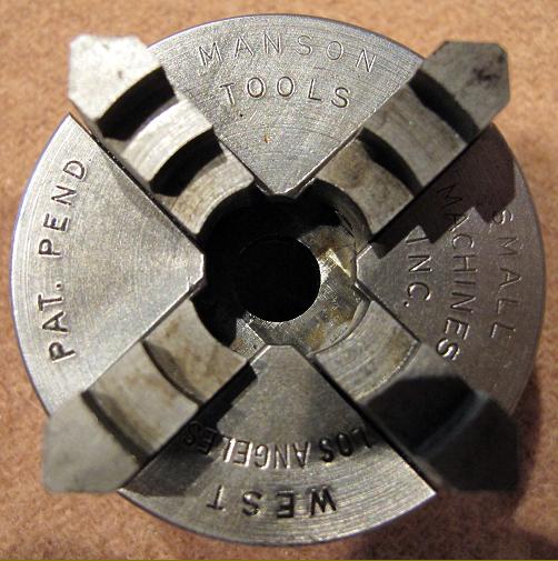

Packed first in a wooden box, with the inside milled to hold the various components, the original ManSon accessory kit was offered (in 1949) at $34.50. The wooden box was superseded, first, by a hardwood-lined, 6" x 4" plastic box and then a wood-lined metal case. Although it's impossible to be categorical as to what was included (the writer has received various testimonies concerning the contents and factory lists varied with some having pictures and others without) the first kit is known to have contained a steel-bodied 4-jaw independent chuck (stamped with the ManSon name and address), a collet-holding nose-piece to take the supplied four collets (in stress proof steel) of 1/32", 1/16", 3/32" and 1/8"; a 11/2" or 13/4"-diameter faceplate with eight tapped holes, a tailstock drill-chuck, two tailstock collets, one countersink centre drill, two lathe dogs (sizes 3/16" and 3/8"), two high-speed tool bits (ready sharpened and ground) and an Allen-wrench. The two centres, which appear in most collections, seem not to have a home in the kit and may have been supplied as part of the lathe's standard equipment; some are of identical length, others with one of the pair longer than the other. Similar kits, but with different ranges of accessories, were also produced. Depending on the date of manufacture, the 4-jaw chuck was also known to have been supplied in a larger size, with an aluminium body, but without any maker's identification.

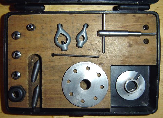

An almost original ManSon accessory kit, in a plastic case with wooden insert, consisting (in this case) of a four-jaw chuck and wrench, two drive dogs, faceplate, centre drill ( double-ended Slocomb), a miniature drill chuck and collet (with a taper to fit the tailstock), a screw-on headstock spindle-nose collet adapter with four collets, a lathe centre and a long Allen key.
Another ManSon plastic-case tool kit. This came with a 4-jaw chuck and wrench, faceplate, slotted catchplate, two centres, 1/8, 3/32, and 1/16 collets (the 1/32" is missing) collet nose piece, two drive dogs - the tailstock chuck (not shown) and two collets to fit it: one to accept 5/64" to 7/64" and the other from 3/64" to 5/64"

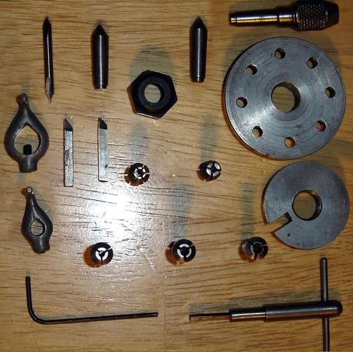

Left: full contents of the tool kit
Below: at the top tailstock collets and below those for the headstock
Another original kit with an unidentified item: in the foreground from the left item four (the first part is the oiler plug for the front headstock bearing)

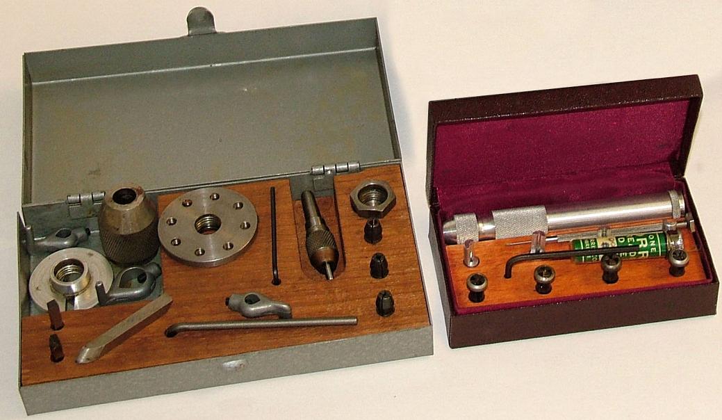

The final type of accessory set in its metal box
Metal box tool kit from a Master lathe together with, on the right, an original cardboard box holding the very rare threading accessories - the latter offered at $12.50 Although the label on wooden-boxed accessory kit reads "Manson Small Machines W. Los Angeles 25 Calif", the threading kit has been found labelled "Master Lathe Los Angeles 24"
