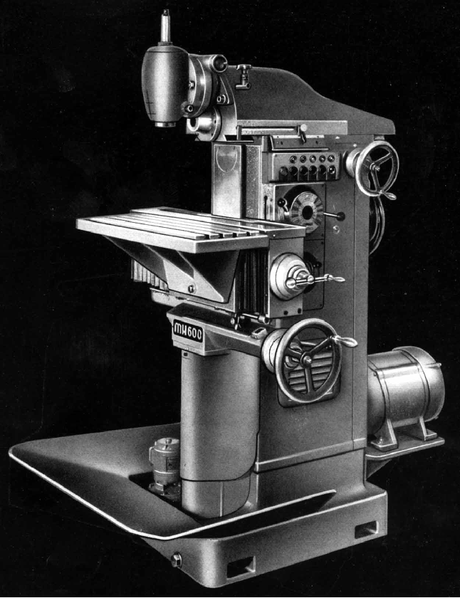

Early Maho 600 with exposed electric motor, a heavy-duty "Fixed Angular" horizontal table and the later type of standard vertical head with a domed front.

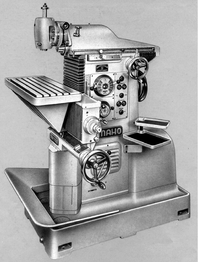

Earliest Maho 700 with the motor mounted inside the (ventilated) column base and a 'narrow-body' vertical head

Later Maho MH700 with external, covered motor and slideways protected by bellows.
Continued: The knee on both machines could be operated by hand, or under power from an infinitely-variable drive that gave rates of feed from 7 to 250 mm per minute. Longitudinal and vertical feeds on the MH600 were 320 and 300 mm respectively and on the MH700 400 and 370 mm. As an extra the M700 could be fitted with "rapids" - a mechanism that allowed the knee to be moved back to a start position (both longitudinally) and vertically at 900 mm per minute. For bolting to the knee three different tables were available: plain, tilting and compound tilting. The most rigid, and best suited to heavy stock removal, was the plain type ("Fixed Angular" in the maker's terminology) of 600 mm x 210 mm with 4 T-slots on the MH600 and 700 mm x 295 mm with 5 T-slots on the MH700 (the dimensions all refer to the clamping area, not the overall size). The T-slots were of identical size (12-mm wide) and spacing (45-mm apart) on each model. More versatile than the fixed table (but less rigid) was the "Swivelling and Tilting Angular Table", a model that provided a good compromise between versatility and stiffness. The unit could be tilted 45-degrees either side of horizontal, swivelled 30 degrees on its vertical axis and had the bonus of a transverse feed (by screw) with 130 mm of movement. The table was sized to each model: 610 mm x 220 mm with 4 T-slots for the MH600 and 700 mm x 295 mm with 5 T slots on the MH700. The table that allowed the greatest functionality, but at the expense of being restricted to lighter cuts, was the "Swivelling Tilting and Inclinable" model. As its name suggested this could be moved in a manner identical to the Swivelling and Tilting table but also arranged to tilt in a fore and aft direction through 30-degrees either side of horizontal; however, its versatility was bought at the expense of having to leave off the transverse feed. Fitted with this table (and in combination with a suitable dividing attachment and vertical head) the miller was able to tackle an extensive range of complex machining. A Punch Milling Attachment was also listed - designed to allow the production of intricate shapes on milling cutters and punches - consisting of a chuck mounted on a finely-adjustable slide (itself carried by one of the dividing heads), a graduated glass plate with magnifying lens, a radius gauge, vernier callipers, a "Tesatest" gauge (reading to 0.01 mm), and a centering needle and centering feeler. The Spiral Milling Attachment, with its No. 4 Morse taper spindle driven by changewheels from a gear on the table-feed mechanism, was supplied complete with a tailstock, knee and set of changewheels that enabled it to be adapted for the manufacture of spirally-fluted milling cutters and reamers and also for the production of helical and worm gears and threads (under power) from 3 mm to 2000 mm pitch. With just hand feed the unit was limited to the spiral pitches from 3 to 16 mm. A single maker's Rotary Table was available: 340-mm in diameter it carried a No. 4 Morse taper hole in its centre and could be used for direct or indirect dividing. For the former a ring of 24 holes were provided and for the latter 3 indexing plates supplied as standard. Both the MH600 and MH700 stood just less than 1500-mm tall with a base casting slightly less than 600-mm wide. However, whilst base on the 600 (less the chip tray), was only 720 mm front to back on the 700 it was considerably deeper at 1164 mm. Although compact the millers were very heavily built: with motor and standard equipment the gross weight of the MH600 was 955 kg and the MH700 1265 kg..

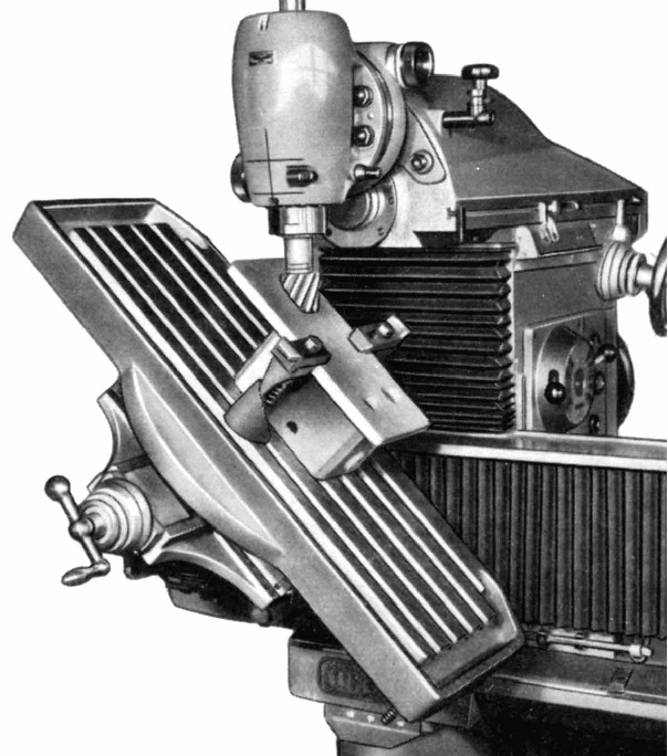

"Swivelling and Tilting Angular Table" fitted to the Model 700 - a good compromise between versatility and stiffness. The unit tilted 45-degrees either side of horizontal, swivelled 30 degrees on its vertical axis and had a 130-mm of transverse movement by a screw feed. *Proof of the type's success - the genus Precision Universal Milling Machine - is evident from the number of similar machines made in various countries including: Austria: Emco Model F3 Belgium: S.A.B.C.A. Model JRC-2 Czechoslovakia: TOS FN Models England: Alexander "Master Toolmaker" and the Ajax "00", an import of uncertain origin. Germany: Hahn & Kolb with their pre-WW2 Variomat model Wilhelm Grupp Universal- Fräsmaschine Type UF 20 N/120 Hermle Models UWF-700 and UWF-700-PH Leinen Super Precision Micro Mill Macmon Models M-100 & M-200 (though these were actually manufactured by Prvomajska); Maho (many models over several decades) Ruhla Rumag Models RW-416 and RW-416-VG SHW (Schwabische Huttenwerke) Models UF1, UF2 and UF3 Thiel Models 58, 158 and 159 Wemas Type WMS Italy: C.B.Ferrari Models M1R & M2R Bandini Model FA-1/CB and badged as Fragola (agents, who also sold a version of the Spanish Meteba). Japan: Riken Models RTM2 and RTM3 Poland: "Avia" and "Polamco" Models FNC25, FND-25 and FND-32 by Fabryka Obrabiarek Precyzyinych Russia: "Stankoimport 676" Spain: Metba Models MB-0, MB-1, MB-2, MB-3 and MB-4 Switzerland: Aciera Models F1, F2, F3, F4 and F5 Christen and Perrin Types U-O and U-1 (Perrin Frères SA, Moutier) Hispano-Suiza S.A. Model HSS-143 Luthy Mikron Models WF2/3S, WF3S, WF-3-DCM & WF-2/3-DCM Perrin Type U-1 Schaublin Model 13 and Model 22 The former Yugoslavia: Prvomajska (in Zagreb with Models ALG-100 and ALG200) Sinn Models MS2D & MS4D "Comet" Model X8130, imported to the UK in the 1970s by TI Comet. Sloane & Chace in the USA produced a miniature bench version and at least five Chinese-built models have also been made, including one from the Beijing Instrument Machine Tool Works. A number of the "clones" merely followed the general Thiel/Maho/Deckel concept whilst others, like Bandini and Christen, borrowed heavily from Deckel and even had parts that were interchangeable. Should you come across any of these makes and models all will provide "The Deckel Experience" - though you must bear in mind that spares are unlikely to be available and, being complex, finely-made mechanisms, they can be difficult and expensive to repair..
