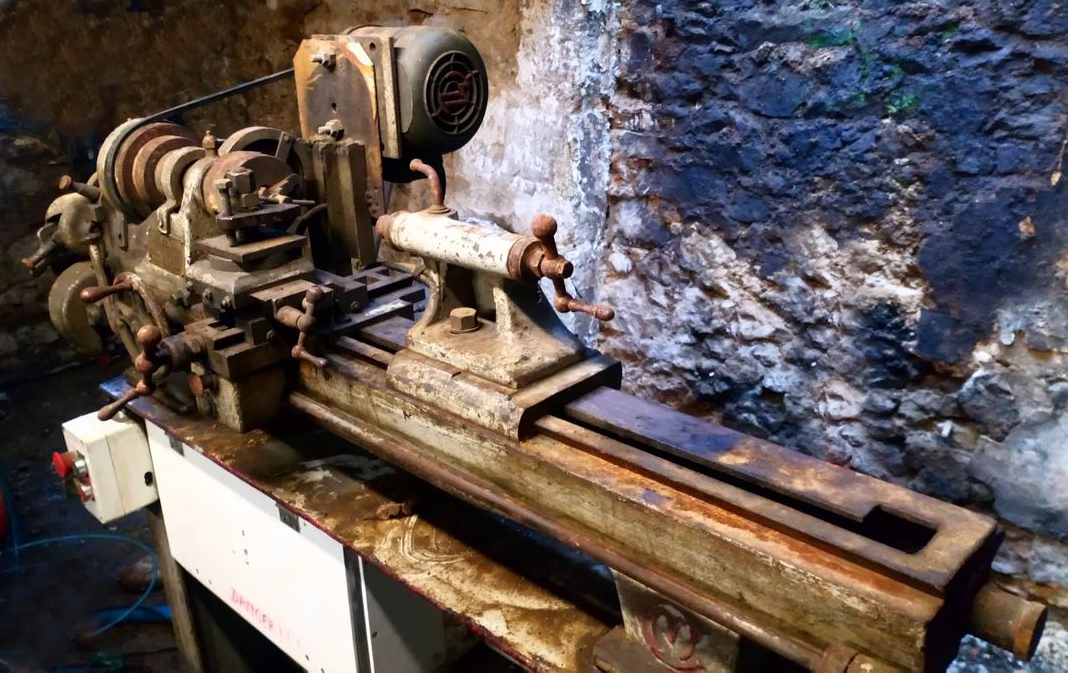

A known French maker - who produced their own range of made-in-house lathes as well as marketing those from other manufacturers - Louis Besse were based in Paris. The first lathe shown below - though sadly neglected - is a most interesting machine with a number of possibly unique features. Of around 160 mm centre height and perhaps 1000 mm between centres, it was of a type intended for production work, a powershaft replacing the more normal screwcutting leadscrew. The feed gearbox was arranged in an unusual manner being mounted - as on the early Hardinge TL "Split-bed" and later HLV and H:LV-H lathes, outboard to the left of the headstock. Of the Hendey Norton quick-change type, the box was driven through a tumble-reverse mechanism and retained the original English Whitworth arrangement of the tumbler working in a slot that rose from low on the left to high on the right.
Using what appears to have been a "two-height", V-way edged bed, the carriage seems to have been guided by the inner raised section and the tailstock on the outer - though this cannot be confirmed. The lathe appears to have been supplied with an integral countershaft unit, this being mounted on a slideway to the rear of the headstock and moved in and out for changes of speed by a large handwheel set immediately below the front headstock bearing. Amongst other example, a similar system was used on the French Descours & Cabaud and English Myford 4-inch Precision lathes.
