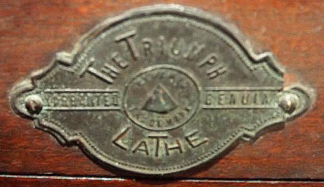

Lorch Triumph stamp on a slide-rest circa 1905
