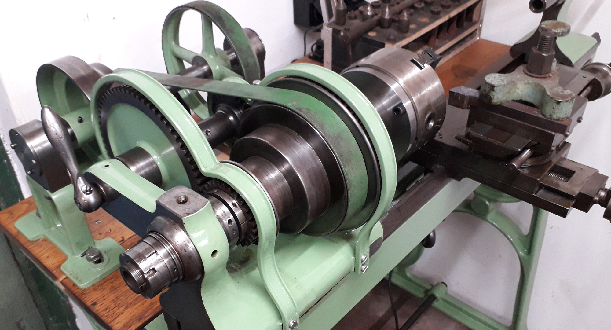

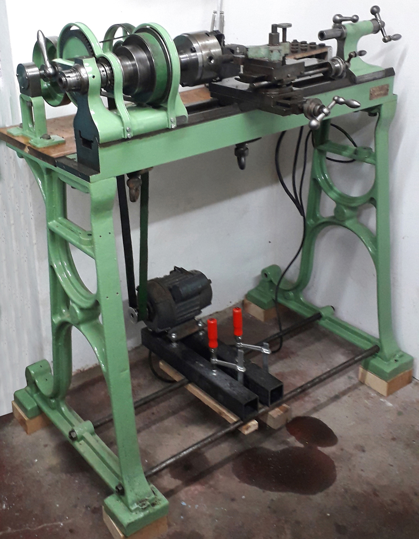

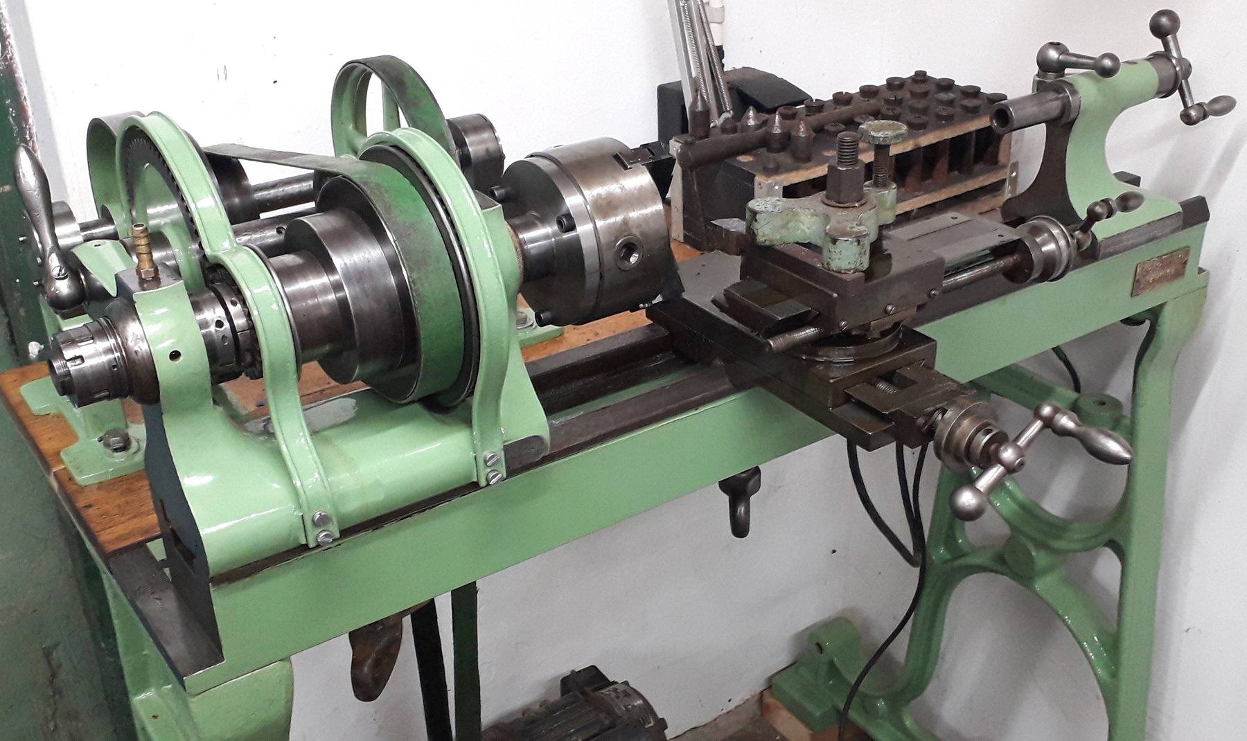

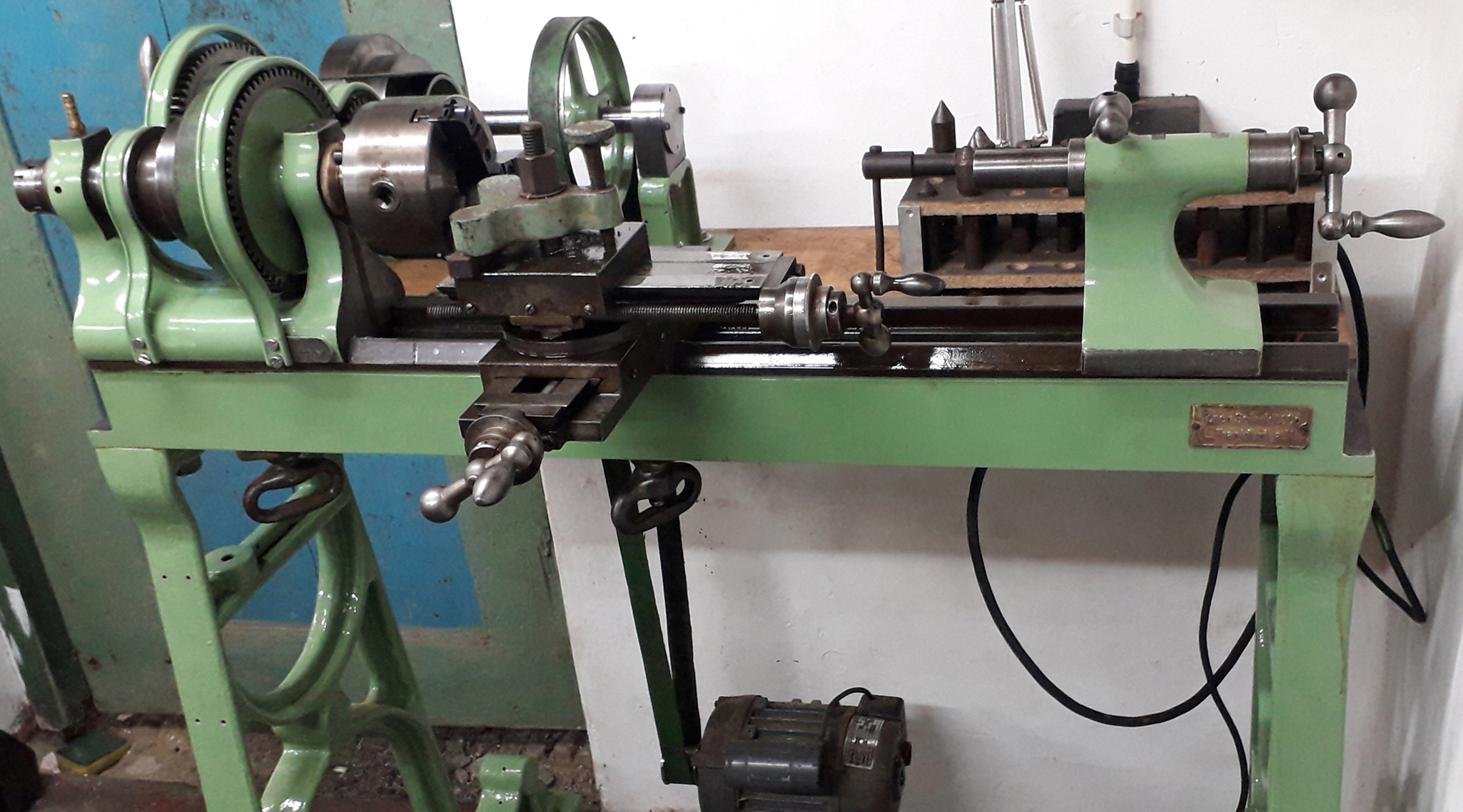

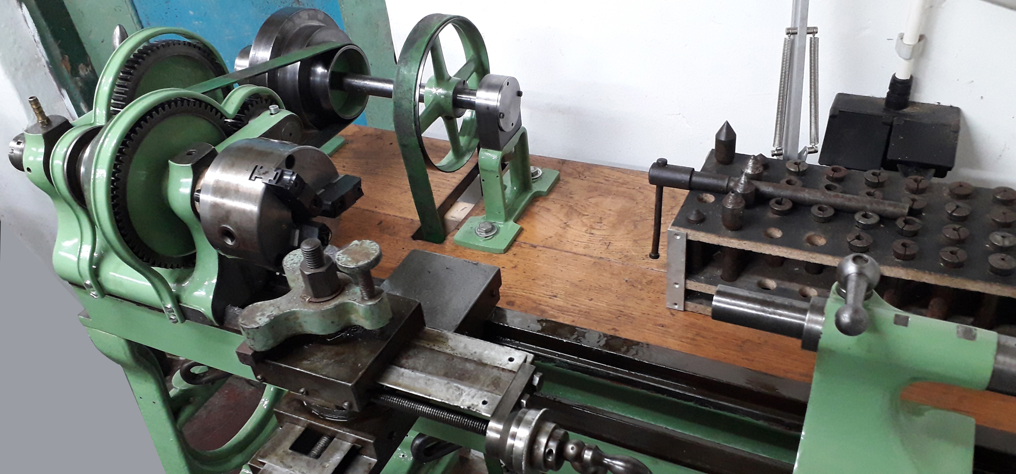

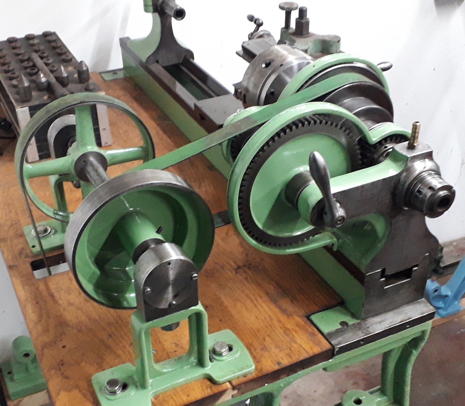

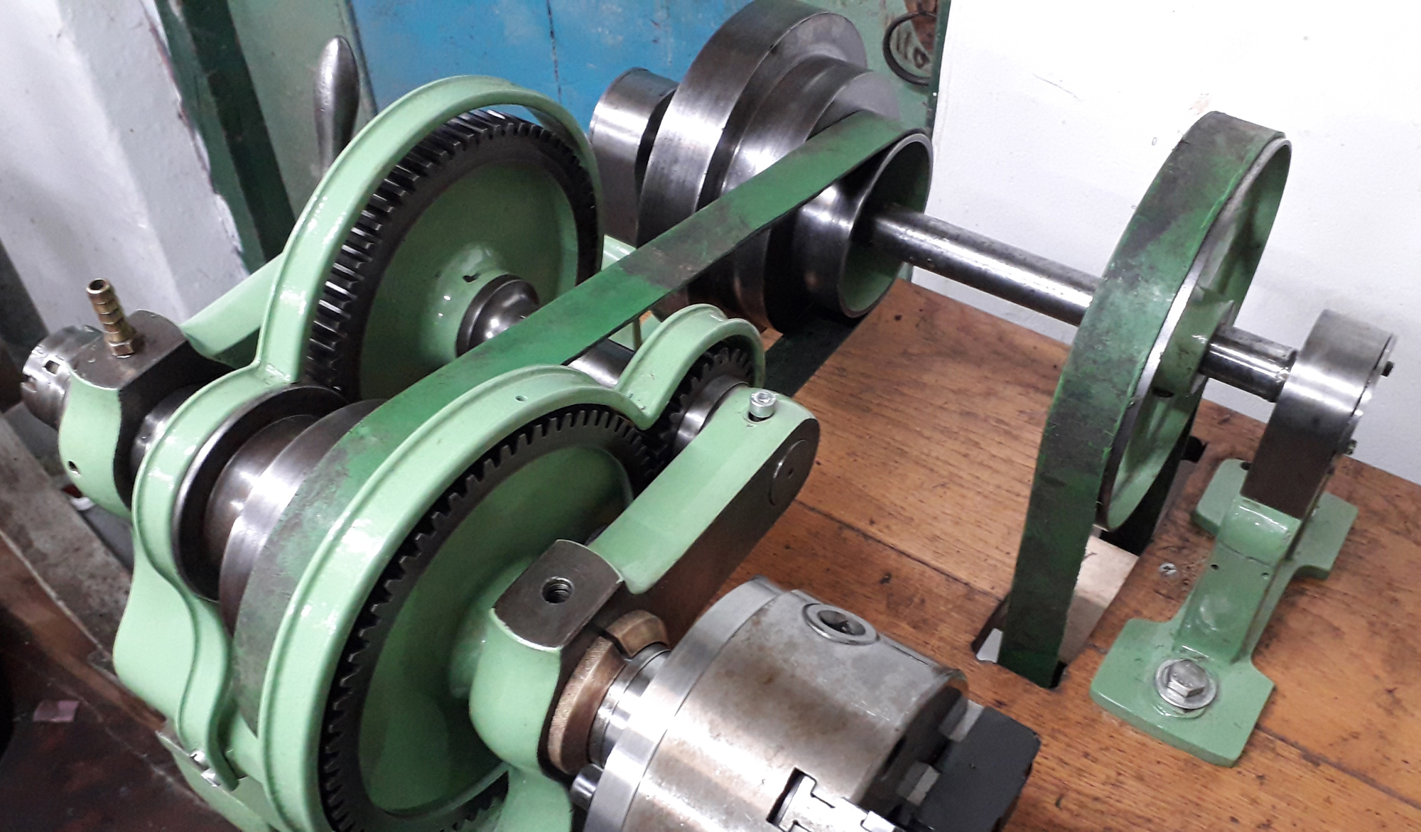

Identical to the unrestored Lorch Schmidt precision plain tuning lathe shown here in the Netherlands, this example has been but back into full working order by its owner, Gerrit van der Meulen. Note the exceptionally well-built countershaft unit with its spindle running in ball races and obviously intended for an extended service life with minimal servicing needs.

Like many lathes of its era the front face of the headstock bull wheel was drilled with a ring of holes for dividing purposes but, unusually, both headstock back gears were guarded - in this case with unusually narrow, intricately-cast cast-iron guards.
