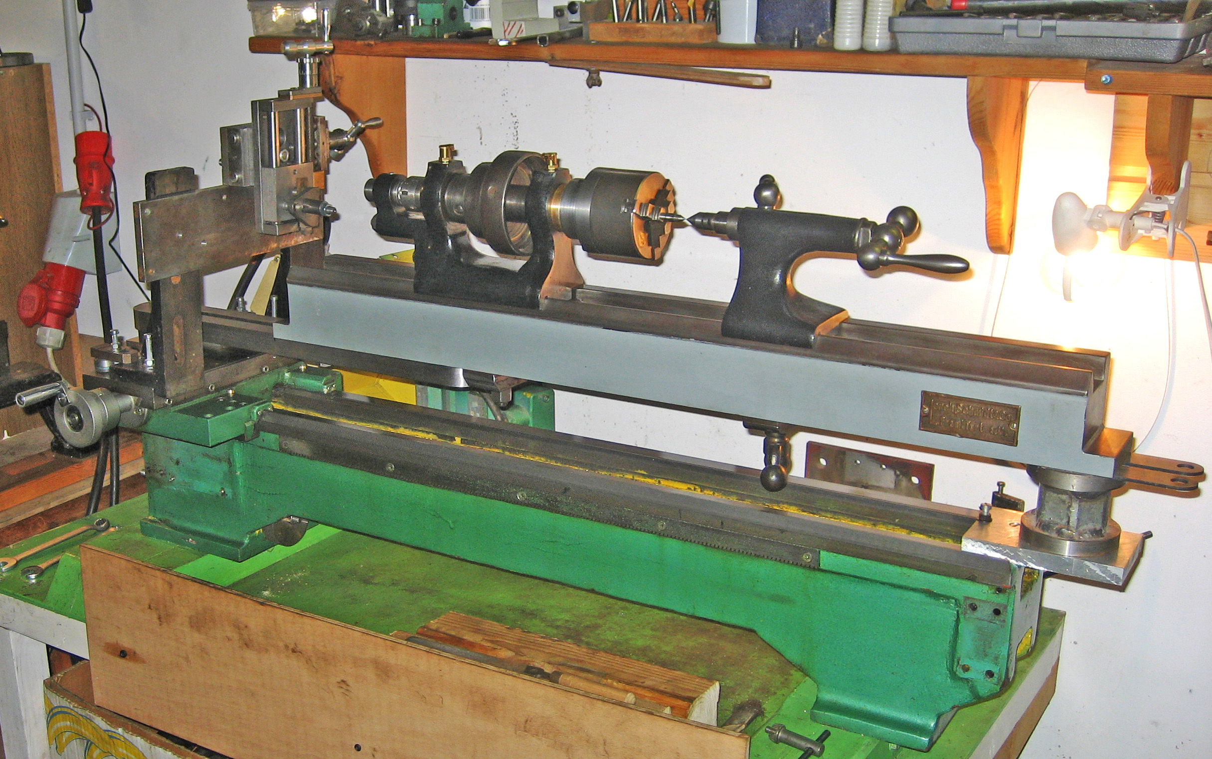

"About a month ago I bought an old Lorch Model AV precision plain-turning plain lathe with its typical "stepped bed" 800 mm long bed and with a centre height of 80 mm. The lathe was in very poor condition and I wanted to bring it back into good working order.
One serious problem was that a previous owner had made two cut-outs into the bed to give extra clearance for a large faceplate - and the work looked as though it had been done with a hammer, chisel, and brute force. In addition to enduring 90 years of wear on the slides, the essential alignment between the headstock and tailstock had deteriorated. Unfortunately, there was no feasible way to readjust the tailstock, it's a one-piece casting and would originally have been a perfect fit on the bed (this is an issue is likely to be recognized by many owners of older Lorch lathes).

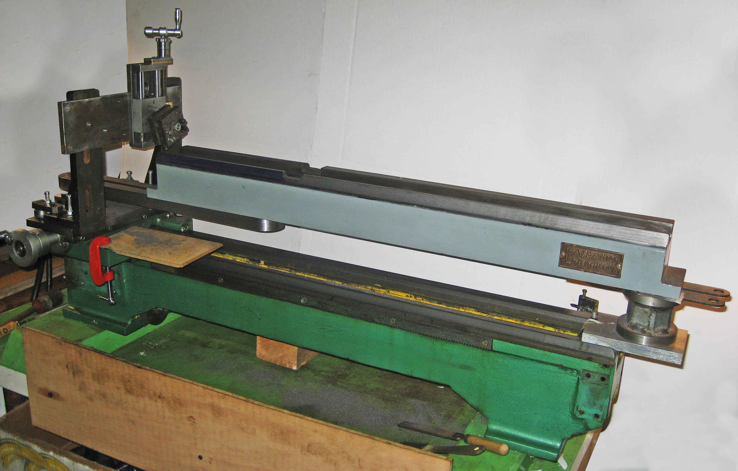

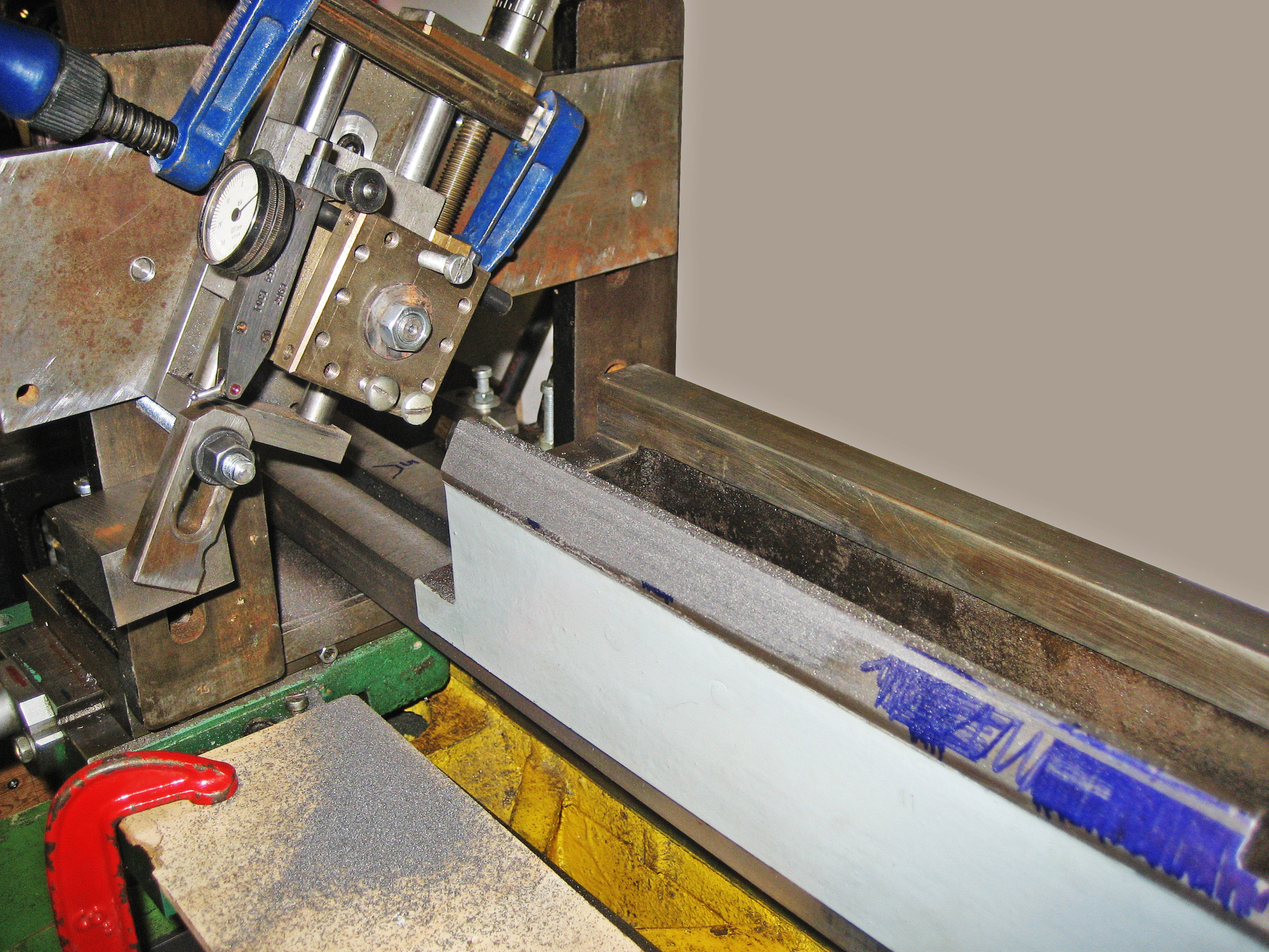

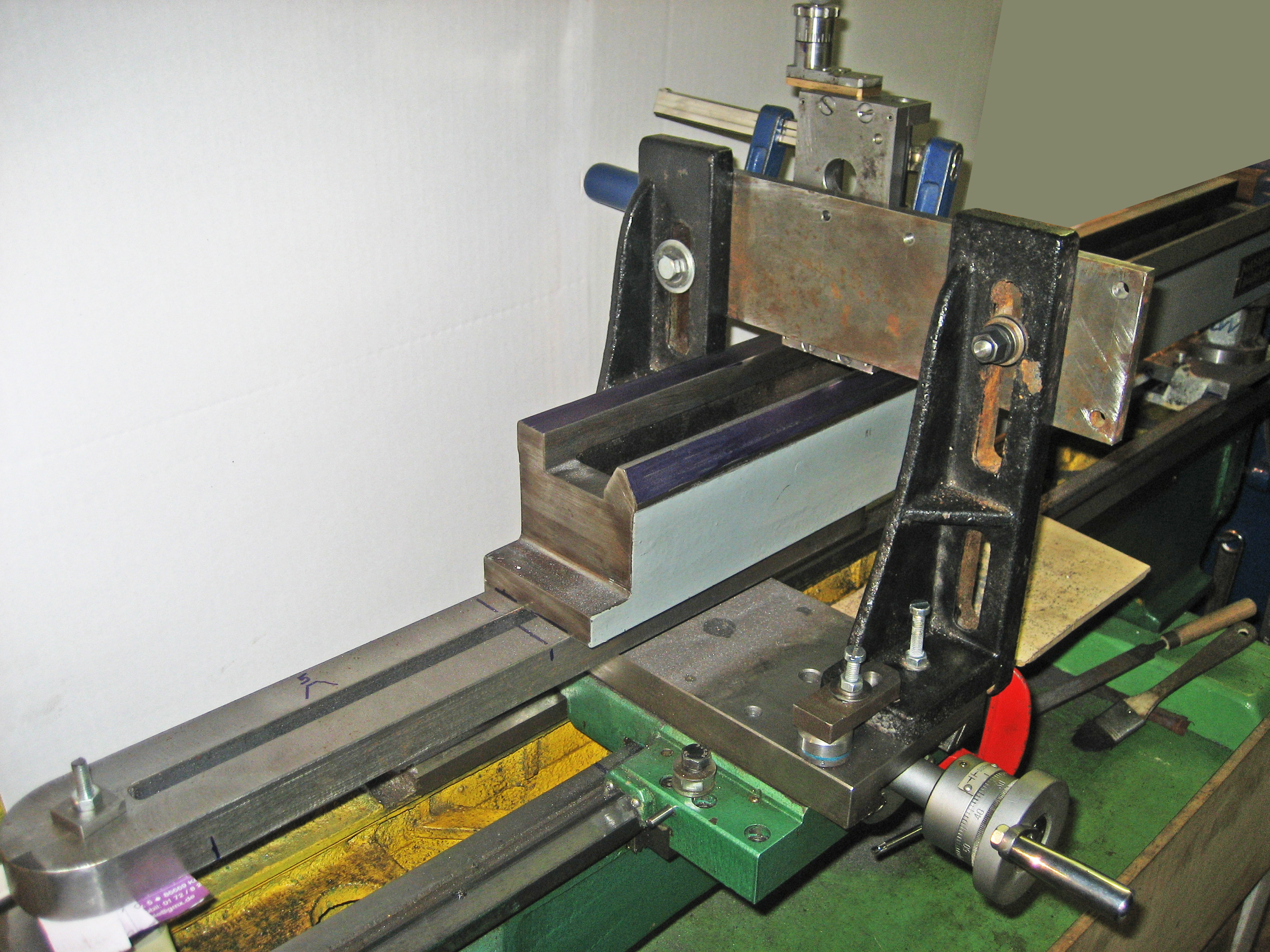

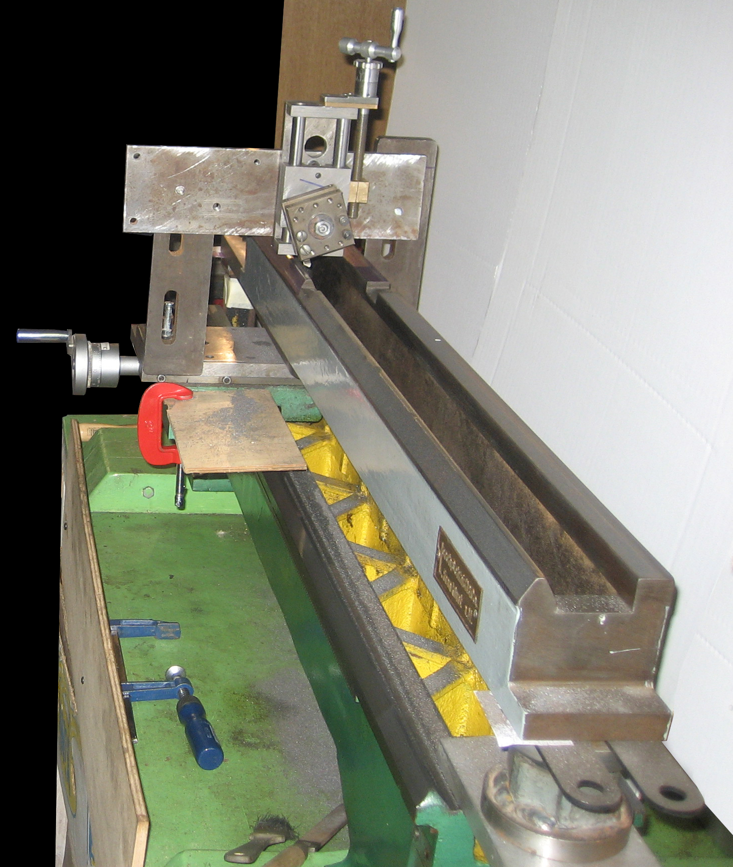

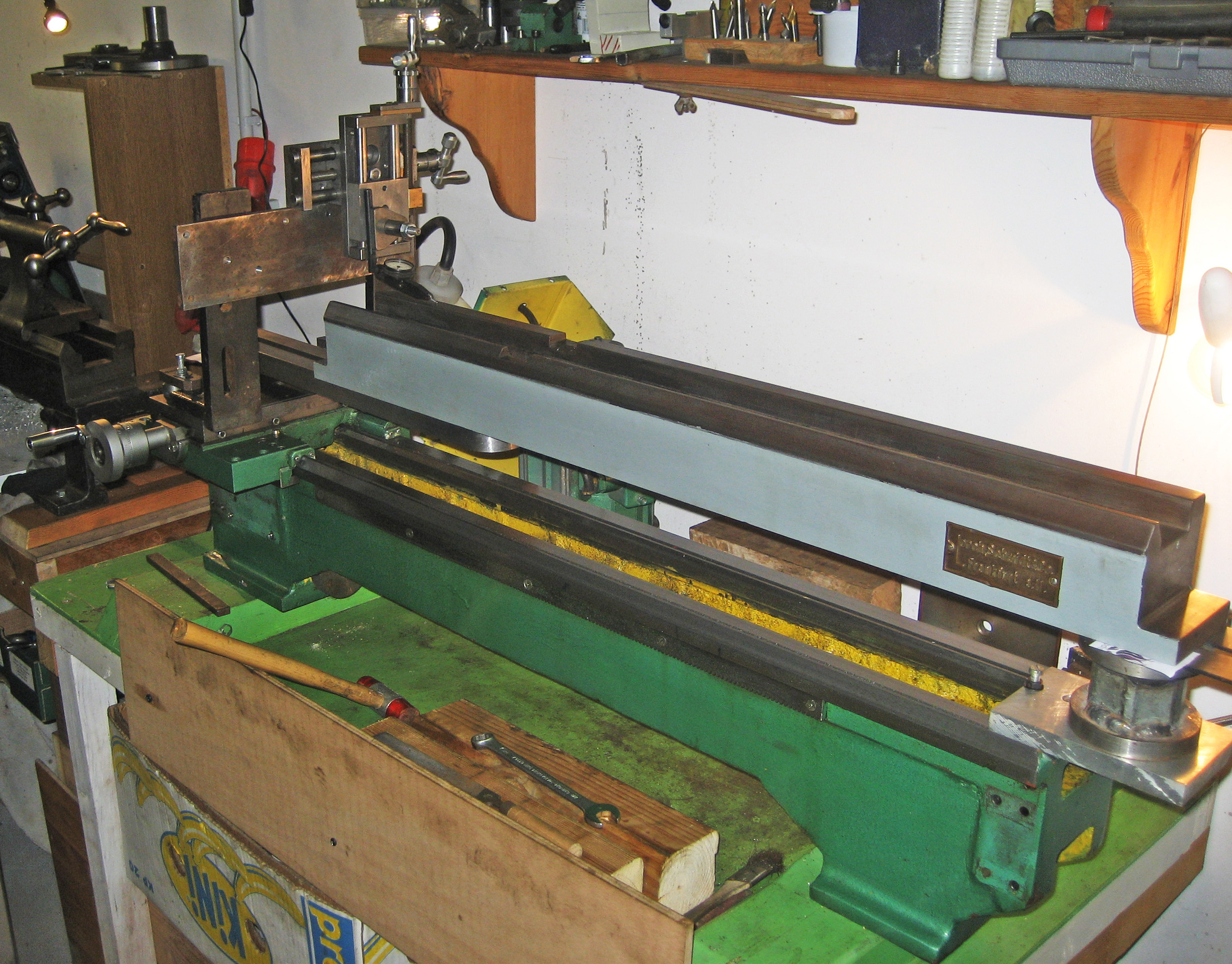

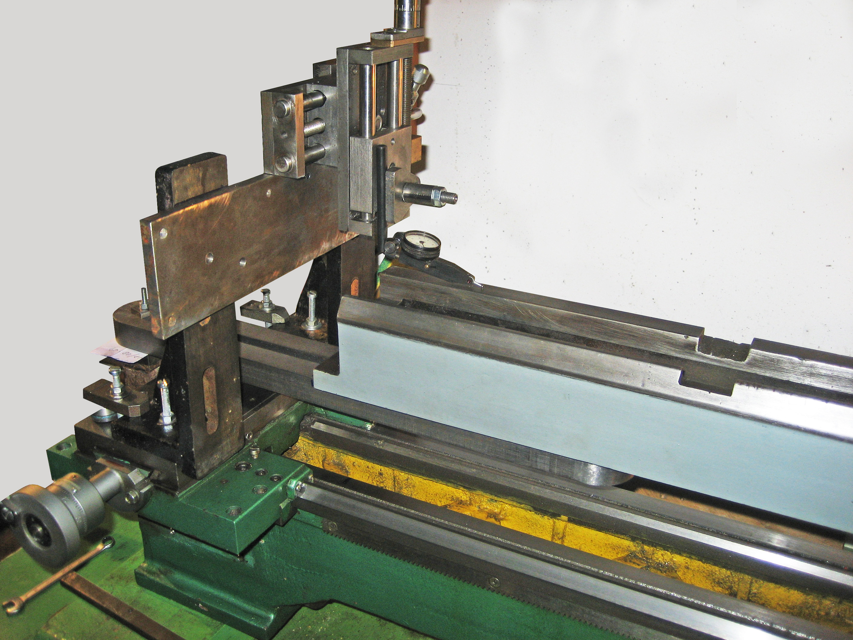

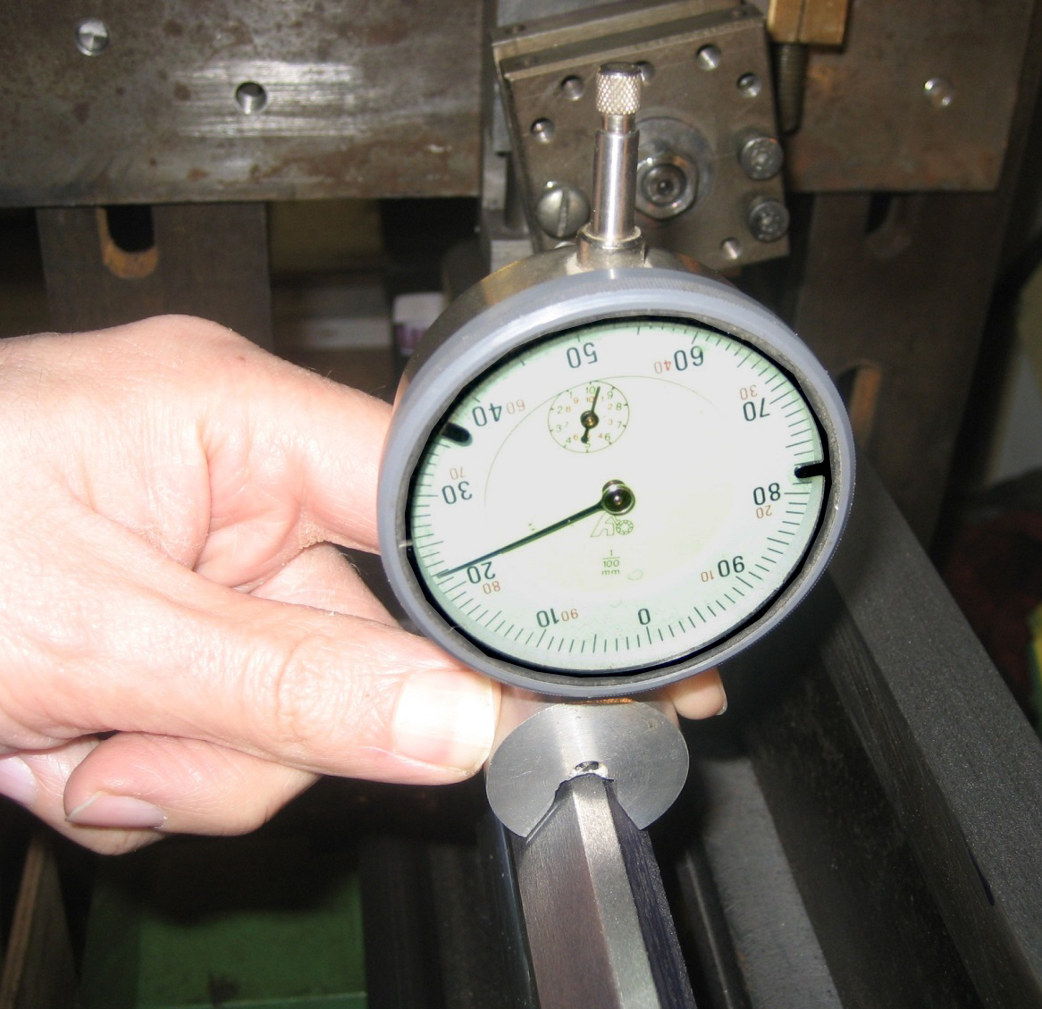

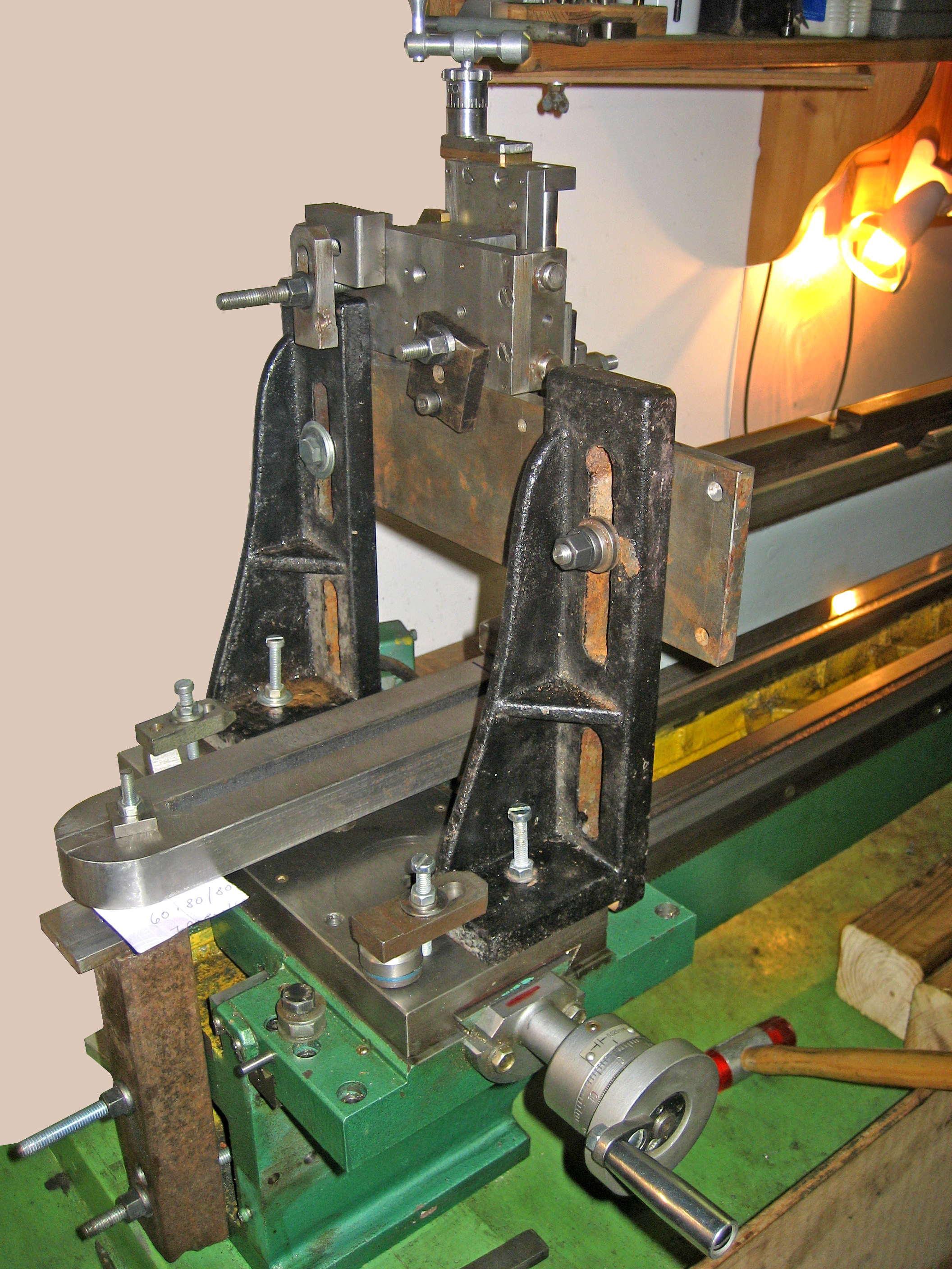

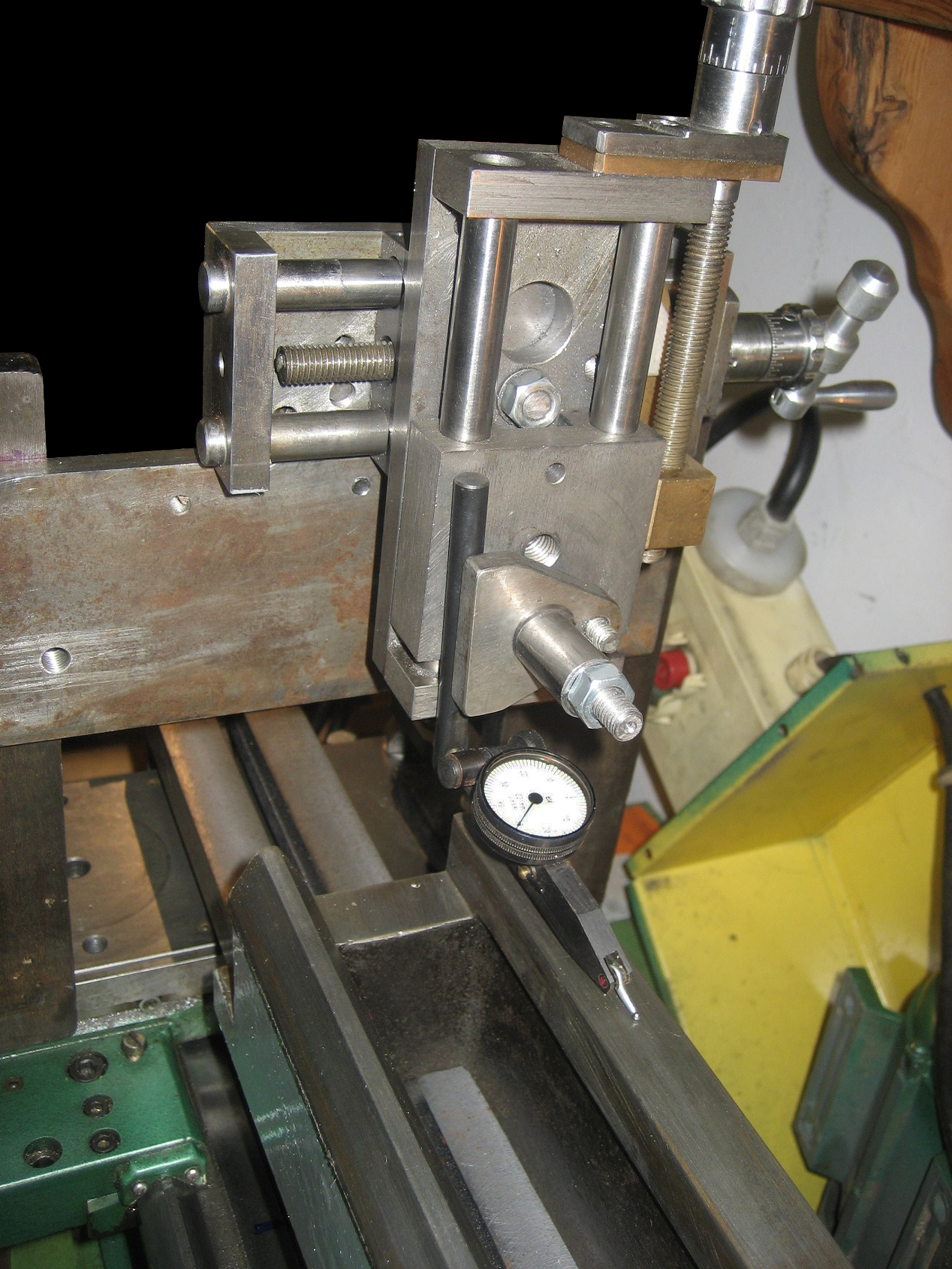

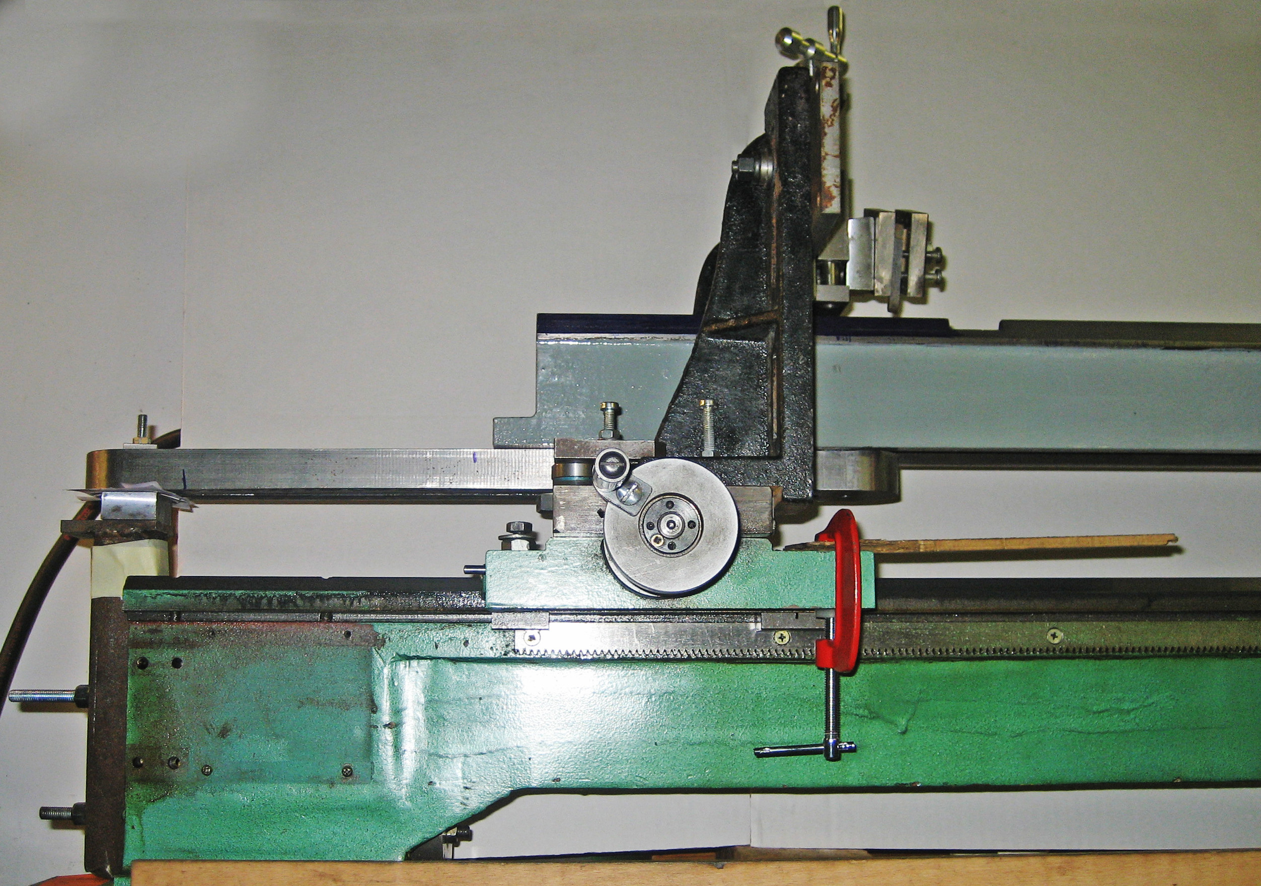

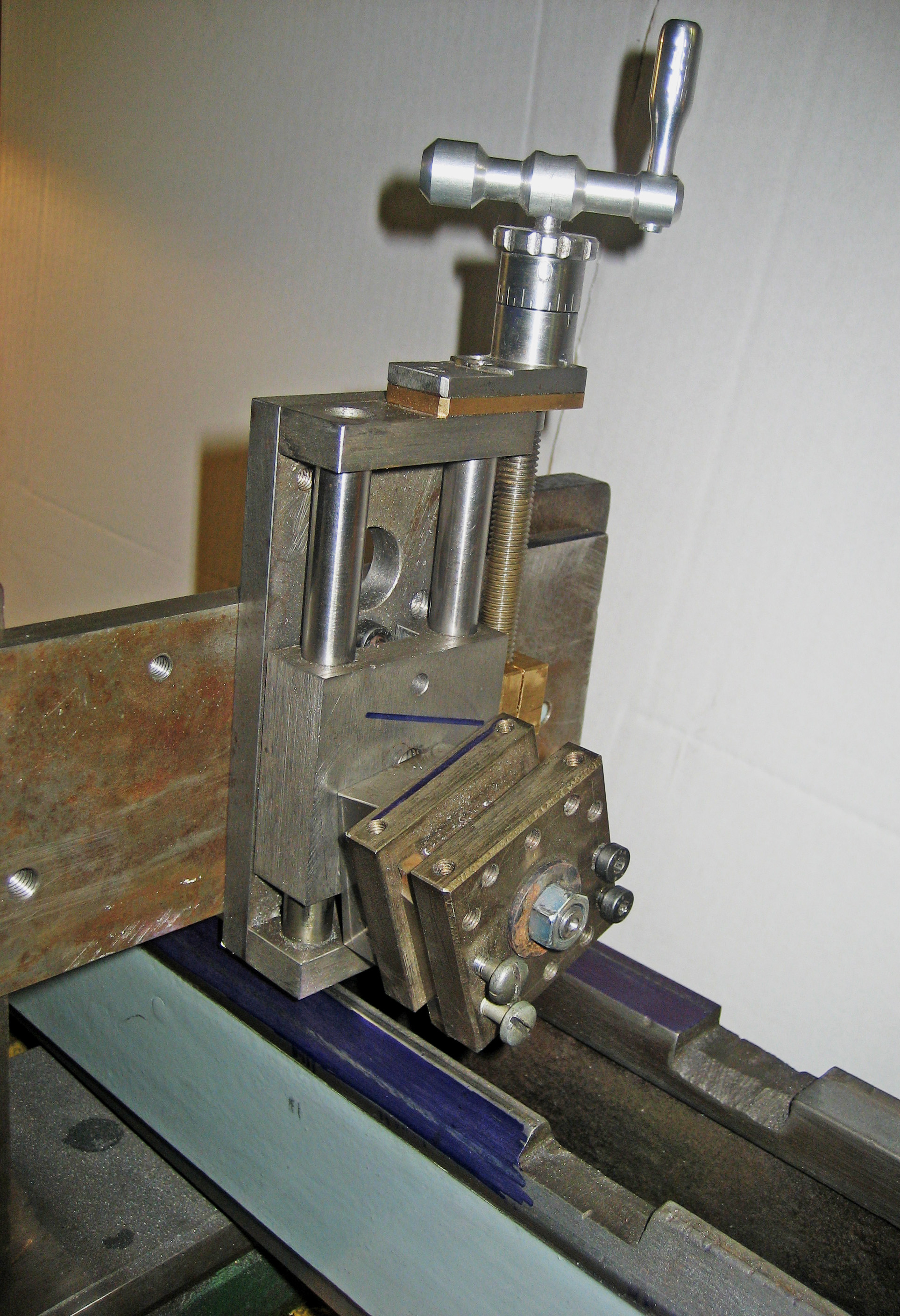

In my situation, the first step was to rework the lathe bed, but I was determined not to spend a significant amount of money on a professional job. My inspiration to tackle this task came from an online essay detailing the techniques employed by the English machinist and model engineer, Johnny Pickles - a man who applied innovative methods to his self-made machine tools. With his ideas in mind, I disassembled the Chinese lathe to leave just a clean bed with only the saddle remaining on top. This now formed the basics of a planing machine with the next step being the construction of a gantry to hold a slide rest and the cutting tool. Two temporary fixtures were built with their alignment meticulously executed using a dial indicator, paper shims - and a substantial amount of patience.
The next hurdle to overcome was how to hold the Lorch bed in place and achieve a sufficiently long cutting stroke - there was no room for even a millimetre of waste. Consequently, as a starting point, the unworn surfaces near the headstock area of the Lorch bed were utilized to adjust my planer and rectify the inclination of both bevels. I determined the proper level for the horizontal faces by utilizing a measuring fixture that had been calibrated beforehand. Having set everything up, the next labour-intensive and time-consuming task involved manually pushing the slide along the lathe bed repeatedly. The outcome of this considerable endeavour rendered all the work worthwhile as, finally, the Lorch bed was perfectly smooth and accurate.
I hope that the photographs below will show how the whole assembly was constructed and how it worked.

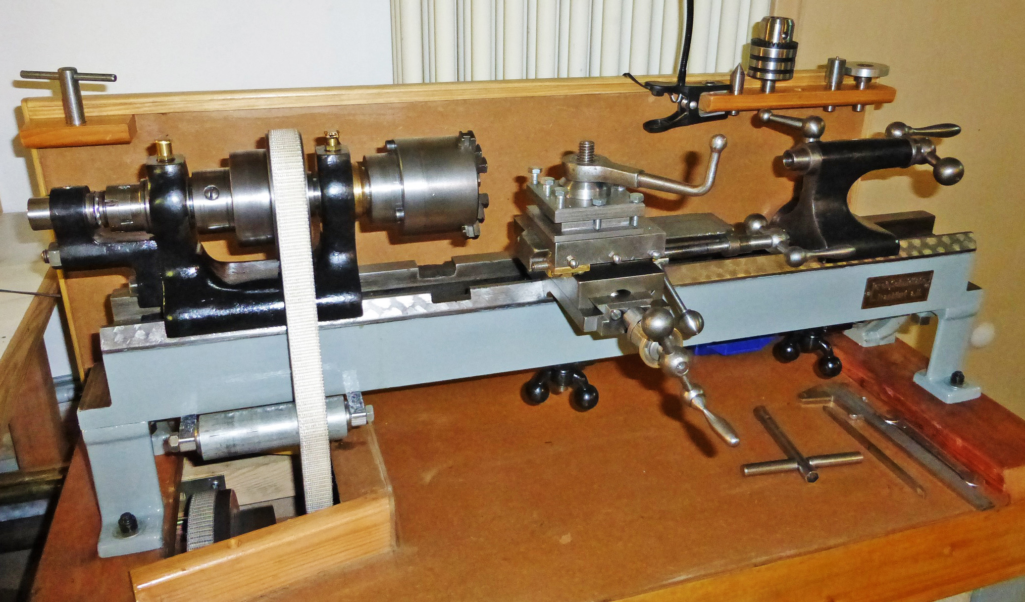

In addition to working on the lathe, I've built a cabinet featuring an underdrive system hidden neatly away. Now, just a few minor tasks remain before I can start using my born-to-live-again Lorch."

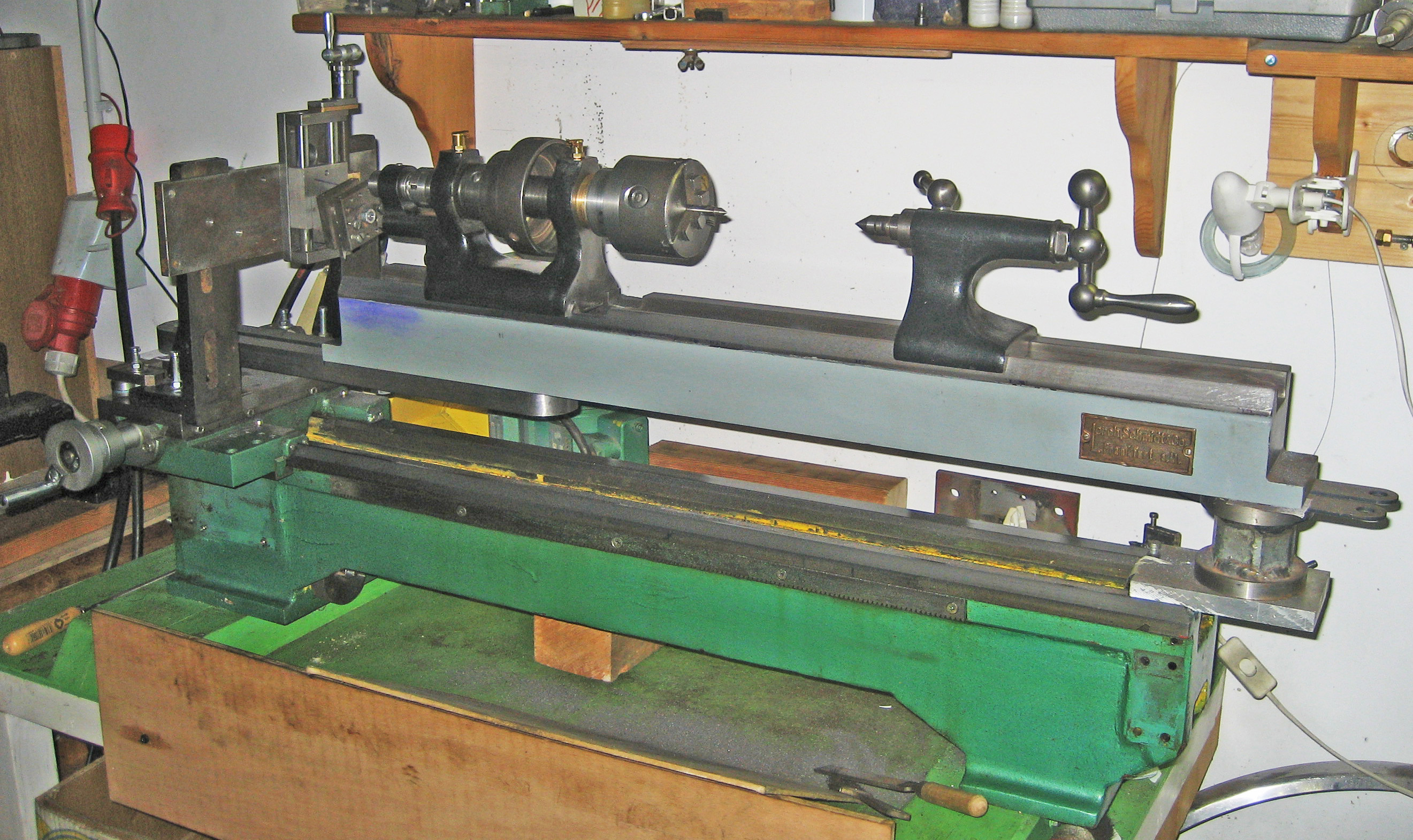

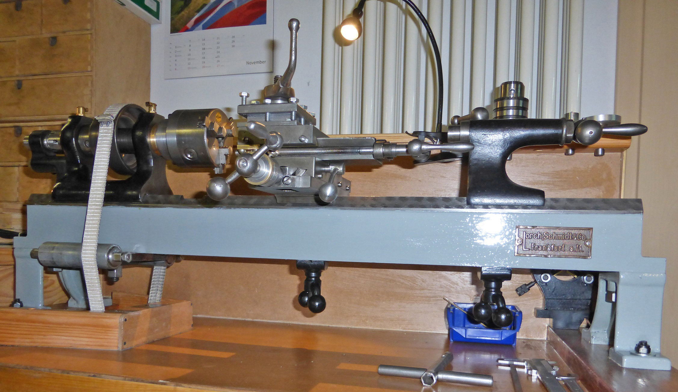

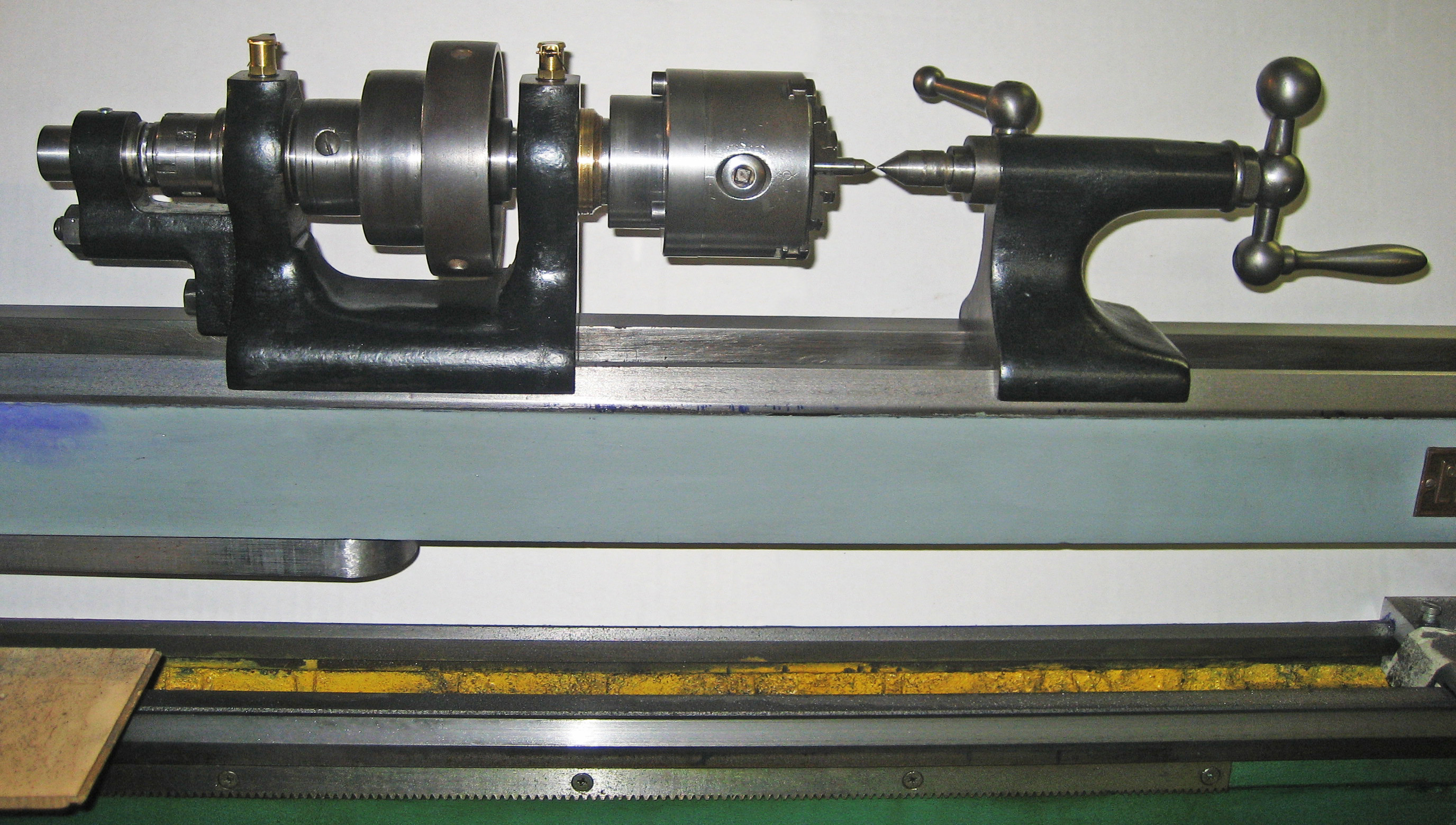

The early Lorch on its new underdrive stand. Now fully rebuilt and ready to use.
Headstock and tailstock now line up exactly
