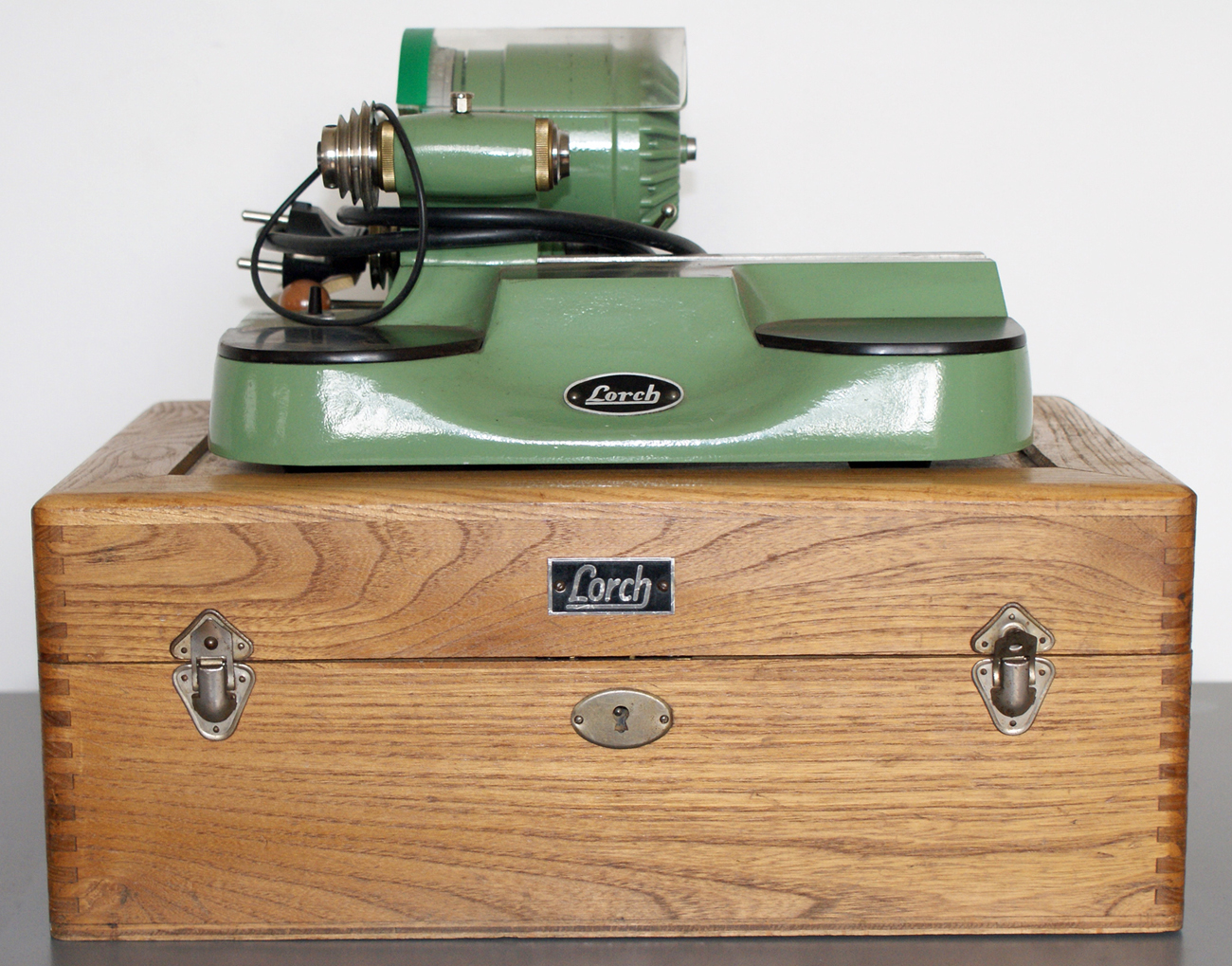

Manufactured in the 1950s - and embracing the contemporary trend to mount watchmaker's lathes on self-contained, motorised bases - the little Lorch Junior was a thoroughly well-specified and equipped lathe. While the arrangement of bed and headstock might have been a little unusual (the headstock reminds the writer of that on the post-WW2 Rivett) - the rest of the lathe was entirely conventional - though it did include the facility for "Hand graving" - a method first suggested in a sales brochure by Lorch - where a finely-finished and very smooth steel plate in front of the spindle nose provides a surface on which a small toolholder, with a flat base, can be manipulated. In addition, the facility was provided to mount a grinding wheel on the end of the motor spindle so that, with a support table fitted into a hole bored in the casting, tools could be sharpened when held in the toolholder.
Sold complete with a fitted wooden box holding the buyer's choice of accessories, items could include: wire, ring step, step and wax collets, a superb compound slide-rest assembly, two tailstock (one lever action, one with a simple "push" spindle), pump-centre faceplate, precision 3-jaw ring-scroll chuck, carrier chuck, roller filing rest, sinking tools, lantern chucks, Jacot drums, flip-up tool rest with two sizes of T, and a self-centring drilling attachment and plates, etc.
