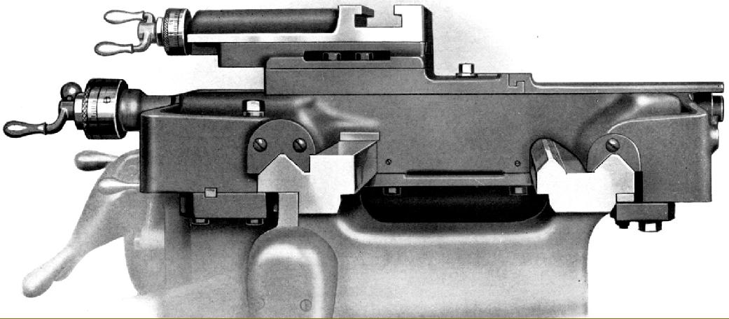

Continued: A steady improvement in the quality of cutting tools during the early decades of the 20th century saw a significant increase in the ability to remove material in one pass and lathe manufactures responded by building increasingly rigid and massive machines that were able to take full advantage of the new tools. Lodge & Shipley's machines were a good example of this process with their post WW1 lathes being not only much more heavily built than the pre-war flat-belt drive type but with the option of powerful, all-geared headstocks and integral motor-drive systems - such self-contained models needed no access to overhead line-shaft drives and allowed a Work's Manager the opportunity to shift the machines around the factory floor in order to maximise productivity and profits on long-run jobs. As part of the drive for increased work-rate and better surface finishes the bed of Lodge & Shipley lathes was modified in the early 1920s to include two extra ways that the makers described as "supplementary bearings". The first 'way' was created on the horizontal surface (also used by the tailstock) between the inside edge of the front V and the gap between the front and rear Vs; the second 'way' was directly in line with tool thrust and formed on the inner vertical surface between the front and back Vees (as illustrated below). This arrangement meant that the carriage was precisely guided on very long V ways (a process that also tended to even out wear) yet with a substantial proportion of the tool thrust absorbed against a vertical rather than inclined surface. This improved bed-to-saddle arrangement was to become a feature of all Lodge & Shipley lathes until the 1960s and, far from being left alone, was steadily developed until the height of the inner flat eventually rose to equal that of the top of the front V. The arrangement called, of course, for very precise machining to ensure that the bed-to-saddle fit was absolutely precise for, unlike other makers, Lodge & Shipley could not simply drop the saddle onto the Vees of the bed and fit keeper plates at front and back - to work properly all saddle-to-bed surfaces had to be correct relative to each other - which is probably why no other manufacturer (known to the writer) copied the idea. Continued below:
Lodge & Shipley bed and saddle arrangement showing the "supplementary bearings" - extra horizontal and vertical ways formed just inboard of the front bed V-way and also used to guide the tailstock.
