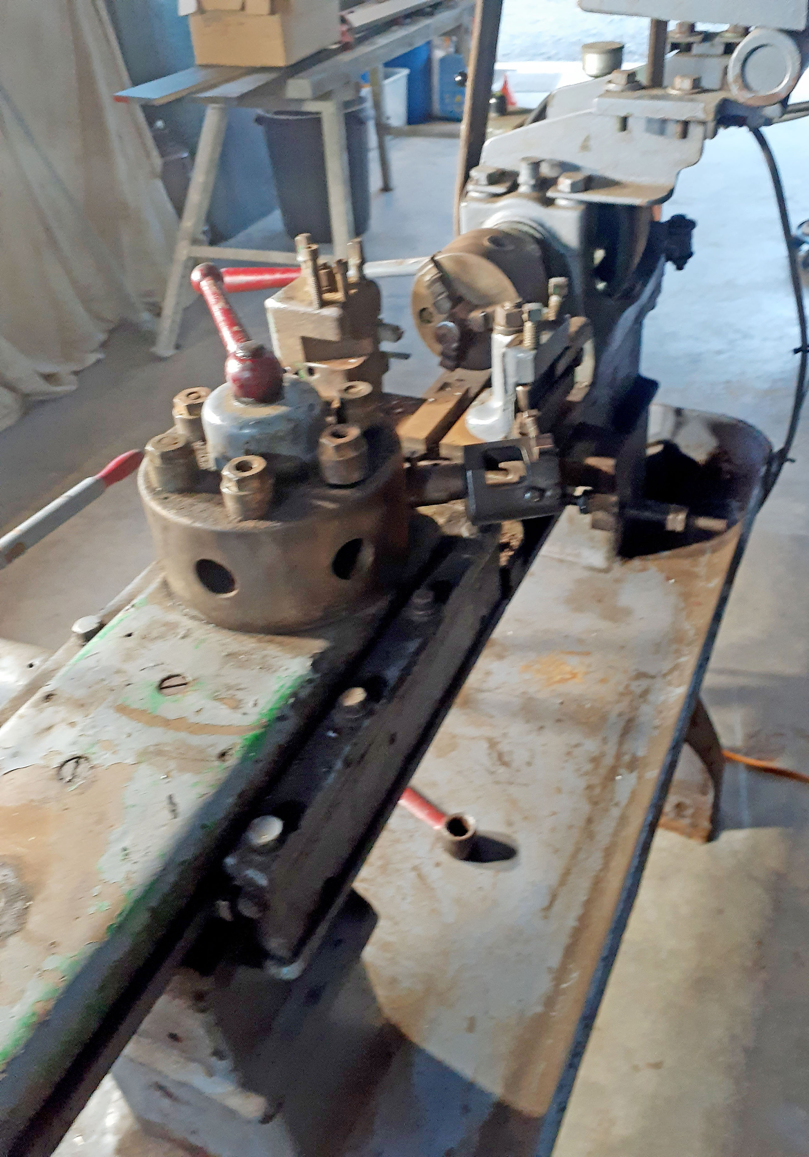

Just three lathes by Richard Lloyd have come to light in recent years with one, discovered in Australia, a simple little hand-controlled carrying cast-in lettering along the front face of the bed proclaiming R.Lloyd & Co Birmingham. Another, by way of contrast, a large and strongly-built flat-belt-driven conventional screwcutting lathe looking to date from the 1930s and fitted with a screwed-on badge. The final example - it came to light in 2023 - is a quite ordinary backgeared and screwcutting type with a centre height of around 6 inches and built circa 1900 to 1920.

The most recent example of a Lloyd lathe to be found is this quite ordinary backgeared and screwcutting type with a centre height of around 6 inches. It is likely to have been built circa 1900 to 1920
Surviving with the lathe--though in badly-neglected condition--is a set of useful accessories including a milling slide, fixed steady, drive dogs and a large faceplate.
