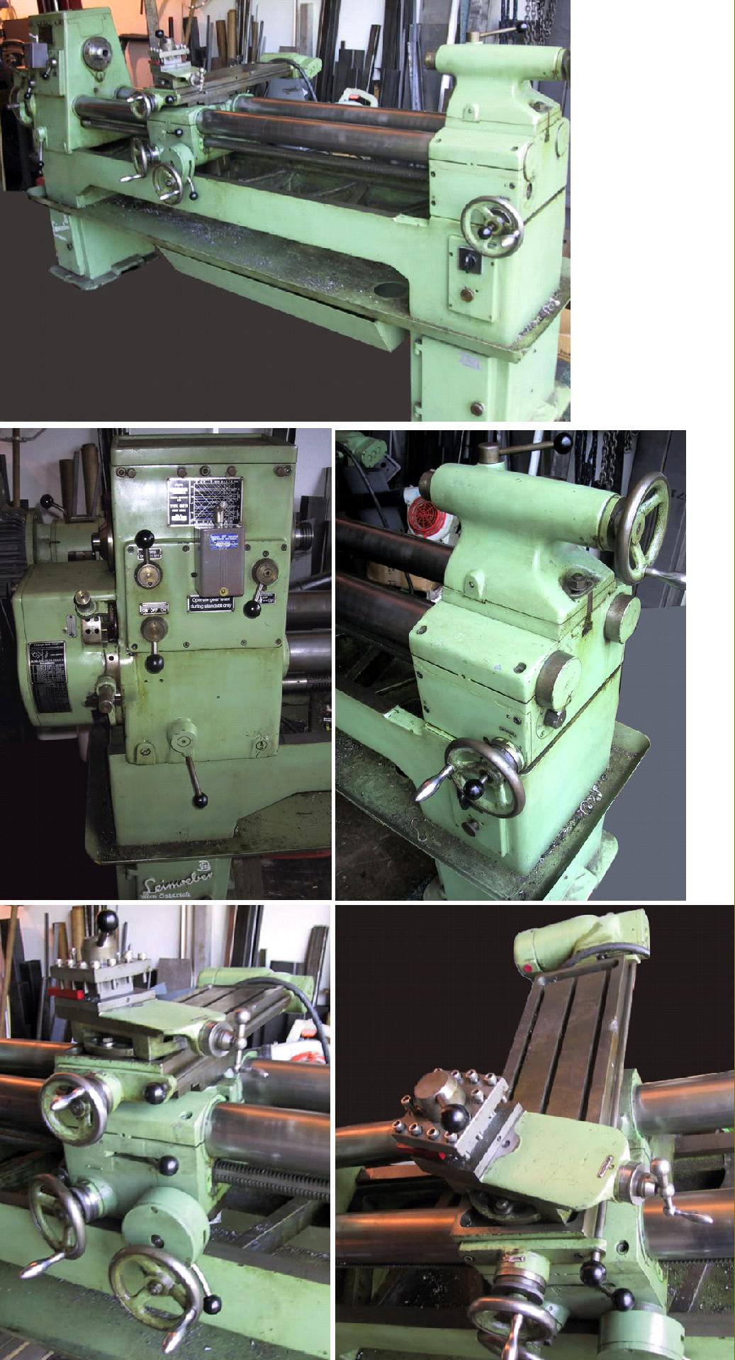

Leinweber UW 21 "Macineshop" Universal Machine Tool:
In this picture the headstock and bed rails have been moved towards the tailstock - the bed rails passing through the tailstock support casting. The bed movement was controlled by worm and wheel gearing, activated by a handwheel on the front face of the lathe immediately below the tailstock.
Carriage assembly. The long "adjusting" slots in the casting on the mid-line of the bed rails are clearly visible. The column supporting the table can be seen rising from the middle of the saddle - it was controlled through a gearing mechanism activated by a single lever positioned on the lower right-hand front face of the apron. Note the use of crude hexagon bolts in the 4-way tool post.
