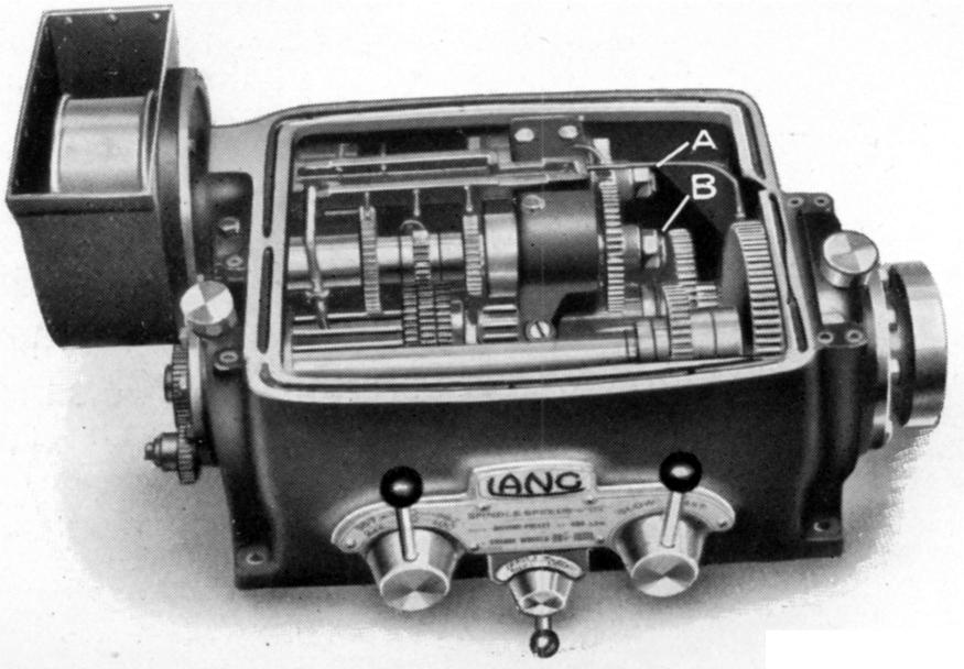

Rather unusually, the headstocks of the 6.5-inch and 8.5-inch models (but not the 10-inch) contained a pair of "pick-off" gears (shown in the illustration below) that, when swapped over, changed the overall speed range - these being shown on a speed plate fastened to the face of the headstock with one range in white digits and the other in red - these being 20 to 400 r.p.m. and 46 to 908 r.p.m.

6.5-inch and 8.5-inch Junior headstock showing the pick-off gears that could be swapped over to give alternative speed ranges

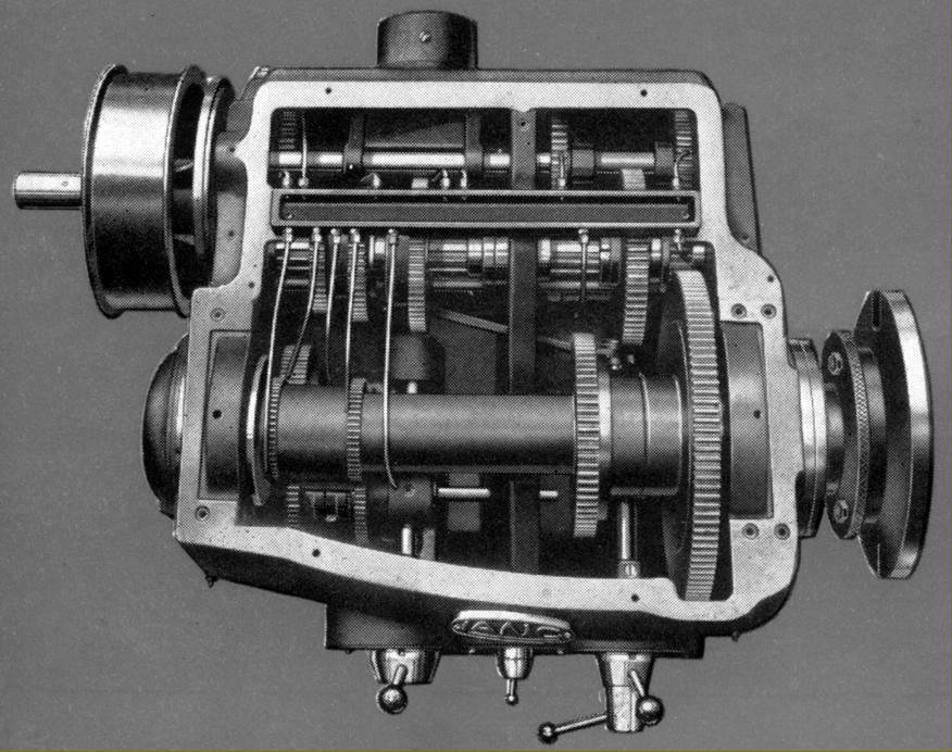

Interior of the Lang Junior 10-inch model headstock
