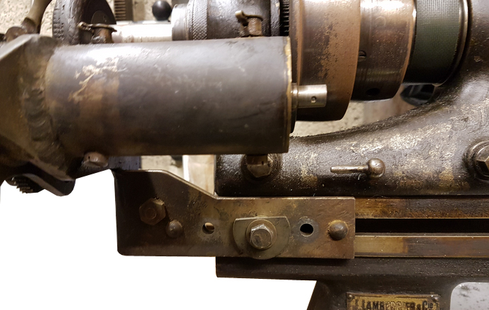

With a full-length T-slot along the front face of the bed, the lathe was designed to accept a screwcutting conversion of the usual kind, i.e. changewheels driving through a universally-jointed and splined (Carden) shaft to the long-travel top slide. Happily, the screwcutting attachment for the lathe shown has been found - though it appears to have either been modified in some way or, possibly, adapted from another make of lathe. However, with the lathe was a paper copy of the English and metric screwcutting chart labelled

Screwcutting attachment--looking as though a previous owner had made some modifications
Evidence of some modifications
