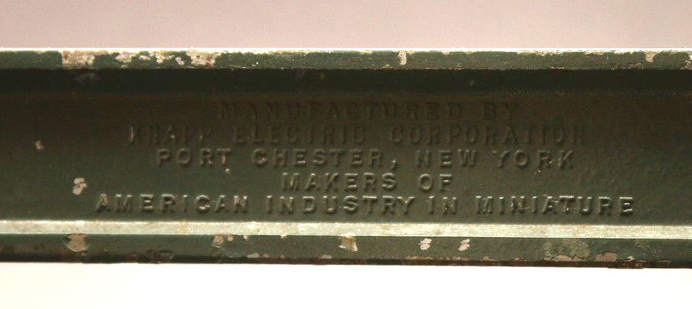

Although the Knapp Company was based first at 47 Warren Street in Manhattan, after several moves they appear to have occupied a new factory in Port Chester, New York, the inscription on the back of the model lathe bed reading: "
Knapp Electric Corporation, Port Chester, New York, Makers of American Industry in Miniature". If you have a complete Knapp miniature workshop the writer would be delighted to have photographs to add to the Machine Tool Archive

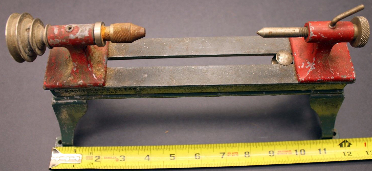

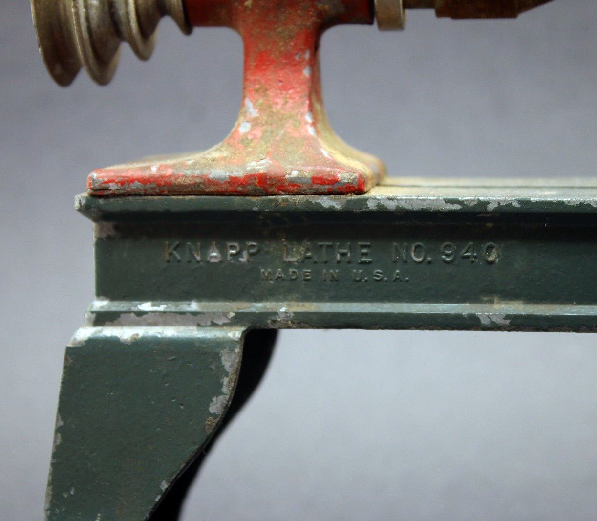

A Knapp lathe, as used in the "American Industry in Miniature" set,  was listed under the Part Number 940. The lathe's overall dimensions were approximately 12 inches long, 3.5 inches wide and 6 inches high. Bed length was 103/8" and the width 17/8"The weight was a little over 3 lbs. This example survives in its original paint - but is missing the hand T-rest (this item too being cast with the  words "American Industry Miniatures. Reg U.S.Patent office
The inscription on the back of the bed reads:
A late Knapp lathe complete with the correct hand T-rest
An early cast-iron Knapp lathe with chain drive
Another early Knapp lathe in cast iron. The open chain-and-sprocket drive could not have been considered a safety hazard

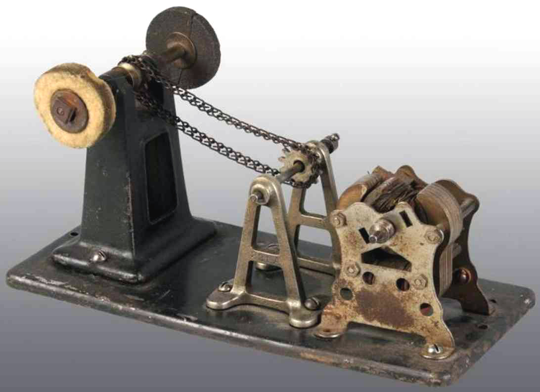

Early cast-iron, floor-standing double-ended grinder/polisher with open chain drive and an intermediate countershaft
