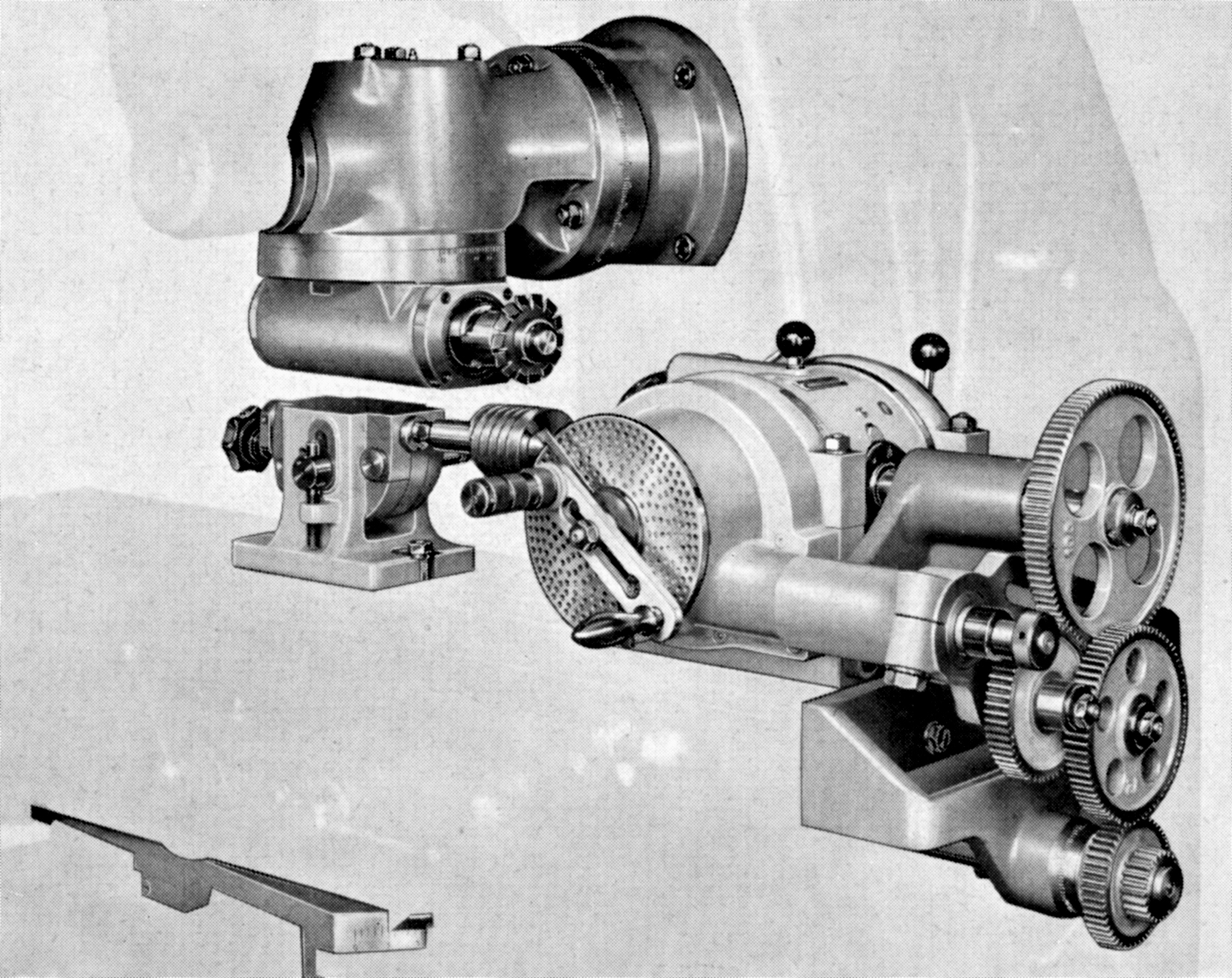

A number of accessories were available including a rather fine, swivel-base machine vice with double-closing parallel jaws and a plain (non-quill feed) vertical milling attachment the Type VFA11 - this mouting against the horizontal apindle socket and having a horizontal throat of 11.75" and vertically of 6.5"; the spindle nose was a 4 Morse taper and the unit weighed approximately 86lbs. Another milling attachement was also offered, the Type VH60, this being of a much more useful design with a handwheel-controlled quill with a travel of 2.5" - though the feed was rapid, by rack-and-pinion gearing there being no fine-feed drive; the horizontal throat was 11.75", the vertical 3.75", the spindle nose a 4 Morse taper and the weight 110lbs. The unit could be swiveled through 360° and was fitted with step-up gearing at a ratio of 1:2 that raised the top speed to around 1920 r.p.m. Also available was a vertical-slotting attachment, the Type S.St.A.1, this having a ramstroke of 3.25", a horizontal throat of 12.5" and a weight of 99lbs. Two dividing attachements were listed: the "semi-universal" Type HU125 complete with an adjustable tailstop, mid-way support, a 24-notch index plate, three dividing plates and a catchplate. The center hight was 5" and the weight approximaely 130lbs. The other division equipment listed was a complex universal, the Type UTA125 with a center hight of 5 inches and a weight of 162 lbs. The unit was intended for mounting on the right-hand end of a table with a set of change wheels connecting it to the table's feed-screw. It was supplied with an adjustable tail stock, a mid-way support, a driver centre, a 24-notch indexing plate, three division plates and the neccecary changwheels, their mounting studs and quadrant. Intended for use with the UTA125 was the universal attachment Type UFA11, this having a horizontal throat of 11.75", a vertical of 6.75" and drive taken from the horizontal spindle with support by a drop-bracket on the end of the standard overarm. Inside the unit the initial horizontal drive was turned through two right angles to end in a 4 Morse taper socket, the whole assembly able to be rotated about its horizontal axis and the cutter head swivelled through 360 °at right-angles to this - the movements allowing (in conjunction with the UTA125) the manufacture of spiral gears, worms and various kinds of milling and other multi-faceted cutters. A single rotary table was listed, the 10-inch diameter Type TRA 250 with a worm-and-wheel ration of 1 : 120 and an attached division plate - its weight was 99 lbs.

Connected to the horizontal spindle socket is the Universal Milling Attachment Type UFA11 and on the table the Complex Universal Dividing Attachment Type UTA125.
