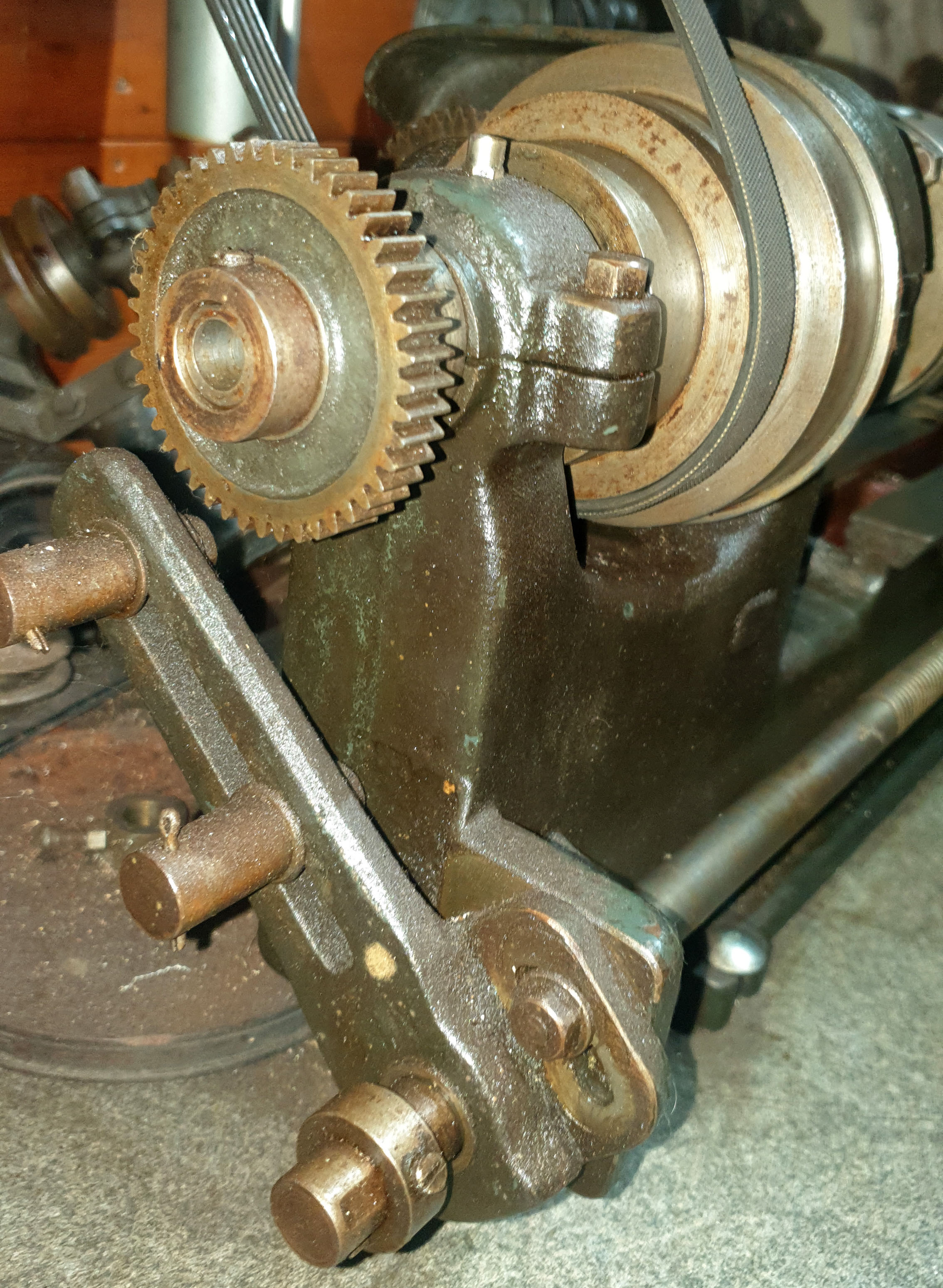

The Kelson lathe, with its distortion-resistant cantilever-style bed cast as-one with the headstock, appears to have incorporated design clues from not only Winfield but also RandA, early and late versions of the Myford ML1 and ML2 - and perhaps a leavening of input from Grayson. Features included the use of tumble-reverse gearing to the leadscrew with a snail-cam lever to engage the clasp nuts; changewheels were of the Myford type being 20 D.P. with a 14.5-degree pressure angle, 3/8" thick (0.375") with a 5/8" bore (0.625") and pins to hold pairs of gears when set-up in a compound train; the No.1 Morse taper headstock spindle ran in simple, plain parallel headstock bearings with each adjusted by a slot closed down by a pinch bolt at the front; a T-slotted cross slide was provided, this being fitted with a simple flat plate to support the outer end of the feed screw end together with a plain-disc, acid-etched micrometer dial.

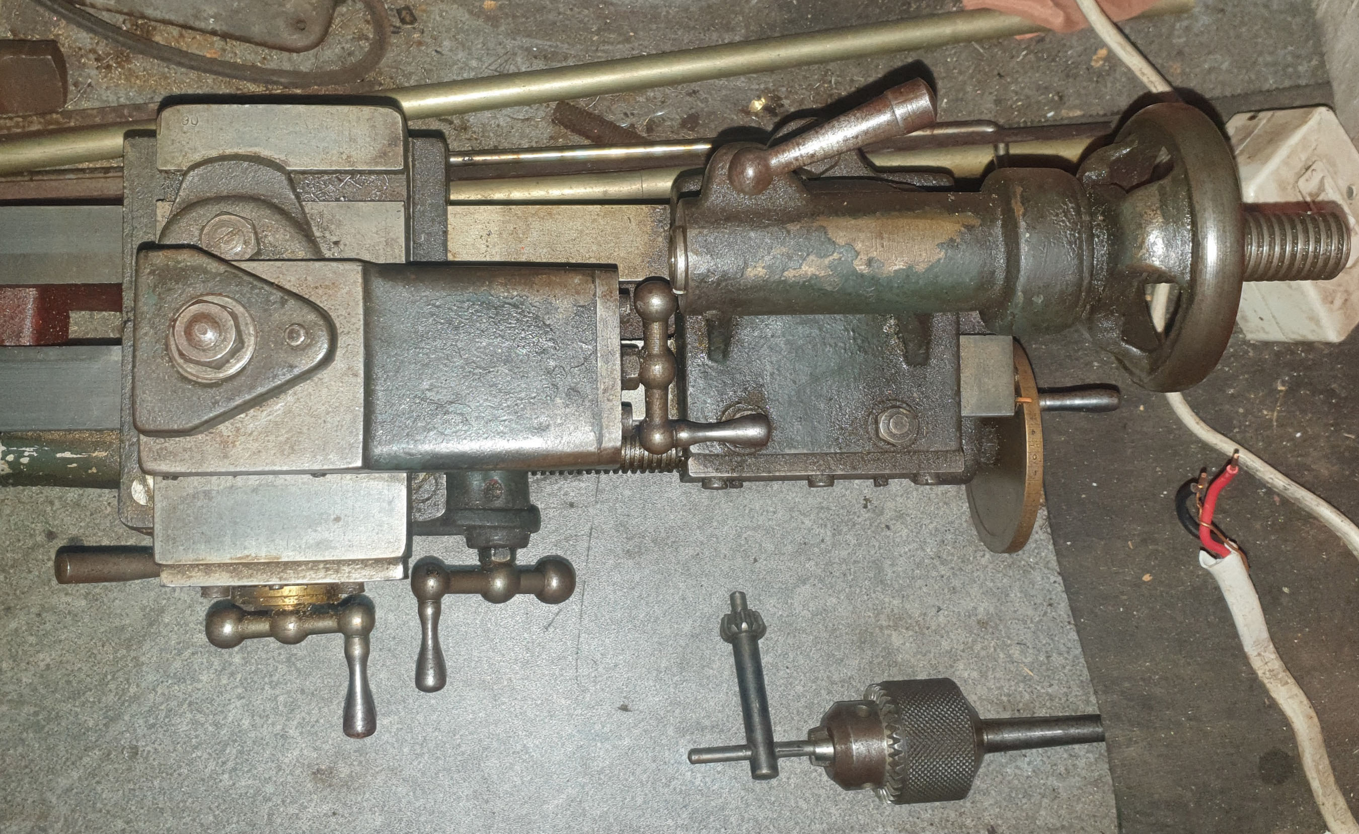

The backgear for slow speeds and screwcutting were clustered just behind the front headstock bearings and the tailstock - so similar in design to many other contemporary small lathes - used a No.1 Morse taper spindle bored clear through and machined with a thread on its external surface. Unlike the original tailstock fitted to the Myford ML1 to ML4 lathes, with their inadequate side support, that on the Kelson was mounted on a much more robust base and, like those on the Myford, able to be set-over for the turning of slight tapers.

The changewheel with the keyway slot is from a Series 7 Myford, the others are matching ones from the Kelson
