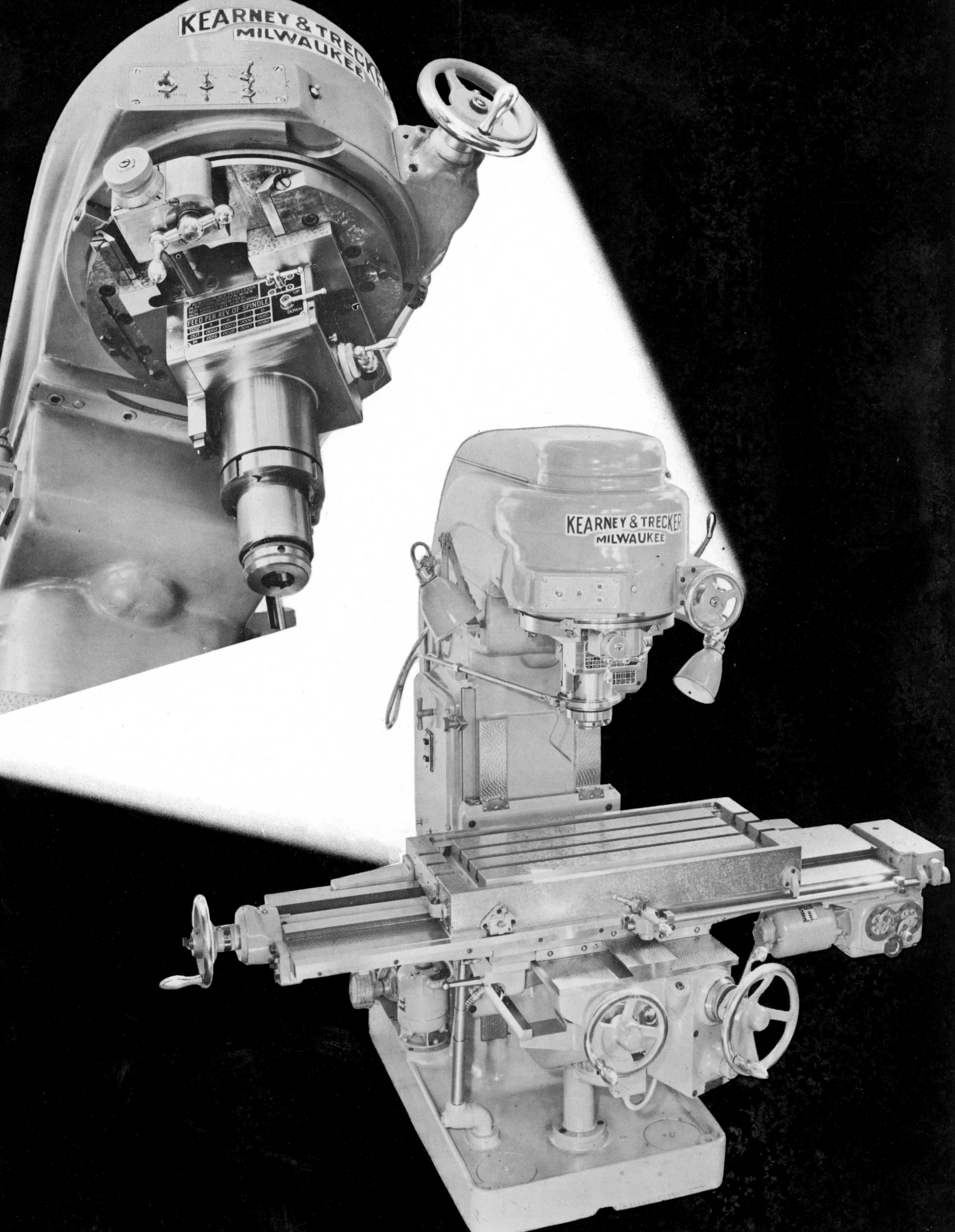

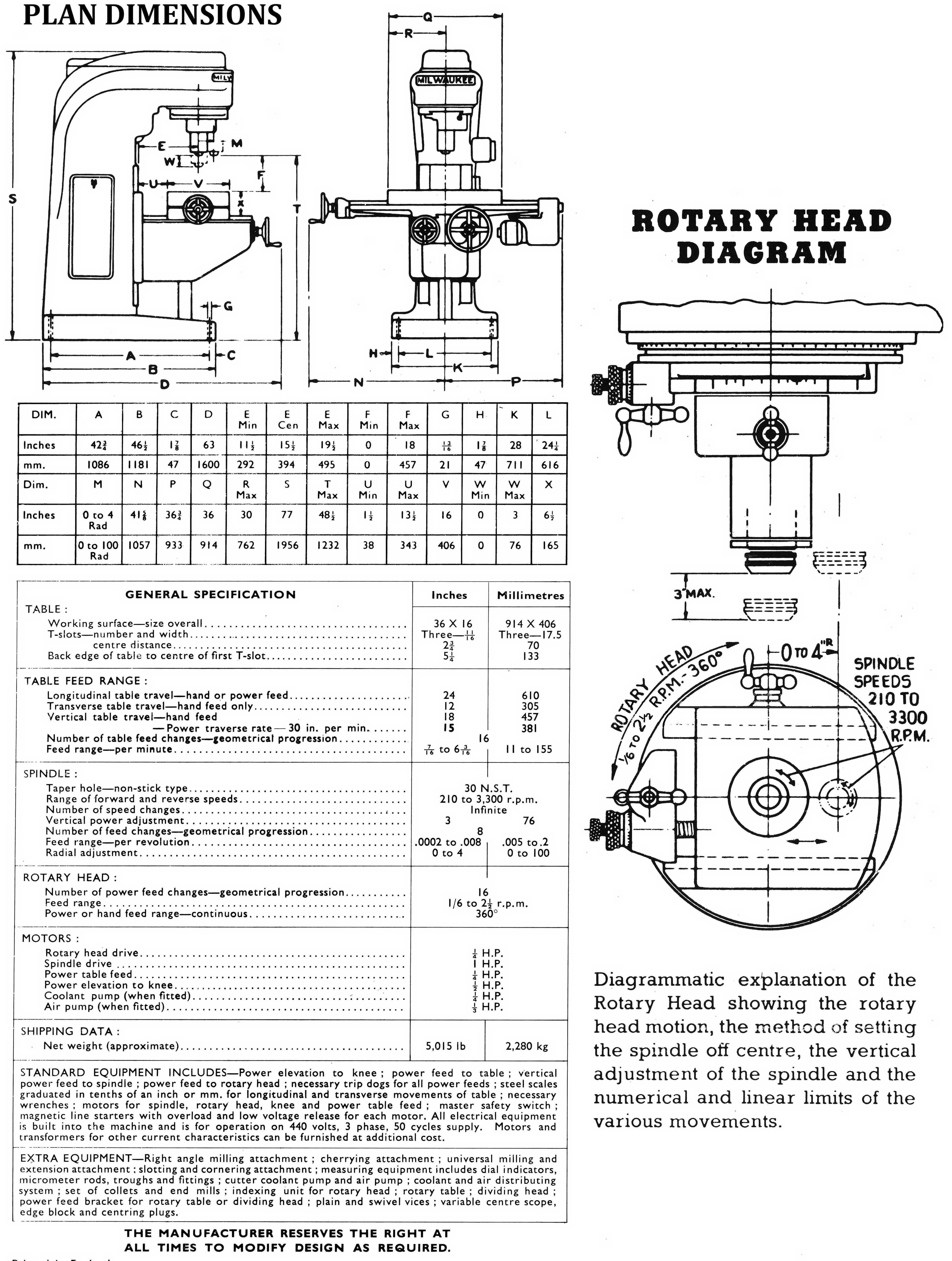

Manufactured in both the United States and England, the Kearney & Trecker Model 2D rotary head milling machine is thought to have been unique in its ability to produce, in metal, the sort of geometric shapes produced by a draftsman using ordinary drafting instruments such as a T square, set square, compass and protractor.
To achieve this, the 2D copied with its longitudinal table travel the horizontal line drawn with a T square; its traverse (in-and-and-out) table travel replicated the line drawn with a set square; the head's unique rotary motion replicated the arcs, radii and circles produced with a protractor and the angular motion of the spindle slide - when combined with the angular setting of the rotary head - copied the lines developed at any angle by a protractor. In addition, K & T offered a cherrying attachment, this acting as an auxiliary rotary head at right angles to the previous plane of operation and so allowing the development of spherical shapes.
