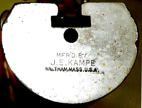

With a 50 mm centre height and a bed 12-inches long, his nickel-plated lathe was of traditional, WW pattern (Webster-Whitcombe) and appears to have broken no new ground with, perhaps, the exception of the collets, these being 9 rather than 10 mm in diameter on their shanks. Although buying-in and re-branding watch lathes was not an uncommon occurrence at the time, in this case the lathe and some of its accessories, including a pump-centre faceplate, were marked as being manufactured by Kampe himself. One wonders what drove him to enter this crowed and somewhat limited market where decent profits would have been hard to come by.
