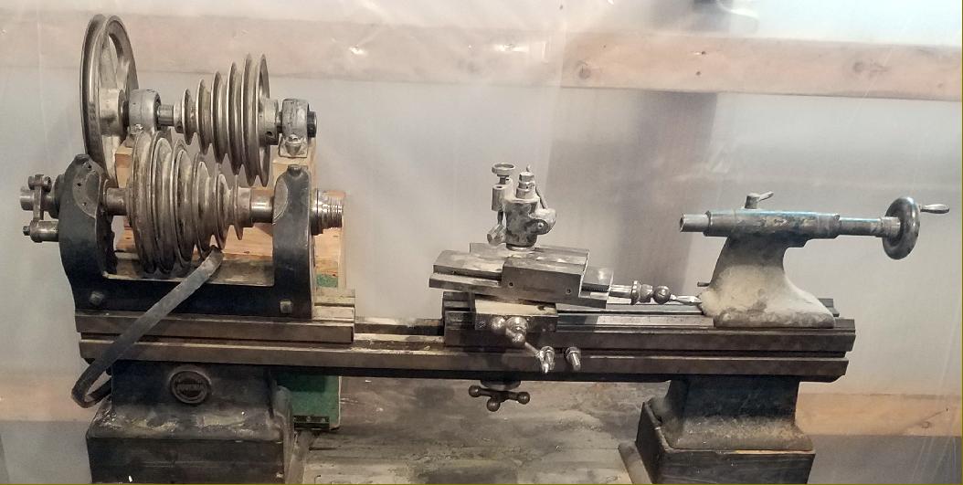

Juvenia precision bench with a 4-step flat-belt cone pulley, chase screwcutting and a screw-feed a compound slide-rest assembly This lathe may have been constructed for production use in a watch and clock factory

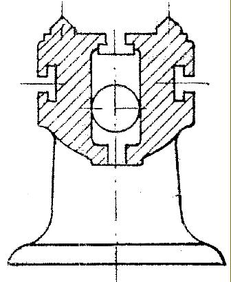

T-slots at the front and back of the bed - a feature of all Juvenia lathes - point to the likelihood that both chase-screwcutting and power-feed to the top slide were on list of available options
