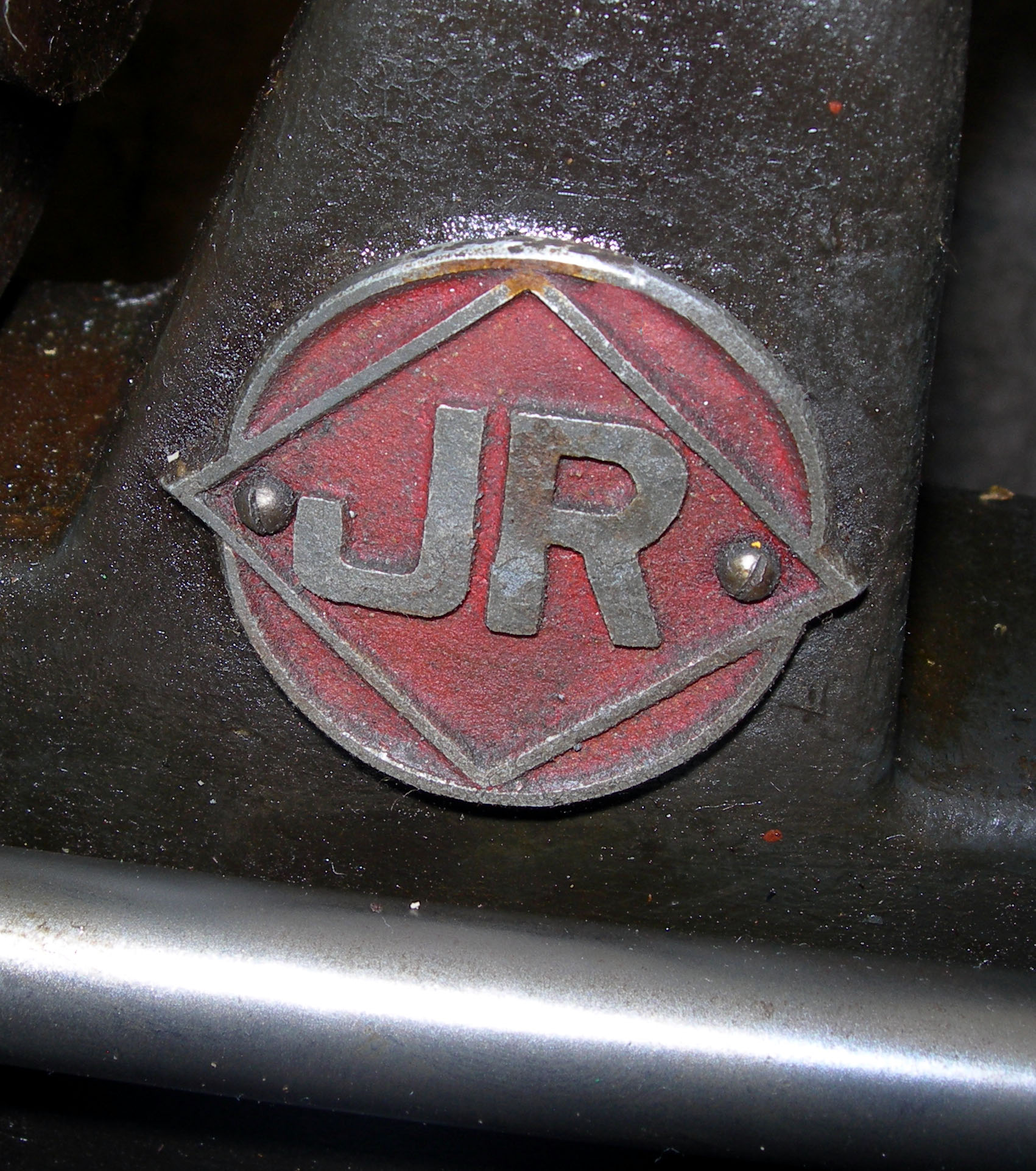

Made by the Jackson-Rigby Company of Shalford, Surrey - established railway engineers who concentrated on parts for miniature steam locomotives - the "JR" is also found badged as the "JRC. Some lathes had these letters cast into the front of the headstock while others had a screwed-on aluminium "JR" badge - presumably on top of the original "JRC" lettering. Production of lathe may have resulted from the company becoming associated, in 1922, with the well-known locomotive designer, Mr. Henry Greenly. Greenly is said to have made some improvements to the original JR design, but the lathe cannot have been manufactured for long, probably only from 1922 until 1926 - the year Jackson-Rigby was sold (or merged) into the Romney, Hythe, and Dymchurch Railway in Kent and just before that company launched its "miniature" main-line steam service from the Cinque Port of Hythe. Much smaller than it appeared (just 26 inches long and 18 deep - the length of the foot pedal - and standing 43 inches high) it was made in 3 and 4-inch centre heights with around 12 inches between centres (the example below is a 3-inch version ) and was especially well-built, with a number of thoughtful and beautifully engineered details. The unusual (and very compact) cast-iron stand resembled that used on many EXE lathes with a flywheel overhung on the left-hand side and a foot pedal, connected to a very heavy crank on the other. Huge individual "JR" letters were cast between the stand uprights - there could be no mistaking who the maker was. Two slower speeds were provided by grooves (to take round 1/4" leather belt) cut near the rim of the 18.5-inch diameter flywheel, while a single, much smaller pulley, was mounted close to the centre for a single high speed that required the use of a separate belt.. Cast as-one with the headstock, the flat-topped, 60-degree edged, cantilever-form bed had a gap as standard - with a faceplate capacity of 8-inches in diameter by 2-inches thick. The design allowed the structure to remain distortion free as it was bolted down (using three closely-spaced bolts under the headstock end) the makers using a wooden tray between the lathe and stand through which the fastenings had to pass. As a finishing touch, the ground top surface of the bed, and the top of the lower tool-slide casting were given a number of decorative scraping marks - though these might also have served to trap a little oil on the surface. Fitted with Hoyt "copper-hardened" split bearings, closed down by slots positioned to the rear, the elegant headstock carried a spindle with the No. 1 Morse taper and a large 3-step cast-iron pulley arranged for drive by a leather 'gut" rope. The bearings were lubricated by wick-feed oilers (so precluding any dirt from entering the assembly) with each protected by a tight-fitting, snap-on cover (when most other small lathes made do with a crude, unprotected hole drilled through the casting). With no backgear fitted (nor any evidence that one could be mounted as an option) the size of the pulley (again, like that on an EXE) would have allowed a reasonably slow bottom speed to be obtained. Continued below:

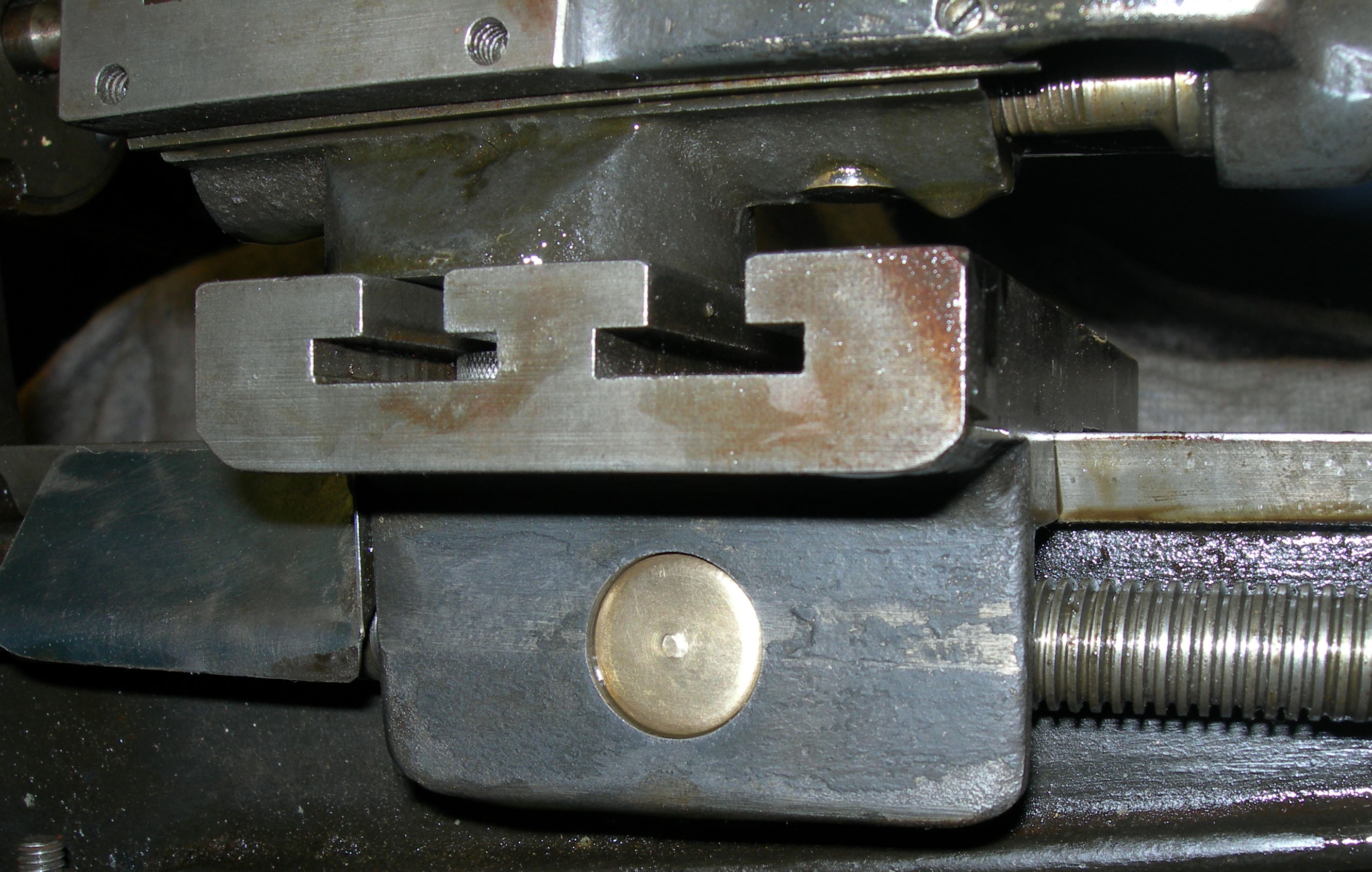

A usefully large boring table was fitted, with three good-sized traverse T-slots, with a single swivelling tool-slide complete with an "American" style "rocking" toolpost and a feed screw (that ran though a bronze nut) fitted with a small but finely-engraved micrometer dial.
The boring table was fitted with three good-sized T-slots

The "JR" badge may have been screwed on top of the original "JRC" cast-in badge
The "JRC" badge cast into the headstock
