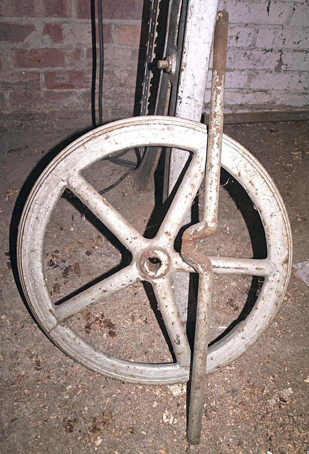

To date just two examples of the Jarratt have been found, one a conventional gap-bed, backgeared and screwcutting model and one of the very simplest, plain-turning type. Both were supplied mounted on cast-iron standards bolted directly to the bed and driven by a rather light, treadle-driven 20.5-inch diameter flywheel assembly.

Supported in two-bolt, cap bearings in bronze, the spindle was threaded on its nose but appears not to have been bored through - though as was common at the time, this feature might have been listed at extra cost. Fitted with a 3-step pulley in cast-iron, power was transmitted to the spindle by a 1/4" diameter round leather belt that wrapped around the rim of the flywheel - a system known colloquially at the time as a "Gut" drive. Although it might seem that the drive system - a foot treadle and round leather belt - would have enabled only the lightest of cuts to be taken, if the cutting tool was kept razor sharp surprising high rates of metal removal could, with care, be obtained.
