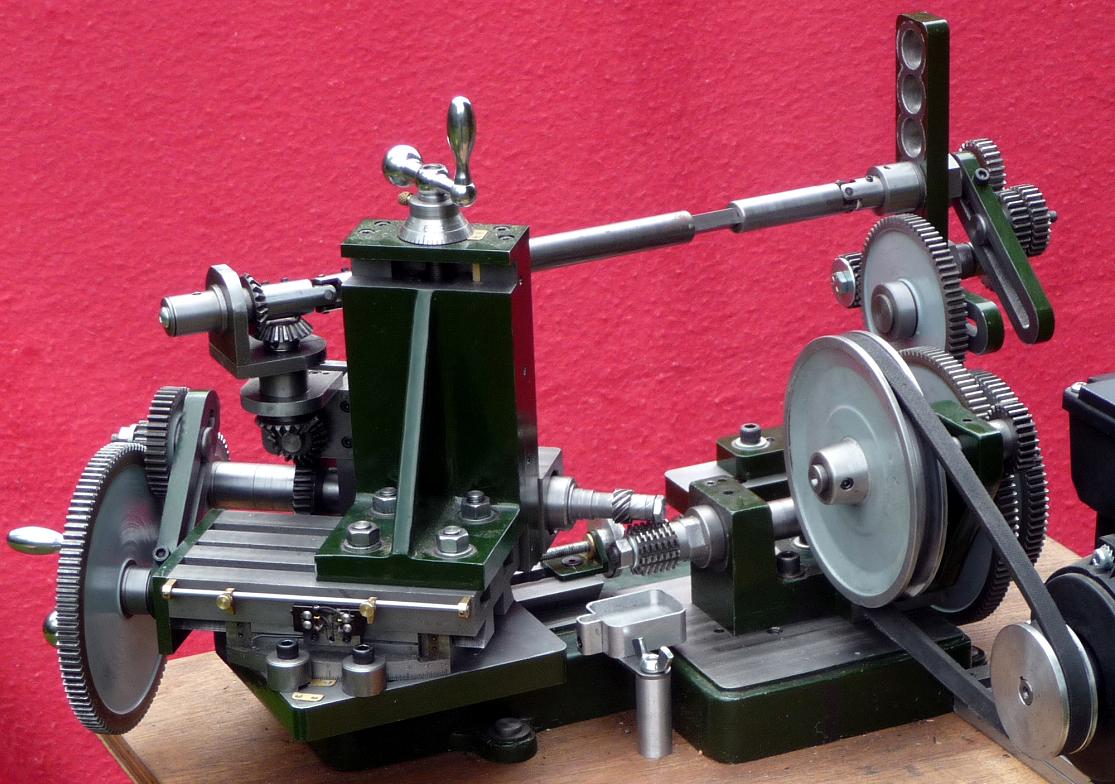

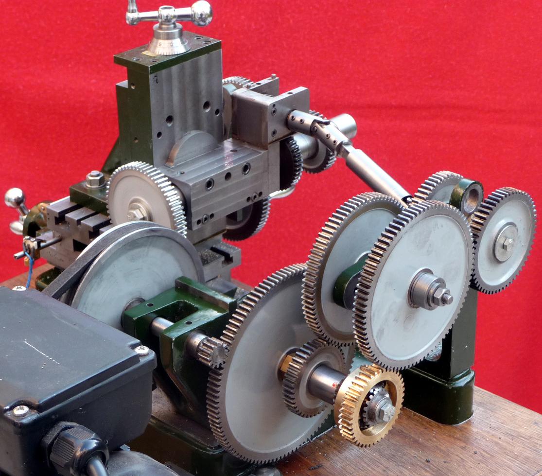

The heart of the Jacobs is a cast-iron baseplate that carries a compound slide rest topped by a vertical slide. Carried on the latter is a housing - able to be adjusted precisely on all three axes - holding a spindle to the end of which is fastened the workpiece. Drive is normally arranged from a remote, fractional h.p. motor with the initial transmission by V-belt to a primary shaft and thence by reduction gearing to the hob spindle. The workpiece rotation is indexed to the hob spindle via a further gear train, a cardan shaft and a worm and wheel (photos 2 & 3).  The gear reduction from workpiece to hob for spur gears must equal the number of teeth of the gear being made - assuming a single start thread on the hob. A powered feed on the cross slide is produced by gearing the cross-feed screw to the workpiece spindle (photo 3) with the depth of cut put on with the vertical slide. To allow gears with a tooth count equal to prime numbers to be cut, a useful addition is a differential gear built, very cleverly, into one of the gears in the index train (photos 4 & 5).
The use of a cardan shaft with two universal joints to transmit the (indexing) drive is a compromise. Since the input and output shafts are not exactly parallel the workpiece movement is not quite at constant velocity, but inclined at an angle equal to the helix angle of the hob. However. when cutting spur gears, since the helix angle of the hobs used is generally no greater than 30, this error is small and acceptable for most model engineering work. Note: the compromise outlined in the last paragraph only applies to the CES design (as shown on this page) when cutting for spur gears - for all other modifications of the type it is eliminated. For helical gears the bevel drive is used and for nearly all worm gears the axis of the wormwheel blank is set 900 to the hob axis.

Photo. 1
The original, unmodified Jacobs gear hobbing machine
Photo. 2
Original CES design for spur gears only. Spindle drive by compounded gears and carden shaft
Photo. 3
Original CES design. A view showing the carden shaft and worm-and-wheel reduction gearing. The arrangement is such that, for spur gears, the gear reduction from workpiece to hob must equal the number of teeth of the gear being made - assuming a single start thread on the hob.
