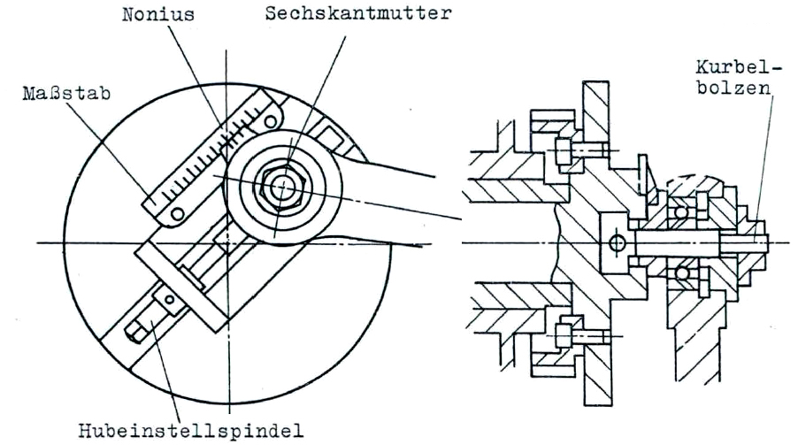

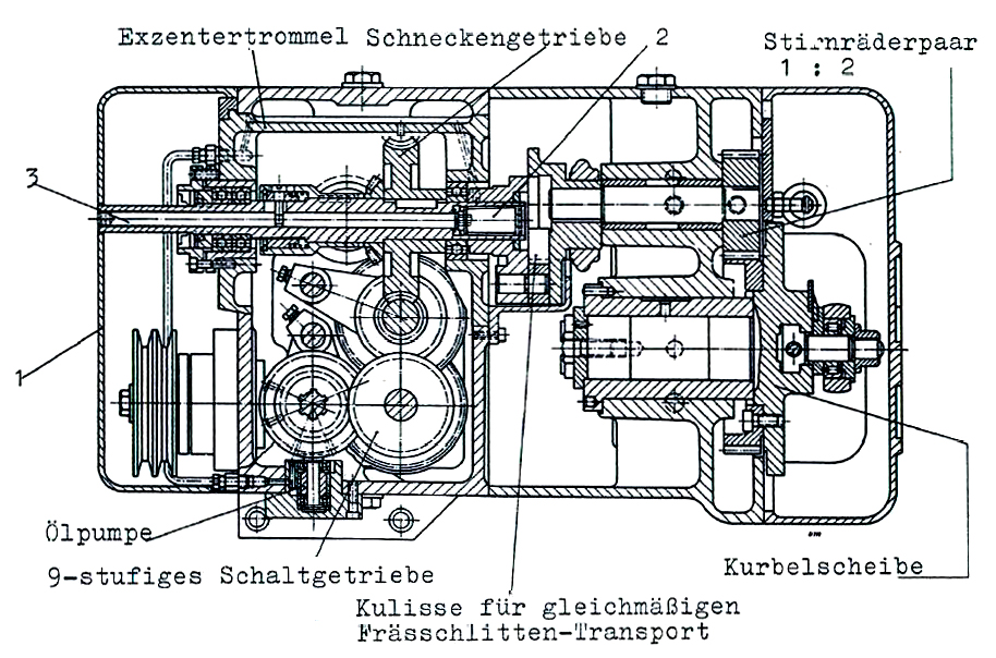

Continued: Mounted to the left-hand side of the head was a crank mechanism that gave nine rates of side-to side-feed over a distance of 5.9" (150 mm) - these traverses being set at rates of 2, 2.8, 4, 5.6, 8, 11.2, 16, 22.4 and 31.5 inches per minute and adjustable to an accuracy of 0.1mm. With combined with power downfeed, this mechanism enabled "gradual-infeed" milling to be accomplished and sloping ramps and other surfaces machined. The drive for the head's side-to-side travel was by a system used on several other Hurst machines (including the Type L.F.V.I. automatic keyseating machine) and described by the makers as, "The well-known and proven Hurst crank mechanism, which guarantees an absolutely smooth and precise reversal." When used for milling and similar operations that required the spindle to be locked, a special non-upsetting clamp was provided that removed any lateral forces on the quill (the element in which the spindle rotated) and so prevented wear on the quill's finely honed guide hole in the head casting. As standard, the spindle end was fitted with a No.40 National Standard taper, though a No.30 was optional and others could be provided to special order. Also part of the regular equipment was a hand-operated, quick-change chuck by Stieber, this allowing boring heads, face mills and other fittings to be changed without recourse to a self-hiding spanner. The maximum distance from the spindle nose to the table was 19.75" (500 mm) and the throat around 10.2" (260 mm). Power came from three 3-phase motors: one of 4 h.p. running at 1400 r.p.m. driving the table; another of 3 h.p. for the head cross-feed and spindle and finally one of 8 h.p. (controlled by a convenient push-button) to lift and lower the very heavy knee and its mounted jobs. Supplied a part of the standard equipment was a complete electrical and coolant installation; a socket from which to run a lamp; the Stieber quick-action spindle chuck; dial indicator for worktable zero adjustment (only in the horizontal plane); a set of spanners and an instruction book. Accessories at extra cost included a 12.375" (315 mm) diameter rotary table, Model RV315, with indexing plates and with a connection that enabled it to be driven from the table's power-feed; the previously mentioned indexing rotary table; a set of collets ¼" to 1" (6 to 26 mm) to holder cotters, etc; a micrometer adjustable boring head, Model AK2, for boring holes up to 4.3" (110 mm) and a universal dial-test indicator designed to fit the AK2; a face milling cutter 110 mm in diameter for machining cast iron with inserted carbide-tipped blades; dial indicators with mounting brackets to carry gauge blocks when working by co-ordinates; a swivel-base machine vice, Model LSt2, with a jaw capacity of 3.9" (100 mm); a self-centring vice, Model LZ3, for holding round work; centre sleeve adaptors Morse 1 to 3 to fir the Stieber chuck; a precision-class drill chuck with a capacity of 25/64th" (10 mm); ; special keyway and slot-milling cutters for use with the downfeed milling feature; an end-mill gauge, Model FPL, for checking cutting edges on the keyway and slot-milling cutters; a set of end mills for jig boring work, Model STS, with Morse taper shanks 5/16 th to 19/16 " (4 to 40 mm) and a machine lamp with a universally-joined arm. The Hurth V10a required a space of 71" x 53" (1800 mm x 1350 mm) and weighed, crated for delivery, 4800 lbs (2200 kg)..

Sectional view of the head's side-to-side drive gearbox, this being was by what the makers claimed to be "The well-known and proven Hurst crank mechanism, which guarantees an absolutely smooth and precise reversal."
Crank-arm assembly showing the feed -rate adjustment system, this working to an accuracy of 0.1mm
