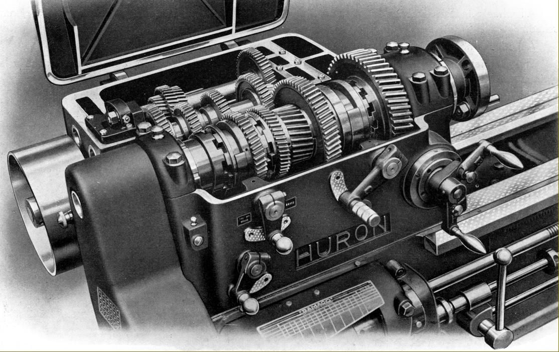

Power was fed into the spiral-gear, splash-lubricated headstock by a 10-inch diameter by 4.5-inch wide flat pulley that (to reduce strains within the gearbox) ran on a set independently-mounted ball races; the input shaft within the headstock was fitted with an all-metal, multi-disc reversing clutch. All the headstock bearings were in bronze (with ring lubricators) and those supporting the  1
5/8" bore spindle were, at 3.125" diameter by 5.125" long, especially large and also adjustable for wear.  Speed changes within the headstock were by a combination of sliding dogs and face-dog equipped gears on the main spindle and sliding gears on two rear-mounted layshafts. The operator selected the chosen spindle speed by the juxtaposition of three levers conveniently mounted on the front face of the headstock; one pair, positioned immediately below and to the left of the front spindle bearing, were arranged to turn on concentric centres the other, above and to the left of the first, was a two-position quadrant arm. A further two levers on the same face provided a means of reversing the leadscrew direction and engaging an 8 : 1 ratio fine-feed mechanism for the leadscrew and power feeds.
Spindle stop, start, neutral and reverse was controlled, on the two lathes with shorter beds, by a single lever at the headstock-end of the lathe working on a full-length control rod; on the two longer-bed lathes the lever was duplicated for safety and convenience by a second pivoting from the right-hand face of the apron. Spindle speeds were rather on the slow side (even for a medium-size lathe of the 1930s) with the early models running in geometrical progression from 10 to 470 rpm and later ones some 50% or more faster at 16 to 710 rpm. The spindle speeds (and feeds, if engaged) worked 40% faster in reverse, so acting as very useful "semi-rapids" return.

Headstock of the Huron lathe with hinge-open cover lifted. The thickness of the wall casting appears to be less than generous.
