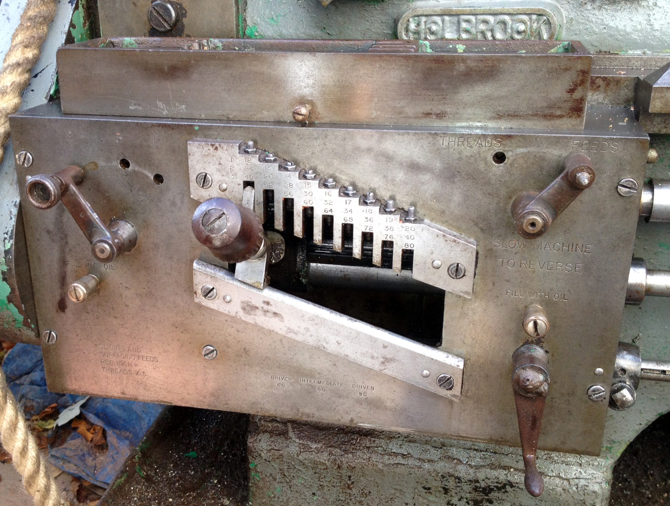

Above and below: the  apron stripped and rebuilt

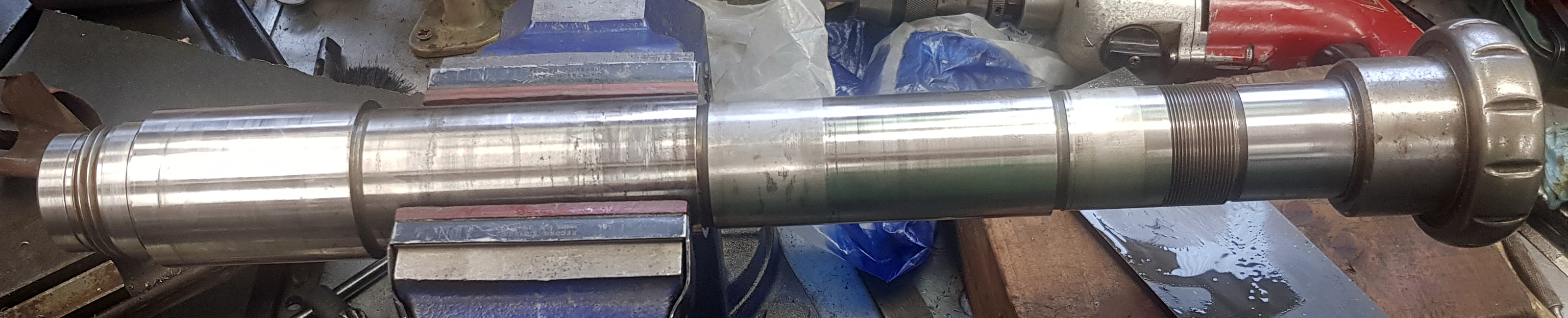

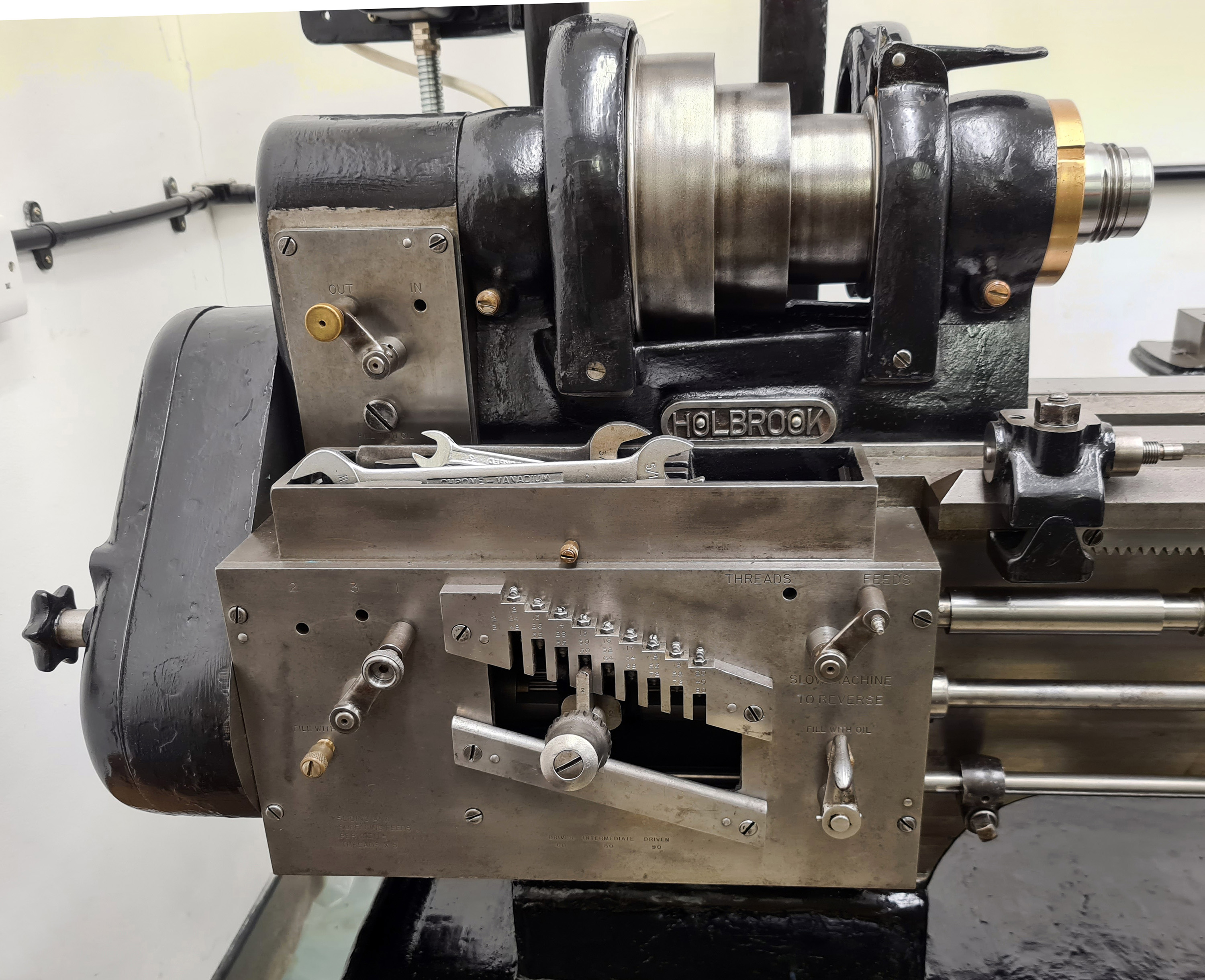

A notable feature of the Holbrook Model B No. 9 was the very heavy and complex countershaft, this being carried on two massive cast-iron uprights bolted to the back of the headstock-end plinth. Inside the countershaft was what may have been the first type of Matrix multi-plate clutch, this ultimately reliable and effective unit being like those commonly found on motorcycles with the driven plates connected to a central splined shaft and the friction plates carrying tabs on their periphery that engaged with the driven drum.
Component parts of the Holbrook countershaft clutch. In the centre of the photograph are the three newly-made steel operating levers, these being "rocked" by the sliding action of a boat-shaped piece
The rebuilt clutch complete ready to be installed
