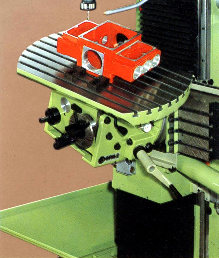

Several types of head were offered over the years including a standard vertical head driven from the horizontal spindle (most found mounted on a very convenient swing-away davit) with some versions having both quick-action drilling and fine feeds and others just the former; a horizontal conversion unit that was bolted in place on the end of the horizontal overarm Interestingly, standard machines were equipped with a special drawbar key which, for safety, had to be returned to its storage pocket before the machine could be started. One essential requirement for success when using this type of milling machine is usually the availability of different tables to mount on the front vertical. However, in the case of the Hermle, the makers incorporated a most sophisticated and robust unit that, as standard, could be swivelled on its vertical axis, tilted 45 degrees left and right from central and nodded 45 degrees front to back. Based on a heavy box casting secured in place by eight T-bolts, the central part could be either a large table with rounded end faces (with tilt and angle movements controlled by handwheels or crank handles) or a dividing unit with interchangeable division plates.

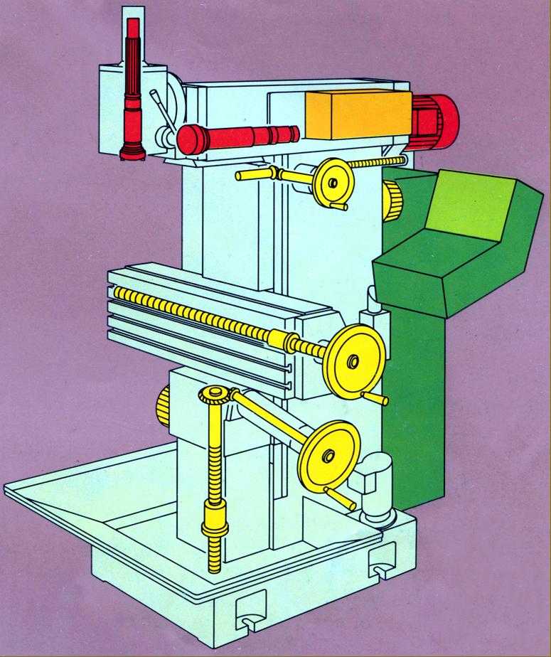

Hermle table and head drives

Hermle universal table with built-in dividing attachment
