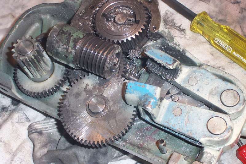

Off comes the saddle. Not quite - the screws on the apron oil cover foul the bed riser at the tailstock end. Undoing the saddle screws let it come out almost, but not quite, enough. I took the top of the saddle off and then the apron just slid off to the right.
I was not a happy lad on seeing the inside of the apron for the first time. I decided to do the saddle first and then the apron. No point in adding to my depression.
Disassembly was pretty straight forward. Most of the work involved scraping paint off the machined surfaces and getting rid of the old grease and swarf. Maybe J&N will be putting some of my money toward buying a degreaser and parts washer? Nah, too much trouble. Just paint it.

The pictures tell more of a story than I can. Remember this work was done by a firm of professional machine reconditioners and the agreed terms were "rebuilt, repainted, assembled and aligned." Next time remind me to buy the pallet of parts and do it myself. After all, I'm "a bloody perfectionist".
See that really short button head screw at the bottom left of the star wheel? IF YOU EVER NEED TO TAKE ONE OFF, REMEMBER THE BLOODY THING IS LEFT HAND THREAD. Mine was well rusted in and painted over, by the time I realised something was wrong I'd torn the head off. I also didn't realise it was only a 3/16" screw - the head suggested it was at least 3/8" and would require appropriate force.
So far I've gone through two rolls of paper towels, two litres of kerosene, several cloth diapers and yes, Tom and Bob, one pair of Y-fronts.
