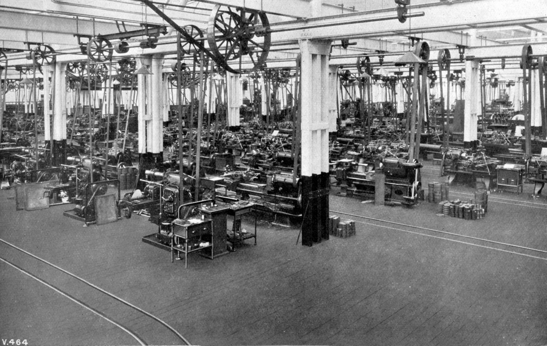

A view of the Edgwick Factory machine shop taken in the mid 1920s. Seemingly just a simple, large room, it was, in fact, carefully organised so that each bay  was identical to its fellows and able - when required - to be converted with minimum loss of time to become an erecting shop complete with cranes. The overhead line shafting  - required at the time as machines fitted with their own electric motors had yet to become standard - was also cleverly engineered. Adjustments to the alignment of drives (to accommodate new machines or rearrange existing ones) could be made by sliding the bearings hangers along longitudinal and traverse sections of channel sections and clamped in place without the need to drill extra holes. As a half-way house to independent machines, in this factory, instead of a large, remote, single electric motor driving everything via the line shafting, individual motors were mounted on the overhead rails and arranged to drive one or more machines
