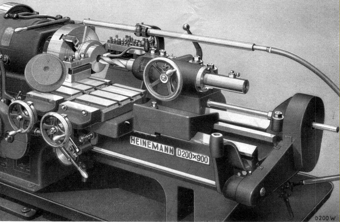

Multi-tool lathe Type D200 x 900 fitted with a special tailstock (Type Bo) for drilling and boring and an automatic cross-feed assembly (Type Pa). The arrangement was intended to allow the lathe to take the place of chucking automatics on heavy work. The picture shows a forged steel cluster-gear 213 mm in diameter and 120 mm long being turned, bored and faced simultaneously in 9.8 minutes.

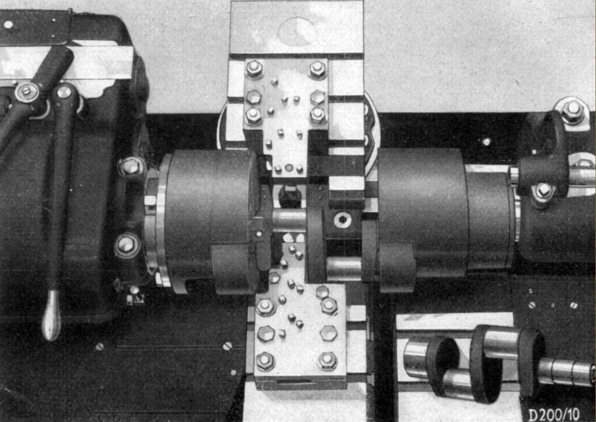

A "pot chuck" and roller steady being used to hold a four-throw crankshaft. Time taken to machine the centre bearing and both ends was 32 minutes
Turning the crankpins of a two-throw crankshaft using a "pot Chuck". The time for roughing and finishing this 50 mm diameter by 65 mm long job was 12 minutes

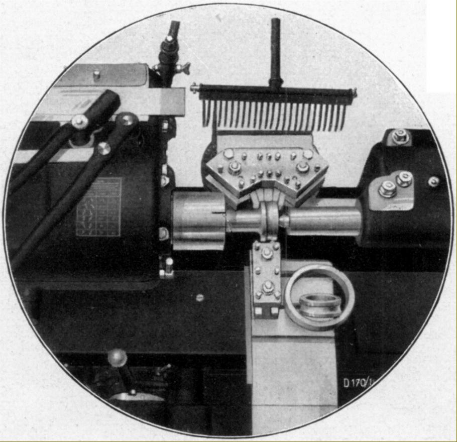

Turning the inner and out rings of a 150 mm diameter 35 mm wide ball bearing. The ring is held on an expanding mandrel actuated by a lever with the longitudinal and cross slides doing the roughing and finishing in one setting: time 1.5 minutes.
