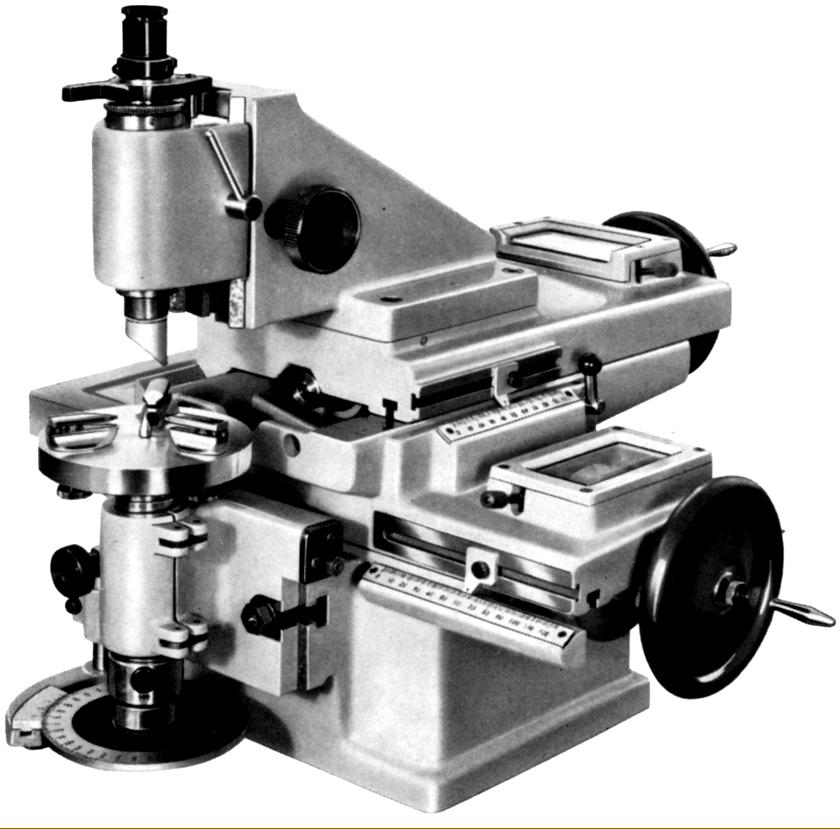

Hauser M1 Jig Borer--shown with spindle microscope in place Based on a design dating back to the early 1900s - and believed to have been originally developed by the Swiss firm SIP - Société Genevoise d'Instruments de Physique - the smallest Hauser jib borer made after WW2 would originally have been called (as a SIP) a "pointing machine" and lacked any form of spindle drive. Originally marketed alongside an even smaller version, the Model 0, the M1 was intended for use in the watch, clock and precision instrument industries, instead of a horizontal table, the M1 was fitted with a vertical, T-slotted 250 x 150 mm (10" x 6") plate formed on the front of the machine's main body to which could be bolted various accessories; these included: an ordinary rectangular, a 250 x 150 mm T-slotted table; a 200 x 132 mm table with a glass insert used exclusively for measuring work (with episcopic illumination combined with the centring microscope or diascopic illumination with either a centring or double-image microscope); a 135 mm diameter rotary table that could read down to 5 seconds of arc; a large swivel support (for measuring screws and worm wheels etc.) and a 135 mm (5.25") diameter table fitted with three radial clamps in the manner of a faceplate from a watchmakers' lathe. The longitudinal table travel was 125 mm (5") with in and out movement limited to 100 mm by a slide that carried the vertical head. Control of table movements was by the usual hardened, aged and ground steel the table feed screws fitted with enormous micrometer drums that turned inside housings viewed through with glass covers. The drums read down to 0.01 mm (0.001") the verniers to 0.001 mm (0.0001" or 1/10,000th of an inch) with external rulers on each axis for coarse settings. The slideway on the end of the horizontal ram could take various fittings including a centring microscope, a double-image microscope and a quickly-detachable spindle housing able to be moved through 40 mm (1.5") of vertical travel under the control of a sensitive lever. Fitted to take Type B8 0.315" (8 mm) collets this spindle was driven by a Hauser-type, flexible shaft with the motor was mounted on a high structure above the spindle. Speeds, which were infinitely variable, ranged from 250 to 2700 r.p.m. Photographs of an M1 here
