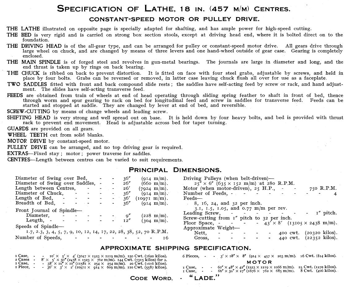

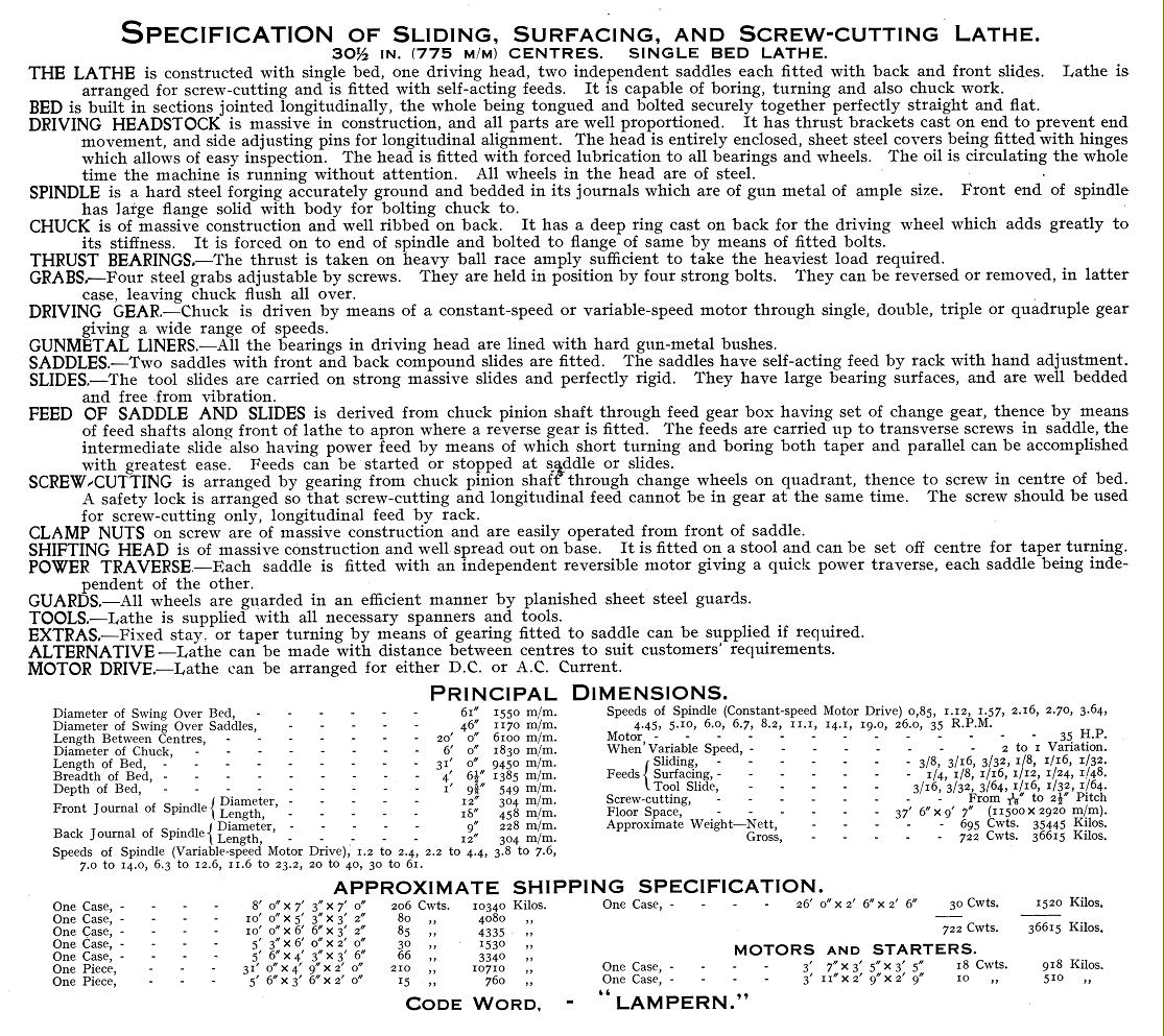

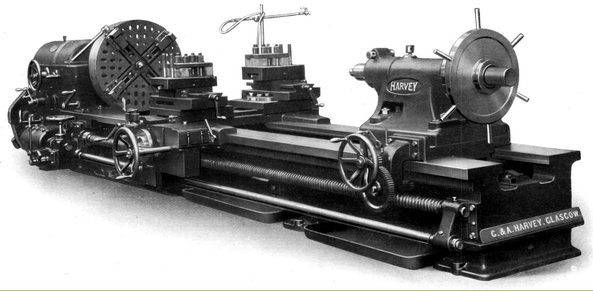

Below is a selection of G. & A. Harvey machine tools as advertised during the late 1920s and early 1930s. Pictures continued on Page 2
