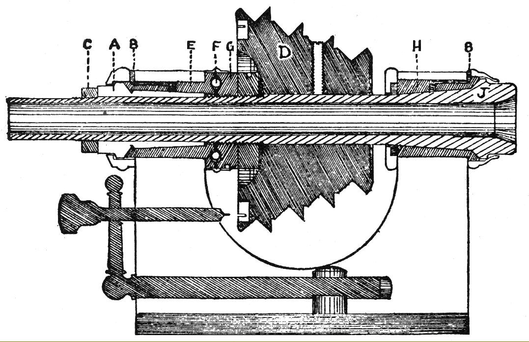

Holding 8 mm collets the headstock spindle ran in adjustable cone bearings - through with the addition of a ball race to take thrust. a 4-step cone pulley was fitted, to take the usual round belt, with a ring of 60 division holes drilled in the outer face of the largest diameter.

Section through the left-hand end of the spindle showing the ball-race thrust bearing
Section through the headstock showing the cone-type, adjustable plain bearings and ball-race thrust assembly
