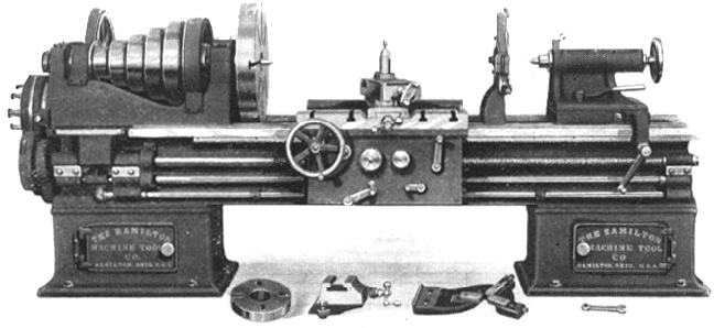

Hamilton screwcutting lathes were produced in two versions that the manufacturers designated as "Style A" and "Style B". The A had an early form of screwcutting gearbox, of a most unusual design, built under licence from Edward Flather whose machine tools were well respected in the latter part of the 19th and early part of the 20th centuries - the Style B used ordinary demountable changewheels.
Carrying a patent date of October 15th, 1901 lathes with the new gearbox were quite unlike any other in use at the time However, Hamilton did not recognise the Flather connection in their advertising, preferring instead to call the device the "
Universal Screwcutting and Feeding Arrangement".  In so far as the drawings indicate, the mechanism consisted of a circular case containing a large ring gear in the form of a short "annulus cylinder" with teeth formed on its inside and outer walls. The inner gear could mesh, one at a time, with eight gears of different sizes arranged around its periphery. The shaft upon which each gear ran protruded through the outside face of the casing allowing the operator to grasp it and so engage and disengage the gears. The outer gear then drove a train of three gears (arranged below and to the side) connected to a reversing bevel box - from where the drive was taken to the leadscrew. Although a very compact design, able to cut 48 different threads from 1 to 56 per inch, contemporary criticism (which was not born out in practice) centred on the fact that, despite being well made from good-quality materials, the reliability and durability of such a mechanism might be questionable. Its complicated method of operation might also, it was claimed, have confused the operator and led to slower work and more mistakes. In the event, the design did not prove a success and the increasingly popular and reliable USA "Norton" quick-change gearbox continued to increase its market share. As a point of interest, the Norton box was not the first of its type, a similar arrangement of gears, of different sizes, placed in a "cone" on a common shaft, having been patented in 1868 by Humphreys. However, the Norton box, helped to class-leading prominence by the Hendey Company who first fitted it to their lathes in 1882, proved to be a long-term success story and it is still used today ijn irs original and modified forms.

26" x 120" Type A with the (Flather patent) Hamilton "Universal Screw Cutting and Feeding Arrangement". The circular gear case, with its protruding selector levers, can be seen at the end of the lathe; the circular casing below it contained the train of gears which drove to the feeds reversing bevel box at the left-hand end of the leadscrew.
36" x 120" screwcutting lathe with changewheels and two types of tool slide - swivelling (shown mounted) and a presumably more rigid "fixed-position" example lying on the floor in line with the faceplate. Note the genuine "triple-geared" headstock with a conventional "backgear" mounted in front of the spindle with a second reduction taken from a point a little way along from its larger gear; a third reduction in ratio was created by the final drive to a gear cut on the inside rim of the faceplate. Some makers claimed "triple-backgear" status for lathes that had only two gear-driven reductions - their argument being that lathes with no backgear at all were often referred to as "single-geared", hence a conventional "single" installation of a backgear should be called double-geared and one with two backgears awarded the status of "triple".
