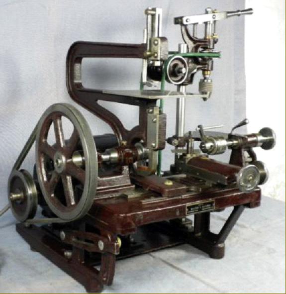

A Guilder Model Builder complete on the maker's base and stand with rear-mounted double-spindle electric motor, leg mounted slow-speed attachment and a 0.25" capacity drill press unit. Note the round Polycord drive belt

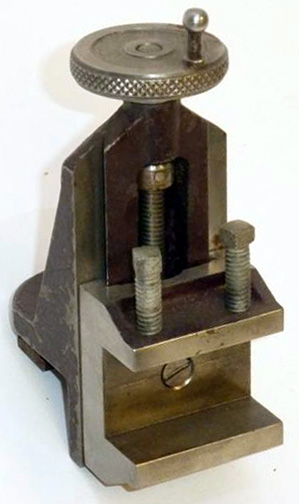

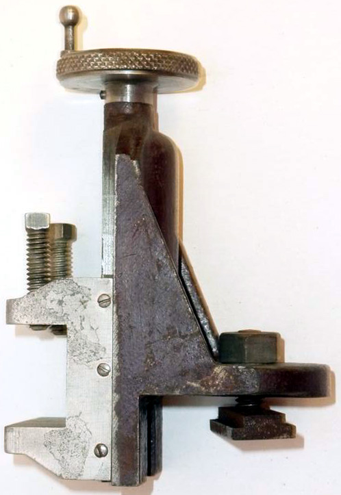

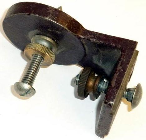

Above and below: a Guilder angle-plate adapter
The neat little Guilder vertical milling slide

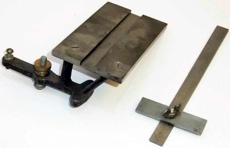

A table and mitre fence for use with a sanding disc

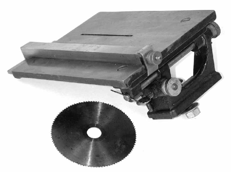

Underside of the saw bench
