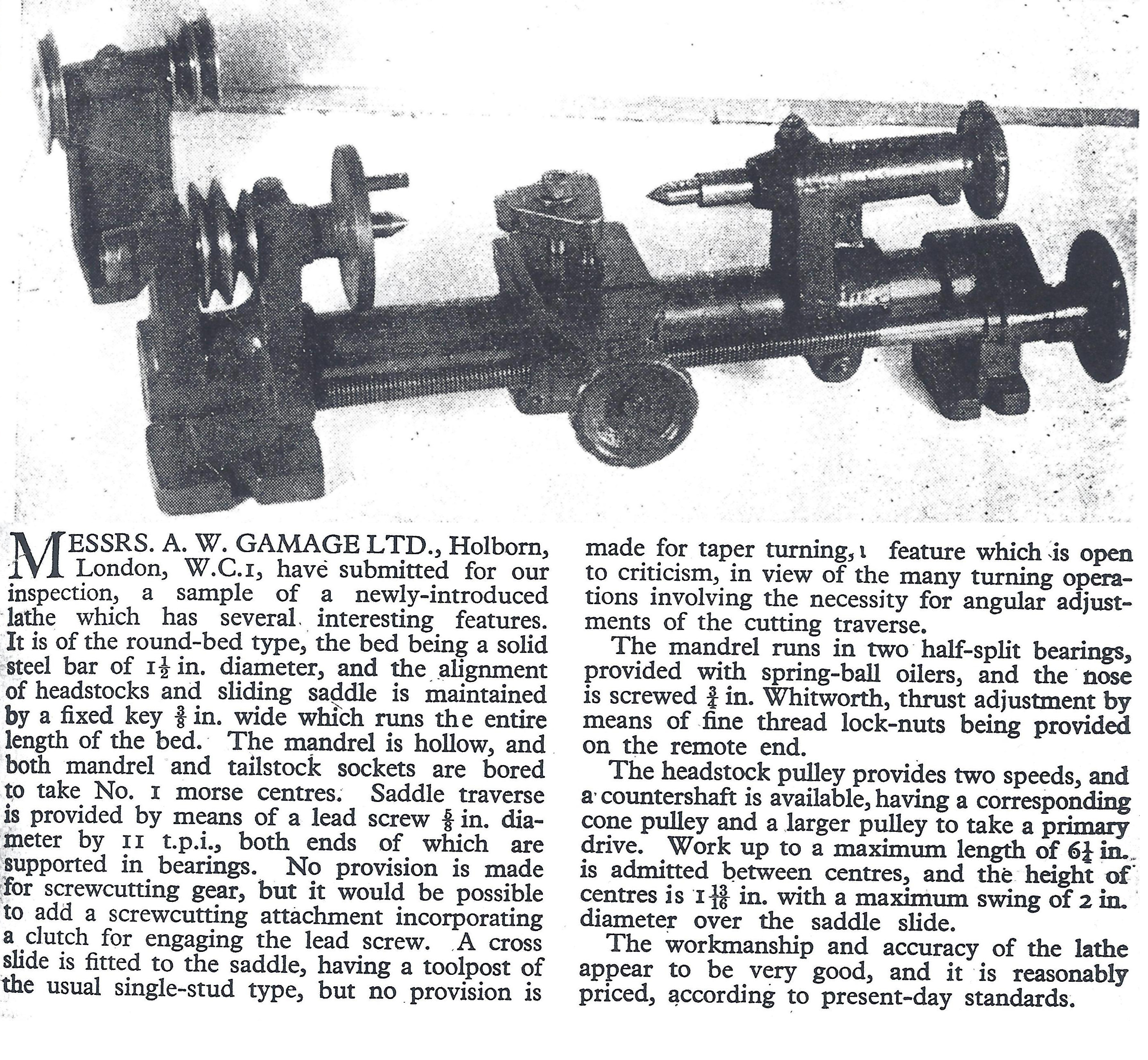

A simple but sturdy plain-turning round-bed lathe with a single, non-swivelling tool slide and lever-action tailstock, the "Greenly" was intended for home construction - and its design has something of a chequered history. Oddly, the was to be found advertised - for a sort time - by the Gamages Department Store in London as part of their range of small lathes - these being more commonly sourced from established makers such as Portass in Sheffield.

Although not backgeared or screwcutting, the design did allow the home builder the comparative luxury of a hand-driven feed along the bed by a leadscrew - unfortunately there was no compound slide rest, nor the ability to swivel the single tool slide to take short taper cuts, this being a serious impediment to casual use.
Greenly intended builders to use their own castings and also expected (rather ambitiously) for them to have the necessary skills to pour,
in situ, white-metal bearings for the headstock and tailstock.  There was almost certainly more than one design of Greenly lathe with another version having a twin-bar bed with the leadscrew running between the rails. The lever-action tailstock design of the lathe shown in the photograph below is, apparently, different to that in the original plans..
Single bar-bed Greenly
