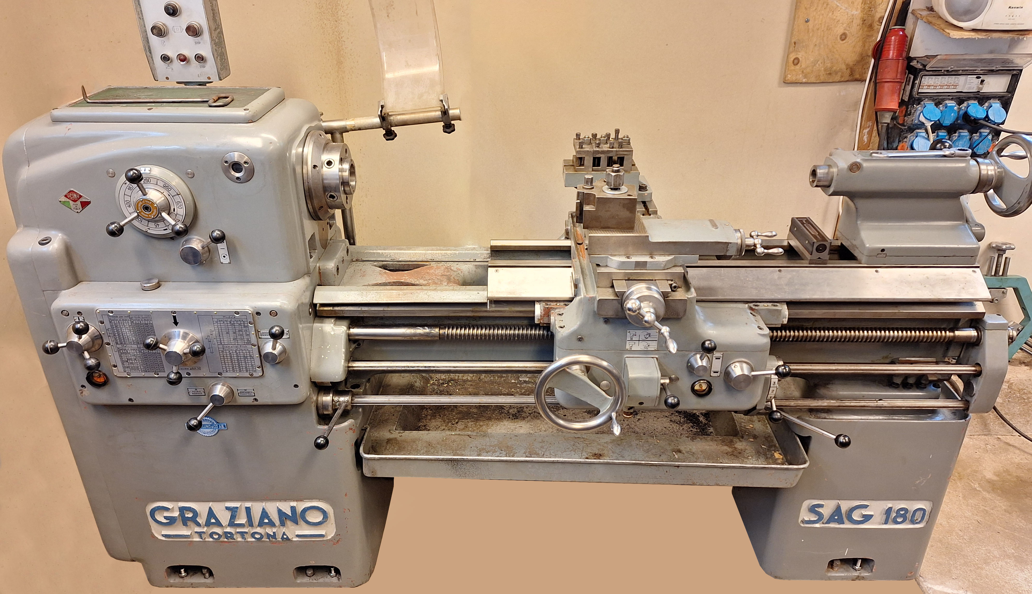

Graziano SAG 180. This is an early model with the bed ways about 268 mm wide compared with 280 mm on a SAG14 lathe

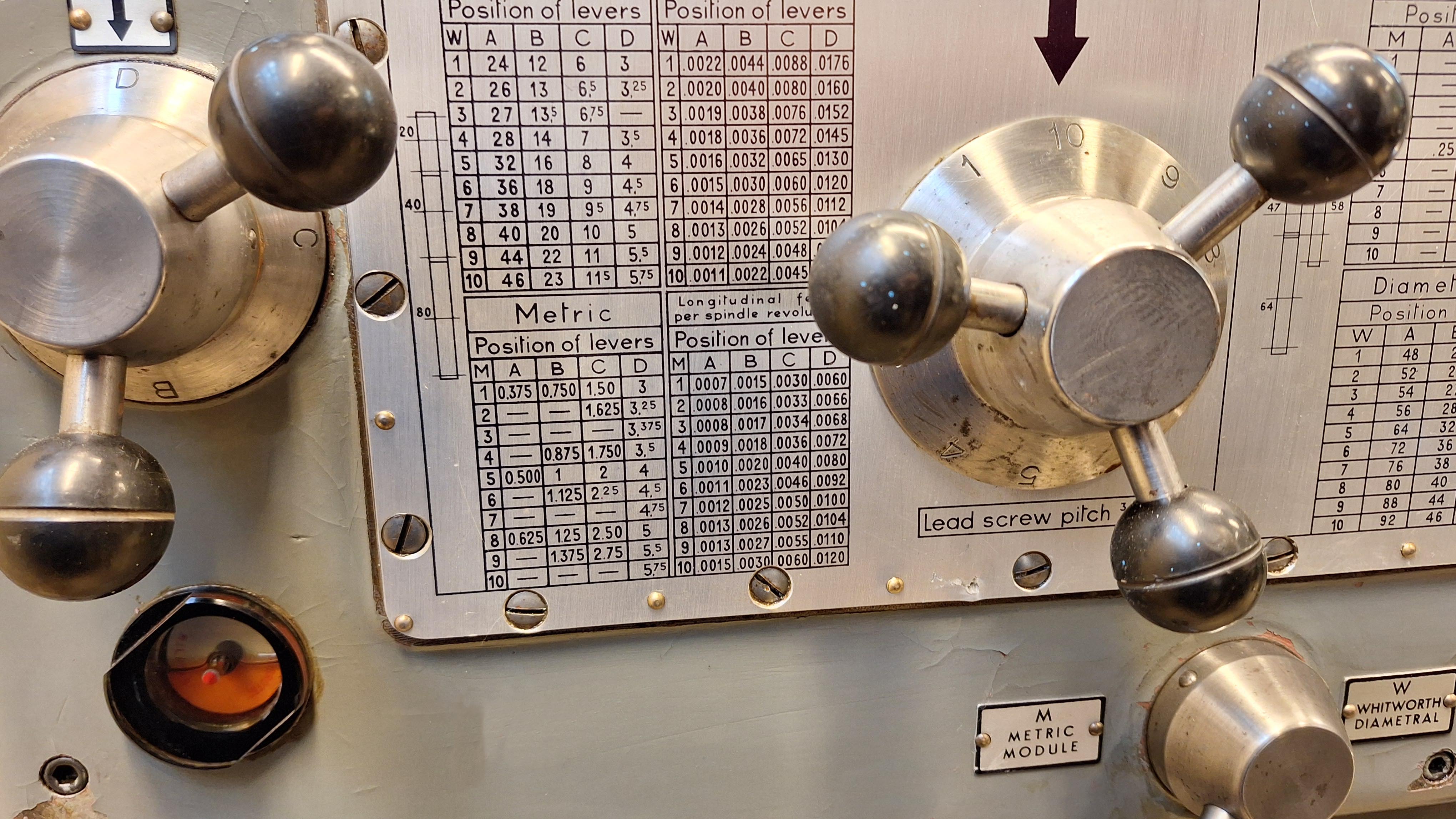

SAG180. Screwcutting and feeds was by a dual metric/inch fully-enclosed, all-lever gearbox (there were no openings to admit swarf or dirt) with initially (as shown), a 3-range A-B-C selection that was later increased to 5-range A-B-C-D-E.
