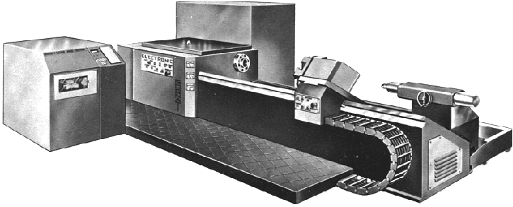

The "Electronica" slant bed was also produced; this had centre heights of 300 or 350 mm (11.8" and 13.8") and a selection of between-centres' capacities ranging from 1000 to 3000 mm (39.4" to 118").
The motor power was 20 - 30 HP and provided constant torque and power all the way from 5 to 1000 rpm. The standard spindle bore was 104 mm - but one to accept 160 mm was also offered. The standard (optional) Numerical Control Unit was a

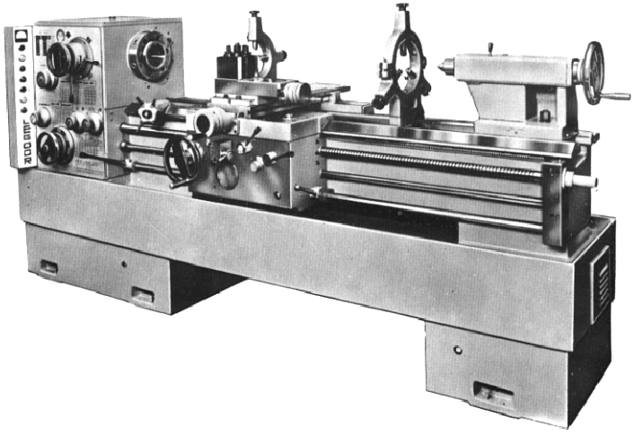

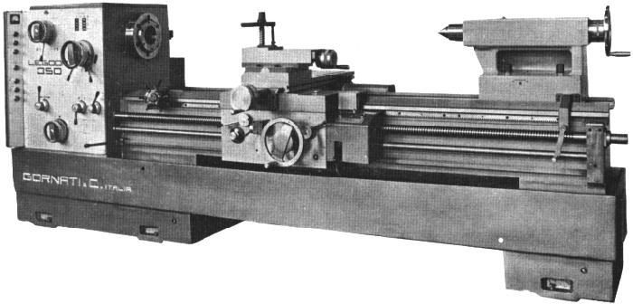

Gornati LEGOOR 230-250

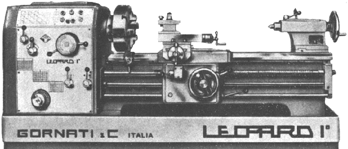

The Gornati Leopard 1 lathe with a centre height of 150 mm (6") and between-centres capacities of 600 to 1500 mm

Gornati "Electronica" slant bed with centre heights of 300 or 350 mm (11.8" and 13.8") and with a selection of between-centres' capacities ranging from 1000 to 3000 mm (39.4" to 118").
The motor power was 20 - 30 HP and provided constant torque and power from 5 to 1000 rpm. The normal spindle bore was 104 mm - but one to accept 160 mm was also offered. The standard (optional) Numerical Control Unit was a two-axis General Electric Mark Century 100S - but others could be fitted to order.
