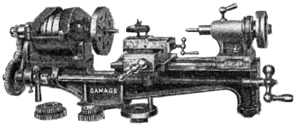

Gamage were a large, London-based department store who also ran a widely-advertised and successful general mail-order business; they flourished until the early 1960s, when their advertisements gradually petered out with the store closing in 1972. Their catalogue (it was very popular in the run-up to Christmas) listed a wide range of appealing items, amongst which were a number of small lathes, some made Portass and (possibly) Flexispeed both in Sheffield, others by the London firm of Ross and Alexander (who also marketed their lathe using the "Randa" brand) and early versions of the Myford ML1 and ML2. The Portass version, illustrated below, was based on the Company's Model S and advertised in the mid 1950s as being available in two centre heights of 3 and 35/8", each with a between-centres capacity of 12.5". The lathe was supplied complete with ten changewheels, a catchplate and a threaded but rough-finished spare backplate. There was no mention in the advertisements of either a countershaft or motor, and these would, no doubt, have added a considerable amount to the advertised price of £27 : 19 : 6d. A smaller lathe by Portass, also badged "Gamages", was based on one of the Company's very early models, the Junior, and also sold with ZYTO markings. However, a very similar (indeed, almost identical) lathe was sold by Flexispeed and, as both companies were within a mile or so of each other in Sheffield, the writer believes that the same pattern maker was responsibe for both. An article explaining the origins and development of early Portass lathes can be found here. Although Portass, Ross & Alexander and Myford are known suppliers to Gamages, it is believed that other makes were also re-branded and, should you have a Gamage lathe of any type, or any literature advertising them (or other machines with Gamage badging, the writer would be pleased to hear from you..

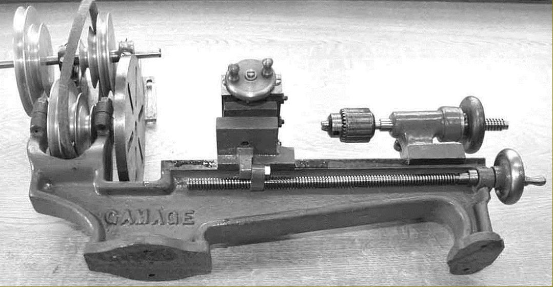

This, the smallest Gamage lathe yet found, was almost certainly a simplified version of the 2.5-inch centre height Portass (or, as explained above, possibly by Flexisepeed) and made from 1927 onwards. Also badged as a Zyto (in a backgeared and screwcutting form) it was also sold - in an identical form - marked as the plain-turning "Junior", though if this version was sold by Portass, or a third-party tool dealer, is not known. Another version, badged Portass, was rather better equipped with a full compound slide rest and a leadscrew supported in bearings at both ends. The Gamages, built down to the lowest price possible, made do with a swivelling top slide and an overhung leadscrew held at the tailstock end only. The tailstock could not be set over, though on one of the Portass versions it could. The model shown here has non-original and larger V-pulleys in place of either the narrow flat or V-type designed to take a round leather rope.

A Gamage's advertisement from 1957 showing a Portass-built lathe
