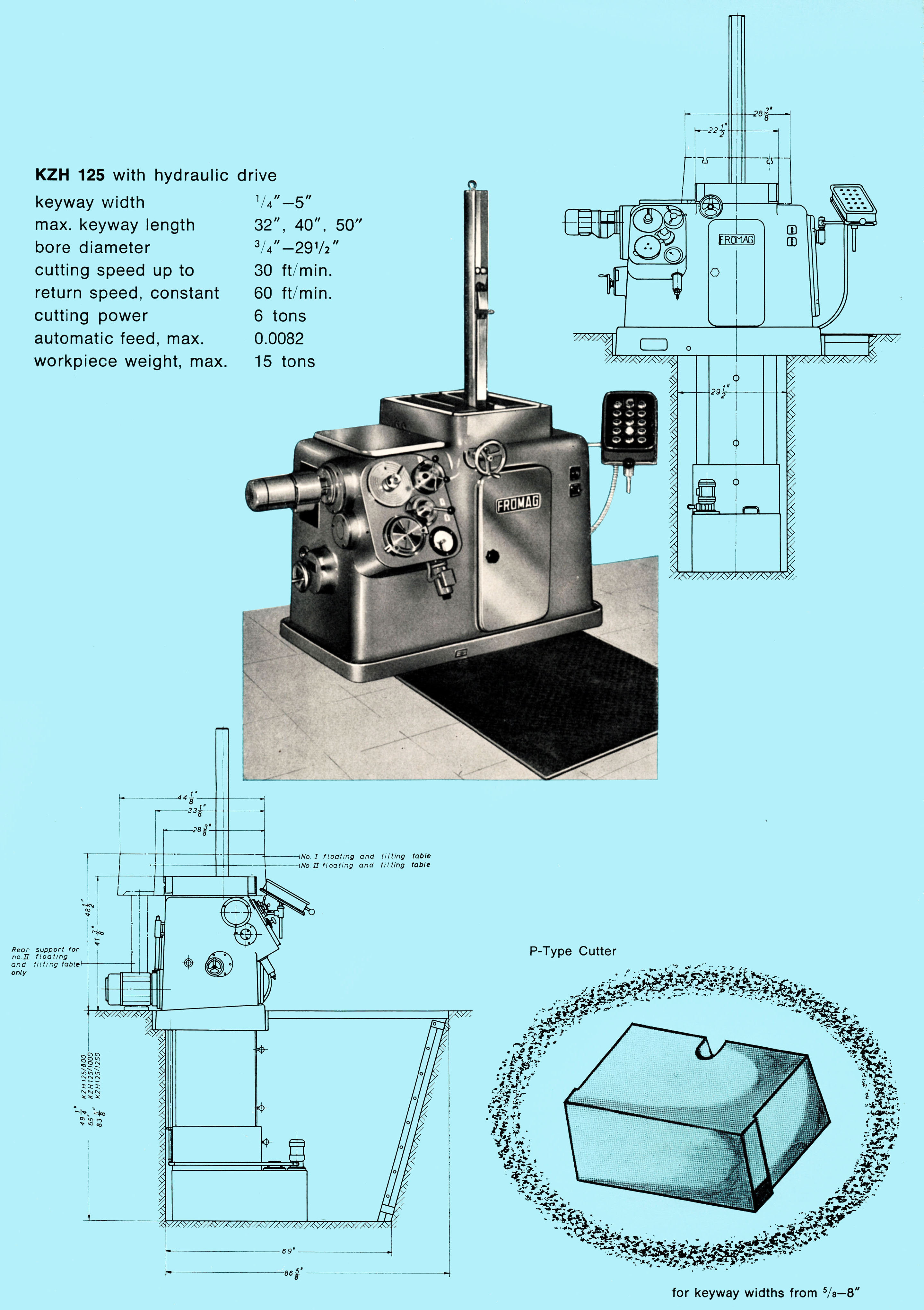

All keyseaters, no matter what their work capacity, are remarkably compact with the two types, mechanical and hydraulic aimed at different markets. While the relatively simple and less-expensive mechanically-driven ones might be employed in an ordinary workshop and used to do one-off jobs or simple production runs, hydraulic models are more suited to continuous production work. Not only do the hydraulics allow the various settings be just "dialled in" to suit different jobs, they are more easily arranged to take "ganged-up" workpieces - a set of pulleys for example, stacked one on top of another - and have the safety feature of automatic cut-out when overloaded. Some, intended for really heavy work, have been advertised as able to mount jobs weighing over 25 tons and cut keyways up to eight inches wide and over 80 inches long.
From the catalogue extracts below, a full picture can be obtained of how typically modern mechanical and hydraulically-operated keyseaters - in this case from the German Frömag range built circa the 1940s to the 1970s - are constructed and operated.
