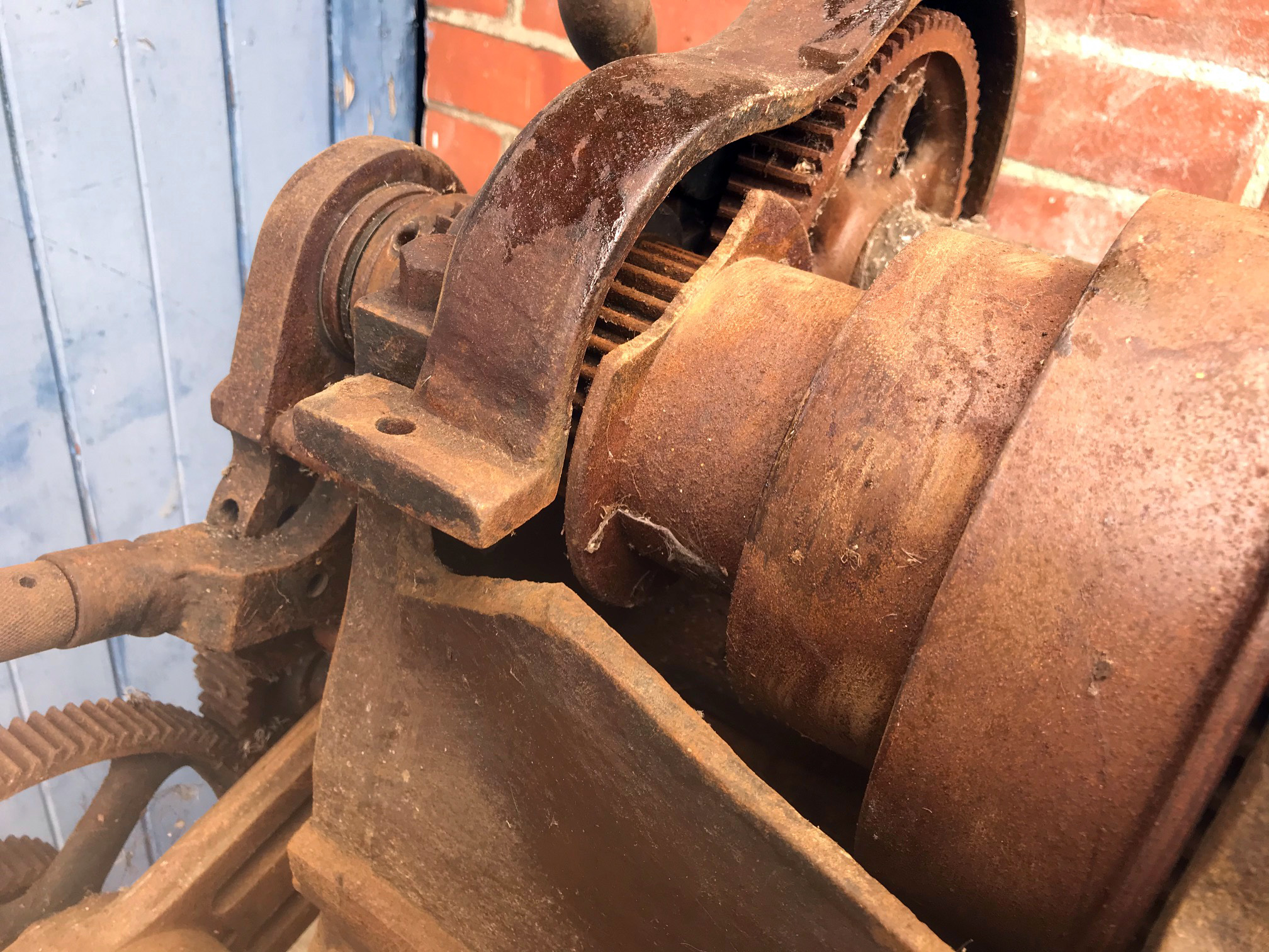

The lathe shown below, similar to one offered for sale in New Zealand in 2020, is of a desgn typical of the period, though the use of a rear-mounted power shaft to provide a power surfacing feed was, even then, a rather old-fashioned practice. Operated by an awkward-to-use crank handle, the manual feed to the carriage was direct to the bed rack, this "high-geared" mechanism resulting in a small movement of the handle producing a disproportionately large travel of the cutting tool. It took an inordinate length of time for lathe designers to recognise that incorporating a step-down gear train on the carriage feed was of enormous assistance to the operator when he need to manipulate a fine feed.
