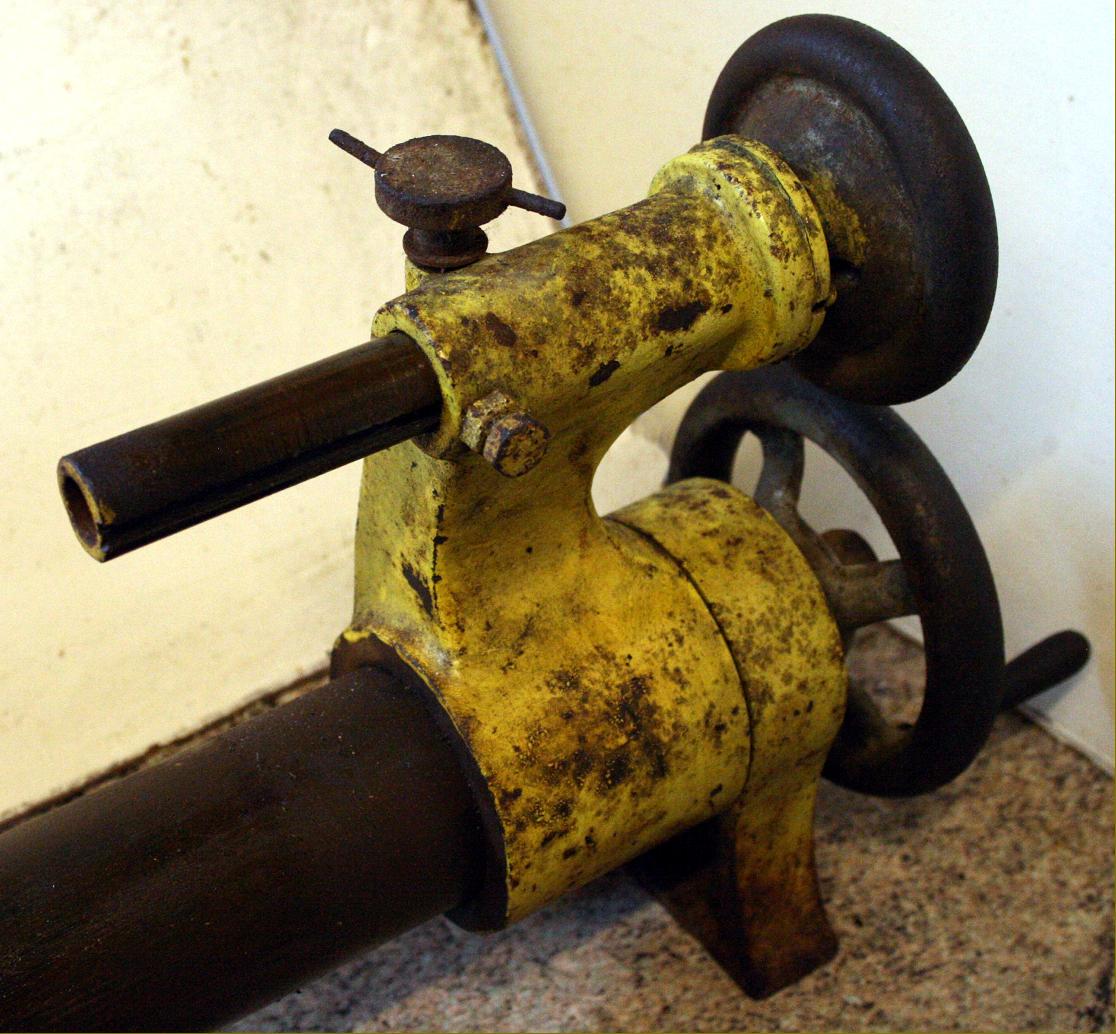

Designed with an asymmetric profile (to allow it to pass the tool-holding top slide in order to support very short, between-centres work), the tailstock had a 3/4-inch (19 mm) diameter spindle with a travel of 2.6 inches (66 mm). A single locking bolt on its underside passed through a slot (allowing the operator some latitude in lining up it with the headstock) and engaged with a tapered nut that was drawn into a slot beneath the centrally located, Whitworth-form leadscrew. One wonders how many examples of the Fogg were completed….
