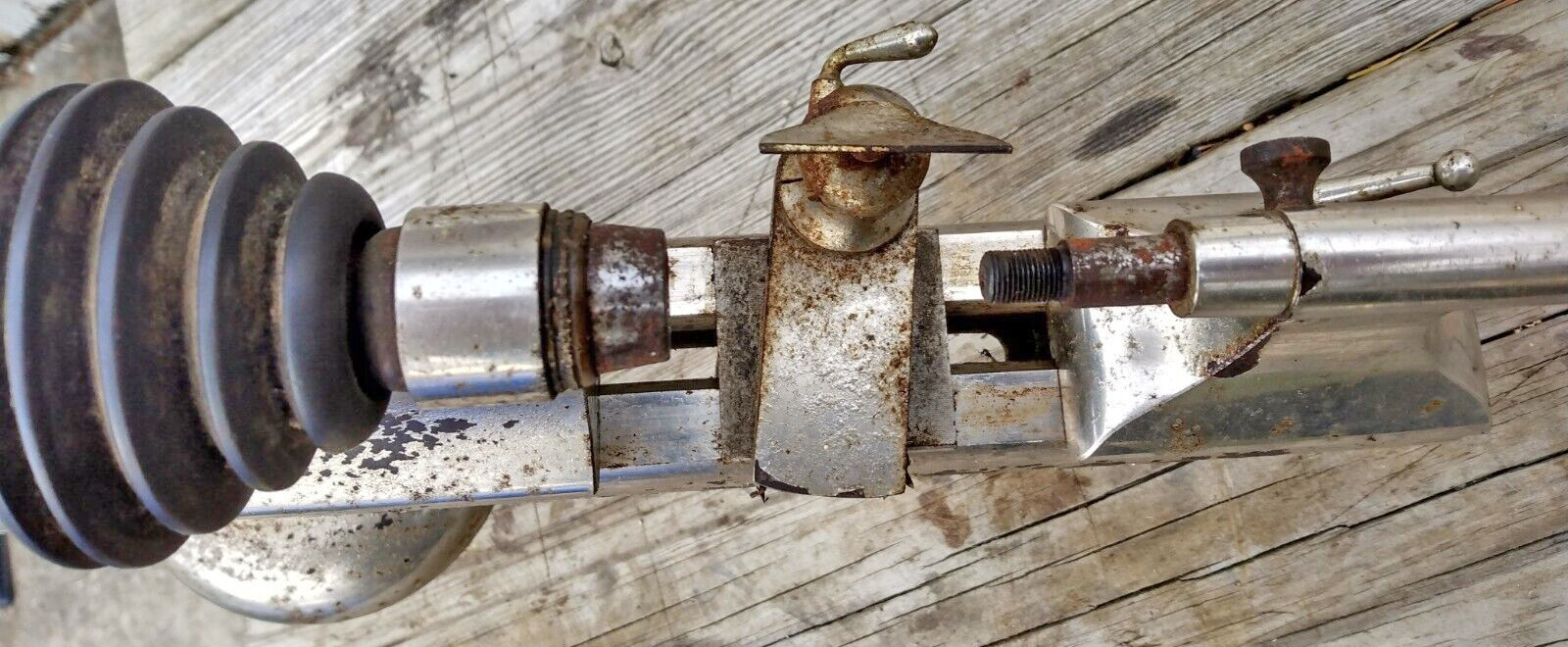

Rarely found stamped Faneuil, the origins of this lathe for watchmakers goes back to 1880 when Edward Rivett, formerly a watchmaker was working for a successful Boston Jeweller and watchmaker C.A.W. Crosby. This partnership developed to the extent that, in 1884, the pair registered the Faneuil Watch Tool Company with Rivett as General Manager and Crosby as Treasurer.
All version of their watch lathe were of the heavy WW (Webster-Whitcomb) type, with a 50 mm (1.968") centre-height lathe; early models appear to have been engraved on the end of their beds with
Faneuil while later ones are usually found stamped Rivett. Having obtained a patent (No. 363,000) on May 17th, 1887 for a watchmaker's lathe, by around 1888, the Company's first much larger precision bench lathe was also in production - as well as a variety of small tools for use by jewellers and watch and instrument makers. Never one to skimp on quality, the financial situation of the Faneuil Watch Tool Company was such that, by 1892 the company it had moved into a much larger factory.
While a common watch lathe might have sold at the time for around $40 - or even less for competition in the field was very strong - the first basic Faneuil, with just a hand T-rest, was $60 or, with a compound screw-feed slide rest, $110. Keen to expand production into other sections of the market, in 1893 the company introduced a lower-cost model, the "
Crosby", at $45 - might this have caused a disagreement between Rivett and Crosby, with the former emphasising quality over quantity while Crosby was, perhaps, more financially astute? Was any of the lathes engraved with the Crosby name? So far not one has emerged.
As far as can be certain, the first Faneuil watchmaker's lathe (the patent drawing is shown below) was the given the model Type 1a2 and made from circa 1887 to the early 1890s. This was followed by the Type 1b, made until around 1895 and, simultaneously, the Types 1C and 2C, this latter being stamped "STEEL" at the headstock end of the bed. In in 2019 a fabulous example of this type was discovered in England, complete, original and mounted on a beautiful roll-top workbench by the J.H.Rosberg Mfg. Co. of Chicago. Introduced close to 1895, the Type 2a lasted until 1901; this was followed by the Type 2b, with a short production run from 1902 to 1905 and finally - until decades later and the Type 1R of 1946 - the almost identical Type 2c that can be recognised by an engraving on the end of its bed stating "
Rivett Lathe Mfg. Co." All these, with more illustrations, can be seen in the Rivett watch lathe section of the Archive
